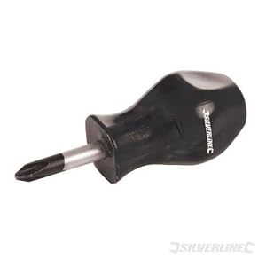

Is there a special tool required. There is not much space between the screw head and the front plastic cowling. Cannot get a normal cross head screwdriver in there.tony.mon wrote:No, after the carbs are in place is easier.

Short Phillips head screwdriver

Thanks Wicky, but it won't fit. I ended up replacing the JIS head screws with hex head where I could get a normal ring spanner onto them from above.Wicky wrote:Short Phillips head screwdriver
