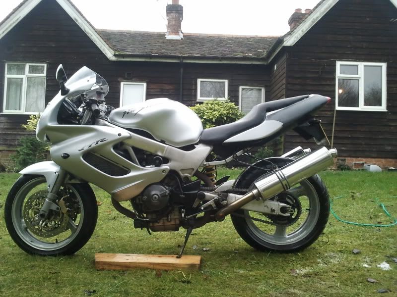

Today I fitted the spacer for the rear shock and cleaned it! :lol:
I also straightened the left exhaust can and notice the twisted subframe! :thumbdown: Out with the scaffold pole soon! :D
