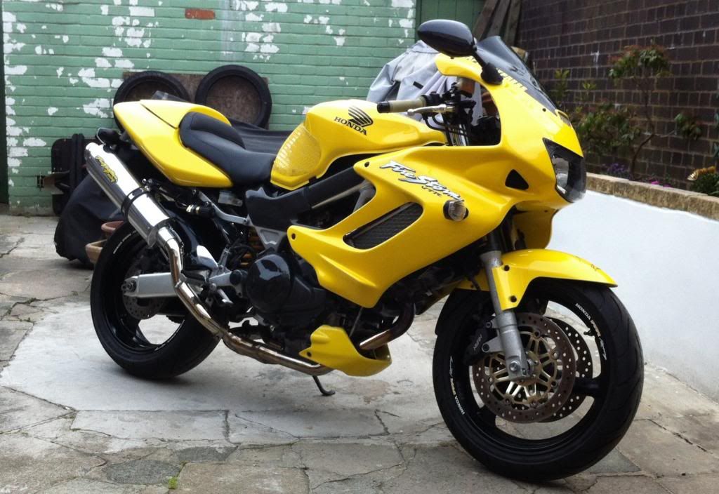

Looks good with that wall as a backdrop. You juts need to remove the clutter in front of the wall. :biggrin
How are the Stomp grips looking. The bottoms of it in the pic looks like you got either bubbles or dirty finger marks on the sticky bit.

trust you to notice, it's a dirty finger mark, I advise anyone whose buying stompgrips, to buy the black ones..... :lol:

agentpineapple wrote:a little more tinkering today, fitted some biketec preload agjusters, I also fitted some stompgrips and a pair of Germany's finest c/f engine covers, touched up a few stonechips.
i'm just waiting on some renthal grip glue for the left clip-on. fingers crossed my secret mod will be ready in time for Saturday.... :shh:
Looking good AP, apart from the finger mark on the Stomp :lol: . Are they storm specific and if so where did you get em :?

universal stompgrips watty......http://www.ebay.co.uk/itm/290757572391? ... 1497.l2649
you have to cut them to fit, a bit nerve racking but mine turned out ok enough, once I decided on the shape, I cut one side and then used that as a template to cut the otherside.
I was uming and arghing whether to use them, but after a short ride on Jamie's bike(which has stompgrips) I knew it was time to get some... :thumbup:
mav, I've heard that will work, but the glues only a fiver, so I thought i'd use it... :thumbup:
