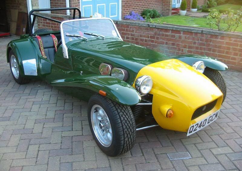

I used to own this a few years ago,and a few others prior to that. Tuned blade engine, IRS, Nitron shocks.
