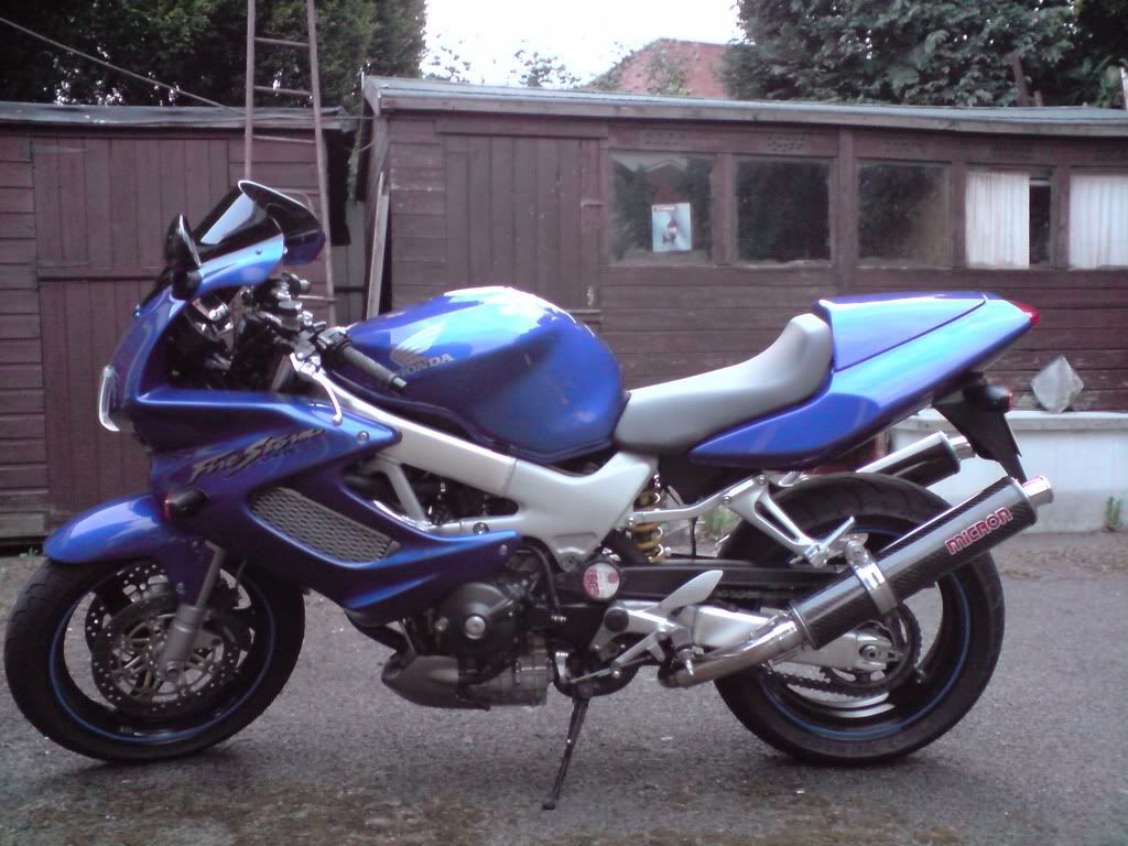

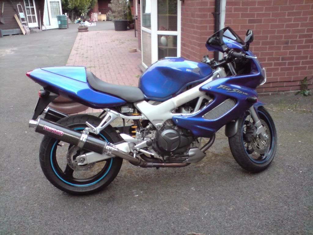

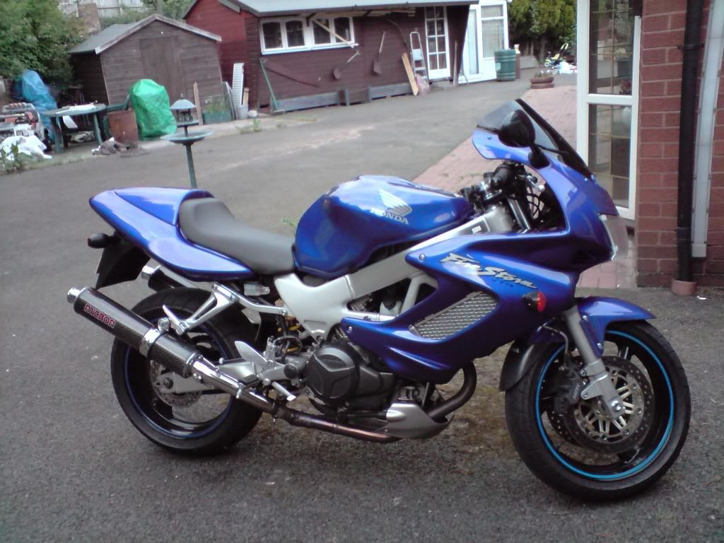

cut a long story short just fitted my micron cans from ebay...
Ohhhhhhhhhh Myyyyyyyyyy God!!!!!
have already got through a whole box of kleenex and im on my 3rd pair of underwear....
they are loud.. a lot louder than i expected..
and its like its had its throat cleared.. it feels so much smoother when opening her up..

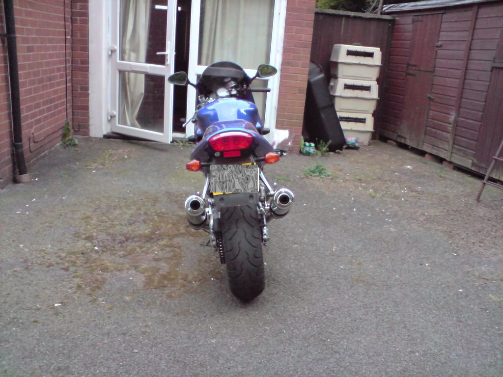

i have mentioned that i have found out its been down the road or dropped.
well on this next pic it shows the rear view and although you cannot see exactly but the cans dont sit the same.. im sure something is bent some where...

As to how they sit, mine are same dunno if it's something to do wi' the cans or the link pipes or what but they've always been like that, even when me bro' put them on the Storm from new. :roll:

I'm pretty sure the bike hasn't had a tumble. Getting the pipes to look even on some can be a right pain in the A$$. You will need to start by loosening all the joints right back to the headers and then give it all a good twist. Even then you might not get it exactly right. I just kept going until my patience ran out on mine and then decided it was close enough.

Looks good! Put the bike on a paddock stand, loosen all the exhaust joints then prop up the ends of the cans level using a plank of wood. Tighten joints and you're good to go.
When I rode my new aquisition home I noticed a "rrrr rrrr rrrr" noise, not loud but noticeable. Turns out it was the old (knackered) chain sawing it's way through the LH link pipe. Think I got away with it but there aint much clearance even now with the new chain. Getting those pipes in the right place can be tricky.

Yup,same with mine (2 sets,first were round microns similar to yours,sold them & fitted a set of Beowulfs with their own linkspipes) & had thesame thing ,R/H pipe seems to run out about half an inch or so.Pretty sure mine hasn't been down the road.
As Pete suggests loosen everything tighten back up & get it as close as you can,forget about it & enjoy the sound & ride :twisted: :twisted: :twisted:

might have a bash at it this weekend cause it niggles me every time i look at it from behind.. and cause of this i have tried to aviod any rear viewage of my bike... outa sight outa mind..
