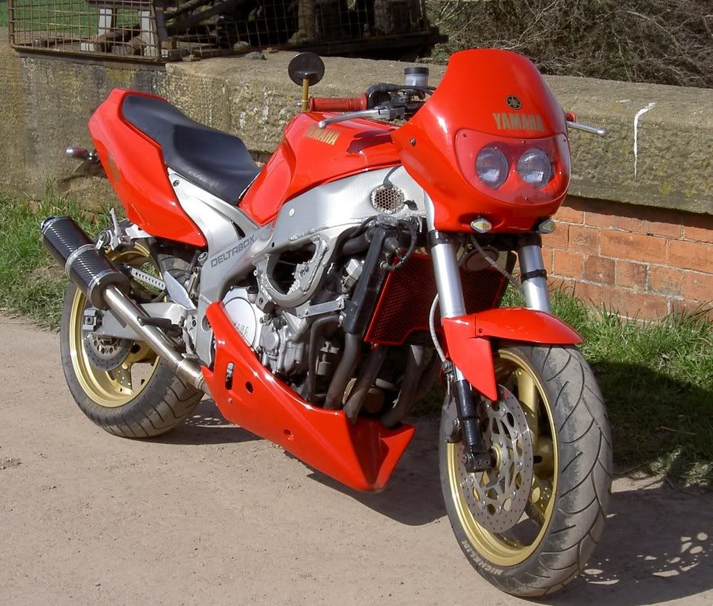

Had a quick go at fixing my mirrors, I got fed up with seeing my elbows! Not the best looking mod but they will do until I can think of a better way.

A different view of the same mod, I am getting used to them now!

Thanks Bikerpiker, the extensions are 50mm long, this is the same length as some commercially available extensions, and I wanted to see if this would be long enough for me.
They screw into the fixed studs on the mirror and the other end is a copy of the original mirror fixings. They are attached to the bike through the fairing in the same way as the original mirror, using some rubber spacers (made from tap washers). There is no more vibration than with the normal mirrors.
The intention was to try this length, and if 50mm was OK then I would buy the commercial ones, (but I now think I will keep these I made and save myself a few bob.)
