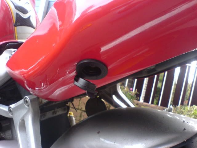

Well i finally got round to it. Sorted me winter staring problems.
I,ve had to do this due to the fact that I have no easy access to outside electricity.
Water proff 12v socket monted under the side panel and wireed straight to battery with 10amp in line fuse.

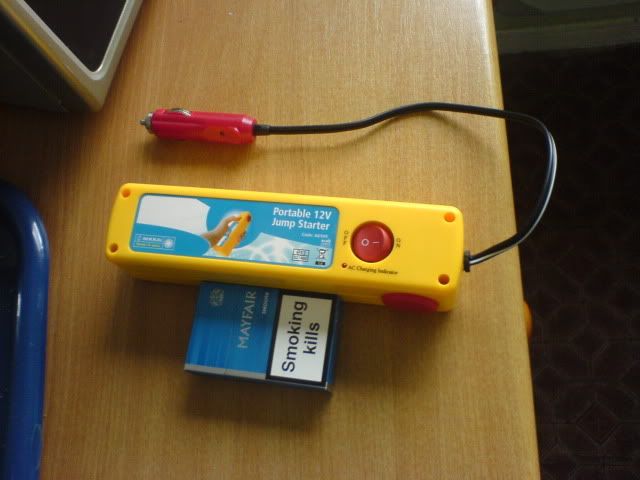

Sorced a very small booster pack, being small I can carry this in back pack on cold wet winter mornings.
Simply plug this into the scocket switch on booster and hey presto i,ve additional starting power. :thumbup: :thumbup:
Total project cost 35 pounds . :thumbup: :thumbup:

Where did the portable jump starter come from?

Pantaloonie wrote:Nicely done.
I was wondering that myself........it looks like it might've been here ...
http://cgi.ebay.co.uk/AUTO-JUMPER-12V-C ... 1680wt_939

Got the socket from e bay, place called Towzatroincs Item number (120432652359) can make it to suit where every you want to place it. I had it shortened to 800 mm . It was 10 pounds delivered.
The booster came from maplins but it looks very similar to the one your looking at.

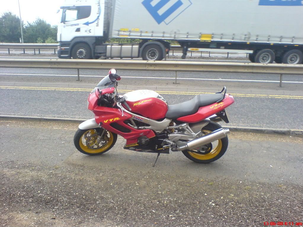

Paint job on the tank looks interesting, any other photos of the whole bike?

As purchased.......... :thumbdown:
After I finished with her. :thumbup: :thumbup: :thumbup:
I know it wont be to every one taste but hey I like it and she makes people look . :D :D :D

This is what towza stated for my bike. It,s fine for the booster side of things but I doubt it would do a complete system .
The battery sounds quite small at 1.3Ah, If the unit is designed for cars etc which their sockets are normally protected with a suitable fuse (checked the fuse rating on my van - 20A). With the socket rated at 15A (most manufacturers allow for a certain amount of overload) I feel that due to the short period of operation the socket should cope, although I would upgrade the cable to a higher current rating 15A or 25A. Upgrading the fuse holder to a standard blade type with a higher current rating capabilities will allow the fitting of a higher fuse ratting to no greater than 20A.

on the current rating of the socket and the battery pack..........Looking at the e-bay link that Bikerpiker put in his reply, these things are to give a 10min battery top up before you try and start, they dont have the charge density or harness resistance to deliver big amperage to do a conventional jump start.
The fact that the battery pack has cigarette socket and normal gauge wires also backs up the fact that it is not a high current supply, so for the way it was designed, the socket, wiring & fuse are all fine to work with the battery pack.
BUT..........Please dont try the Car to bike jump start option with these connectors or wire gauges as it will just melt if the bike battery is flat and all the current is coming from the car.
It will be ok if you are just using the car to trickle charge the bike if you have no mains electricity near the bike.

Also , I have actually tried the system and it dont cause any harm to the wiring or the booster itself. The booster end has a glass 5 amp fuse fitted and the cable to the socket has been upgraded so after using it the 5amp fuse is still working fine. I would have thought that if any thing was wrong, the small 5 amp fuse would have blown straight away. Failing that , the 10 amp in line fuse would have blown but thats still working ok.
