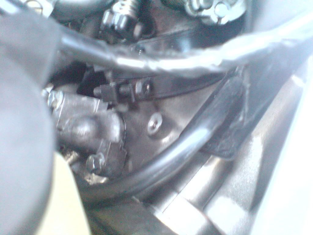

Bikes now all back together but is popping and farting through carbs and exhausts.So this morning i took off the tank and checked all the inlet rubbers were correctly seated and nice and tight and that i had no kinks in any of the fuel pipes...put it back together and started it up and its still doing it :crazy: :crazy: .
I then let it warm up and sit next to it and give it a good dose of looking and listening too.....where i hear a noise like air bieng sucked in...investigate and find this....
Now i'm pretty sure that this is where you connect the vacuum guages and that there should be a blanking screw in there and this could be the source of my problem!...what do you guys think?
Al

Yep, you've got it right.
This is the takeoff for the vacuum gauges when you balance the carbs; there's one on each cylinder.
The front one is the tricky one to get to, and so I'd suggest screwing a connector from a vacuum gauge kit in and leaving a bit of hose connected, with a blanking bung (some suggest a golf tee, I use a M6 bolt with a bit of sealant) in it and tucking it away under the tank.
This means that you can get to it easily without having to strip the tank and airbox off when you next balance the carbs.
You'll need to do it on the other one, too, but on mine this is already connected to the Scotoiler, so it's easy to disconnect that and connect a gauge.
But for now, all you need to do is insert a suitable screw or cap-head and your problem is solved. :thumbup:
(TIP: you can order a set of four M5 or M6 brass vacuum take-offs from (EDIT: Morgan Carbtune); they don't list them but if you e-mail them they'll let you have the code to order them. They're only a few pounds, best to get a set of four as then you'l be kitted up when your mate's IL4 needs doing. Same goes for vacuum gauge sets, a four pot set is best IMHO)

Cheers Tony...good tip there for connecting the hose for future carb balancing.Was wondering how it ever managed to run without the plug in place then realised its the head you sent me and i have the blanking plug on my old head.....so my fault for not checking it properly and swapping everything over....i swapped my carb inlet rubber and rad mounts but did not notice the vacuum blanker.

Just put the blanking screw in off the old head and it's running beautiful now....i'm well chuffed :thumbup:
