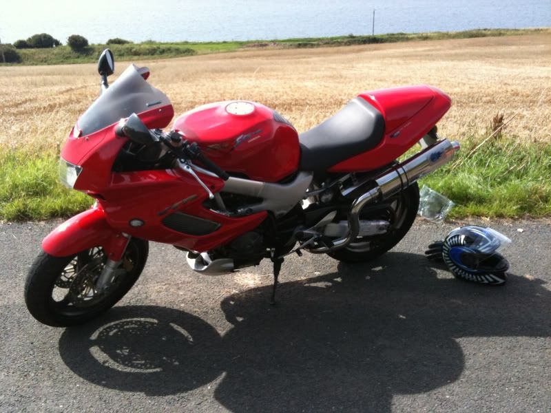

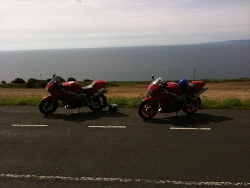

So I've owned the bike for just over 2 weeks... In that time I've had 3 days of riding, and 13 days of ripping it to bits and rebuilding it! Good job I love it already.... :thumbup:
Managed to get out for a wee run with Geordie yesterday too - pics below:
