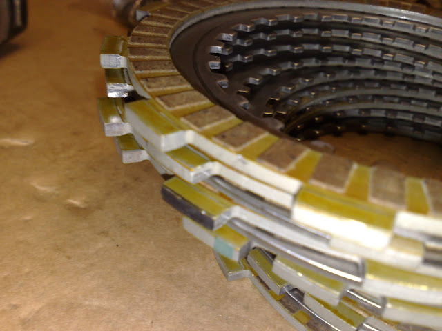

Well I've done a few more jobs on the firestorm, put the clutch back together and put the cover back on, Bit of an butt having to take it all apart just to find the plates were all good but at least I know now. Got my clutch master cylinder kit yesterday so will have a go at that at the weekend. Noticed that there is a screw on the piston - is this some kind of self adjusting mechanism? Wondering if that's what's causing the problem with mine at the moment. Noticed the rubber boot the push rod goes into was split so hmm...

I've done the clutch master cylinder, bled it through and checked the clutch plate movement through the oil filler cap, noticed something a bit strange:
[youtube][/youtube].
When the clutch is pulled in, all of the clutch plates retract with the pressure plate as if they were stuck together with glue. When I put them back in the basket I coated them in clean engine oil based on the shop manual instructions. I would have expected them just to become slack and movable - what do other people's bikes do?
I have the feeling that when I try the clutch I will be back to where I started with uber later take up. So far to try and rectify this I've: rebuilt the slave cylinder with a new seal, inspected clutch discs/plates (all good), replaced the clutch hose line, cleaned the push rod and rebuilt the master cylinder with new piston/seals/spring etc. There's not a lot left (other than buying a diff bike!) lol.

I've gone one step further... whipped the clutch out again and cleaned it in petrol (rightly or wrongly - uh oh) to get rid of all traces of old unknown oil. I've reassembled it with a smear of oil (nowhere near as much as the first reassemble) and now the clutch behaves more like I would expect - it doesn't stick to the pressure plate.
[youtube][/youtube]
Rolled it in gear and let the clutch out to find the biting point - seems to be earlier than before. Haven't filled it with oil yet for the acid test thought.

careful with pushrod grinding- they're usually only case hardened on the ends, so when you grind that off you're left with unhardened metal.
Not sure if this will make much difference on a self-adjusting clutch, because the usual problem caused by a worn pushrod is due to insufficient clearance on the cable, meaning the pushrod's in contact and under a little pressure the whole time.
I have a feeling that with a shortened pushrod you will have exactly the same situation, as the hydraulics will just compensate.
Is the pushrod properly seated in the "top hat" in the clutch?
And is the top hat properly seated in the small bearing in the pressure plate?
And is the bearing properly seated in the pressure plate?

People have suggested air in the fluid but I don't understand how that would cause the affect I am seeing, I would have thought that would have that opposite affect??
Good news though - I have now got the carbs balanced now thanks to a bargain buy of a set of Davida vacuum gauges from ebay! yay!
Pretty sure that the front cylinder rattling is def the CCT too as you can hear it on the overrun and the noise has changed a bit since doing the stopper mod.
I'm assuming the top hat is seated correctly, can't really tell now as I've rebuilt it and filled with new oil. I think if the push rod was riding the side of the top hat it wouldn't assemble at the slave cylinder end as the push rod would hanging out too much. I will have a look from the slave cylinder end to feel if the push rod is bottoming out.Is the pushrod properly seated in the "top hat" in the clutch?
Pretty sure it is. I did try the top hat in the pressure plate when it was disassembled and it fitted OK. I did notice that the top hat had some scoring on the outside. This looked liked where it had picked up against what it sits in. Nothing major, cleaned it up with a bit of wet and dry.And is the top hat properly seated in the small bearing in the pressure plate?
Did check the bearing to make sure it didn't need replacing, seemed to be flush in the pressure plate.And is the bearing properly seated in the pressure plate?
