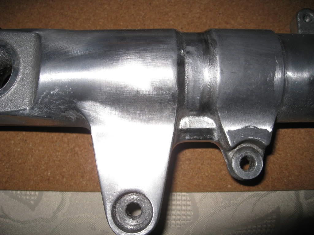

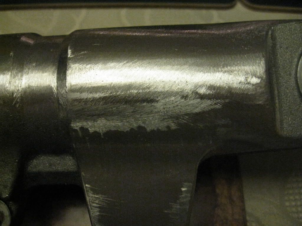

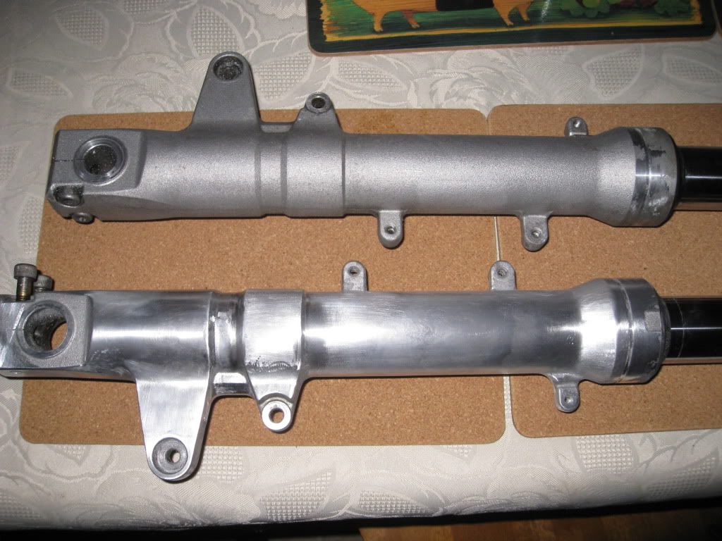

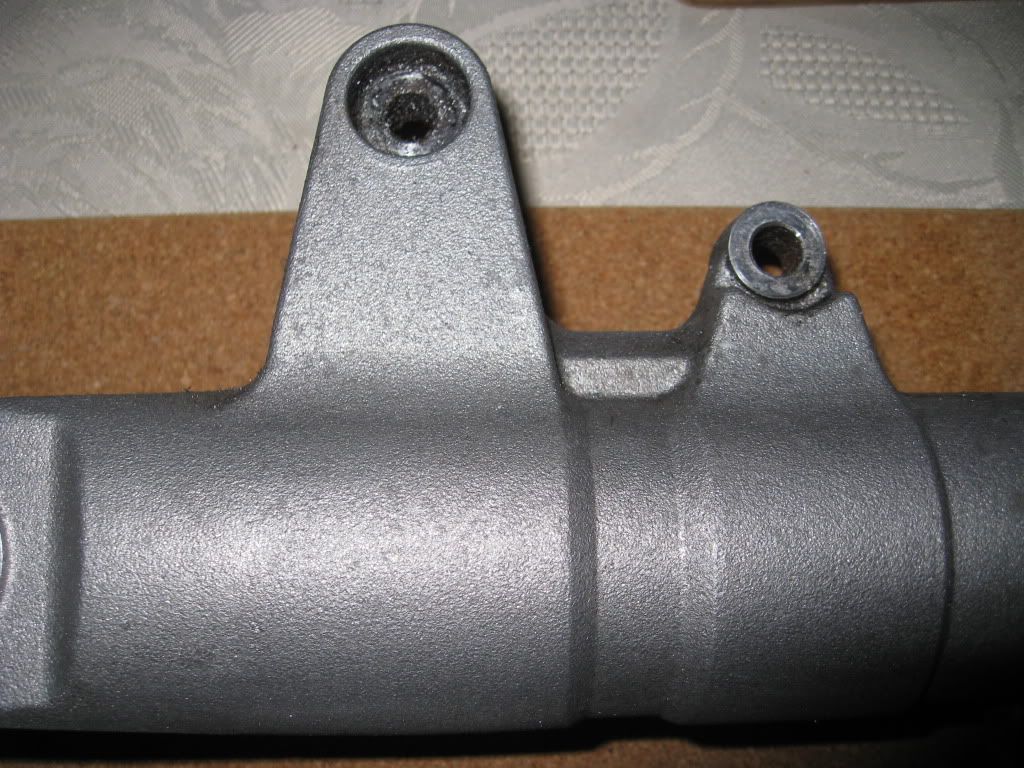

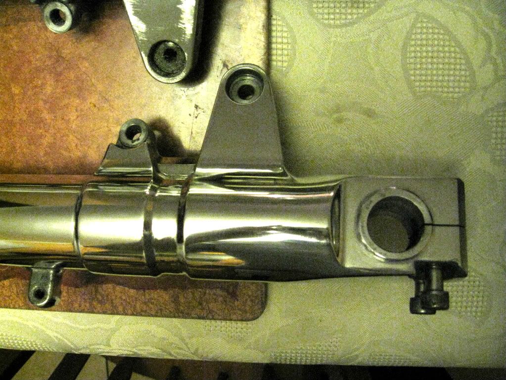

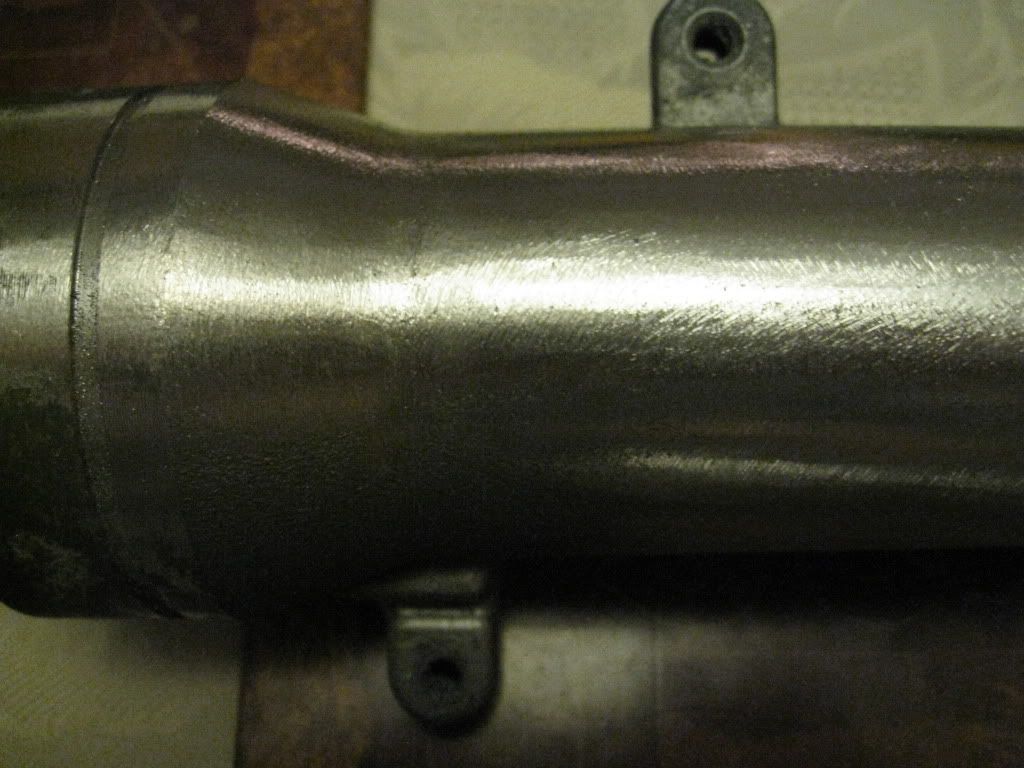

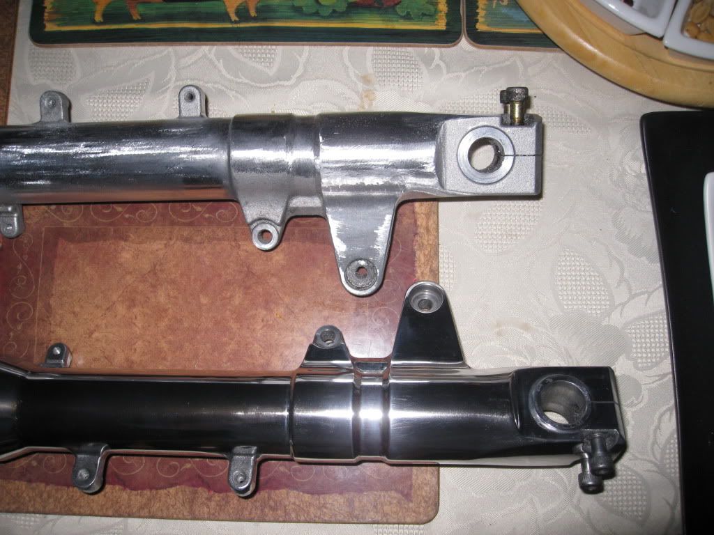

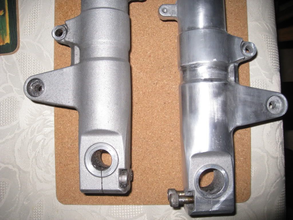

I polished mine, it took about 16 hours for each side and that was not in one hit as I was replacing the springs etc I did it over the winter in my kitchen.
In all I used fine metal file, 80 grit, 160 grit, 320 grit, 600 grit, 1000 grit, 1500 grit, 2500 grit and a high finish meatal polish to finish. the more stages you use the better finish you get, and having a large leap between grits means that you have to work harder to remove that scratches from the last grit.
Hope this helps;
First off I started with a metal file to remove the texture effect of the original casting
Top is the original after nitromorse, below is with the fine metal file
Left again is the original as a reference, right is with 80 grit wet n dry
next I used 160 grit wet n dry
160 grit wet n dry close up, as you can see there are still alot of scratches from the 80 grit
original again as a comparison
Top is 160 along with the bottom as a comparision that's nearly finished
Finished, just needs finalising with meguairs metal polish
Another comparision
Hope this helps;
Another comparision
