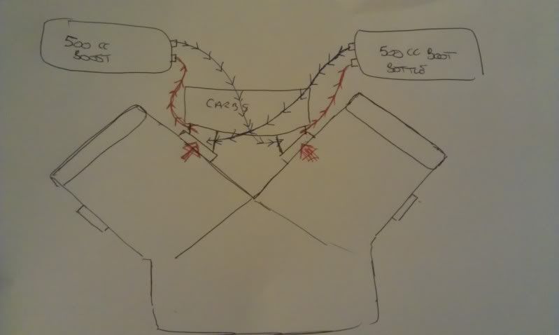

I know these work with two strokes and are not meant for four strokes but i have a plan....
you take two bottles and four lines and some one way vlaves....
Run a bottle with two lines with one way valves fitted so one is fitted to allow air to go into the boost chamber and the other line cross it over to the other cylinders intake and run it so it flows the air into that one and vice versa so its criss crossing, would that work? then in therory it would be pushing air up one tubes cylinder and shoving it in the others intake when that is ready to fire, i think?
i will draw a picture soon.

I know its a crude drawing but that's as good as it gets from me lol
you can see my thinking i hopes, as one has possibly pushed air back if possible on a 4 stroke it can shove it into the other cylnder when it is firing as with the twin as one is at the top one is at the bottom so should create a continues equal flow
As its got one way valves fitted as well this should stop any negative effects either as well i think?
could it stop the air box cough as well?
i shall stop now and get some sleep, just an idea.

Even the two-stroke folk don't seem to rate them - why do you think they would work on a large capacity 4-stroke?

Wicky wrote:Even the two-stroke folk don't seem to rate them - why do you think they would work on a large capacity 4-stroke?
http://www.aircooledrdclub.org.uk/forum ... ?TID=23186
Looked at a lot of sites some do some don't yamaha fitted them as standard to a few bikes so they must be of some use?

There was a factory Yamaha Energy Induction System YEIS (rx100) specifically for small capacity two-strokes, never on four-strokes. All a gimmick a bit like Honda inboard ventilated brakes :wink:
