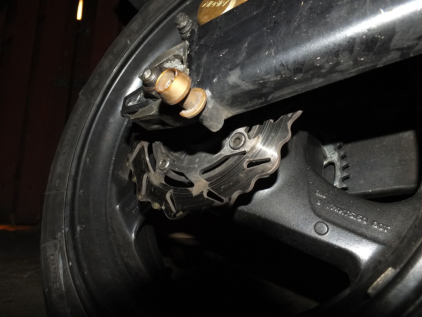

I wouldn't go drilling holes directly into the Swingarm. It's simple.... have a bit of metal bar welded to the bottom of the swingarm, drill holes, thread and your done. :thumbup:
sh1t picture as it's pitch black outside and I just aimed and fired :lol:
