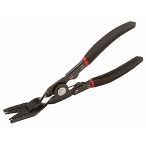

Yes there are two built in "plugs" that just press fit into holes in the swing arm.
Gently pry from underneath , best if done from both sides of the plug.
i use a automotive body push pin tool.. looks like a v shaped fork.
Or this
But a large flat blade screw driver or two works as well

Hi Matt, Just spray a bit of wd40 or similar where the plugs are held into the swing arm and they will just pop out
