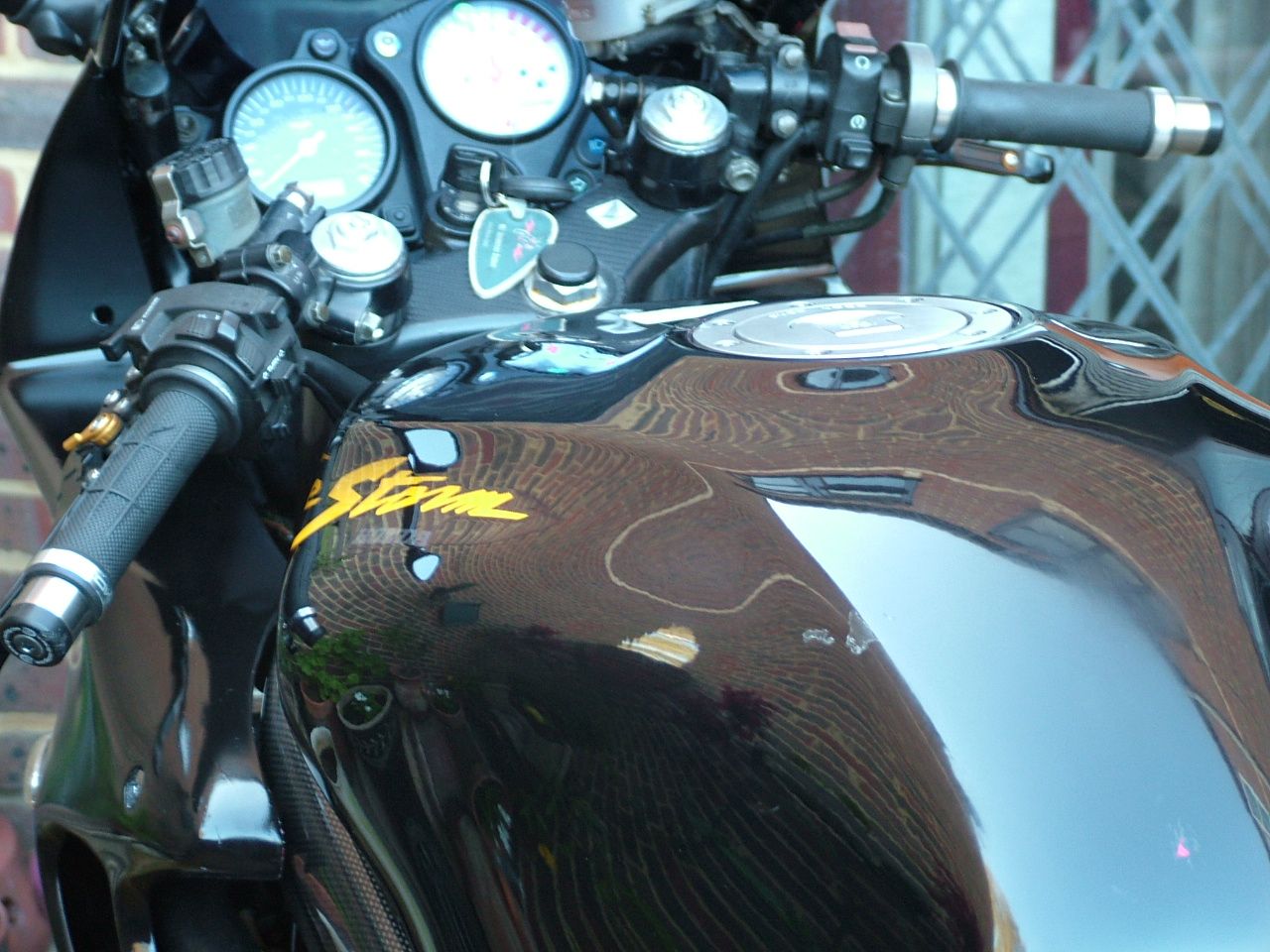

If it's the wrist action that is an issue then you could also consider installing a Quick Action Throttle tube like HRC or equivalent. This gives less twist on the throttle to get to wide open and stops the double wrist action movement required with the standard throttle tube and add less stress on the wrist at larger throttle opening cruising down motorways.
I'm not a fan of renthal bars and opted for later model storm clip on's which are raised 15.6mm and angle more upwards 7 degrees. And they come in the faster colour :wink: along with a HRC QAT.
No clearance issues or having to trim the fairing. :thumbup:
