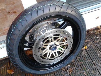

Ok, wheel powder coated, new Avon storm 2 fitted, looks like I gotta spend more money on a front stand.

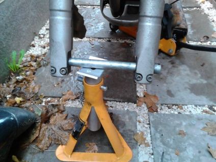

now let me think, I got a trolley jack, axle stands ok her goes, a bit precarious

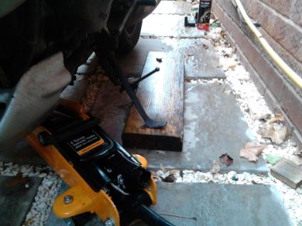

I slackened everything off, Put a block of wood under the centre stand to get the bike nearly upright,then jacked off the sump, when the front wheel was off the ground, holding the bike steady with one hand,
removed front wheel spindle, quickly removed wheel,slid axle stand in, happy days.

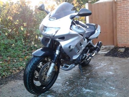

Fittng was a little bit more difficult,but the spindle went back in once I got the spacers to stay put.
Pretty pleased with the shiny powder coating , cost £35 and all I had to do was remove valve stem and bearings, stuff painting !!
