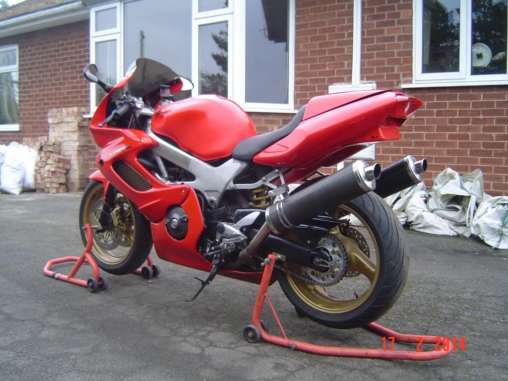

Right gang, I'm looking to go "Upswept" ( SP 1/2 ) style with my storm cans but not so upswept that I have to change my standard indi's. Any ideas or what have any of you used to get this on your bike? Not worried if I keep or loose pillion pegs but I did wonder if SP pillion pegs would fit/give me what I'm after :? Cheers Mr Watty :thumbup:

Not exactly upswept but i thought these where the best i have had so far - wish i had kept the Remus system
Laser system - very loud - had there own hangers which lifted the pillion pegs up higher
Remus Grand Prix - not too loud, nice sound - very tidy fit - needed spacers for foot pegs

Quite like both of those Stuart and although I'm not a big fan of high levels they look very neat :thumbup:

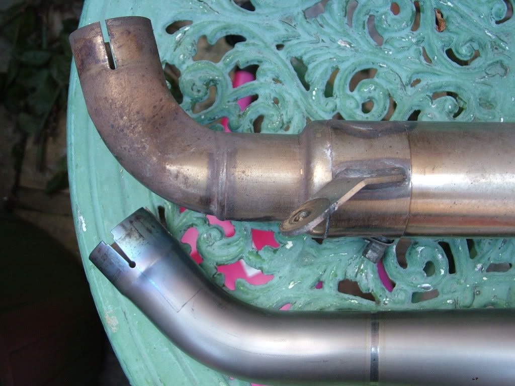

his arata's were made for an sp1
Correction.....mine are/where :( for SP2 not SP1. Be aware that the angles are different between 1 and 2. SP1's are more like the Storm and have more of a 90 degree bend. Whereas the SP2 is more a 45 degree bend. I ended up cutting the left link just short of the bend and using a 90 degree mandrel bend to attach the two.
Not perfect but done the trick. It would have been much better if I ever got around to finding someone to make a TI link/mandrel custom made to fit perfectly. I also had an issue with the taper on the Arata link and attaching the mandrel which wasn't tapered.
OM indi'd will most likely be a no go.
As for hangers you can use SP hangers but you would have to reposition the mounting holes. As Lloydie says hole is off.
