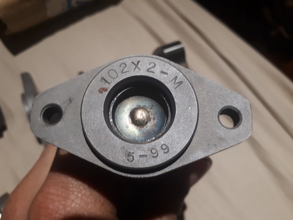

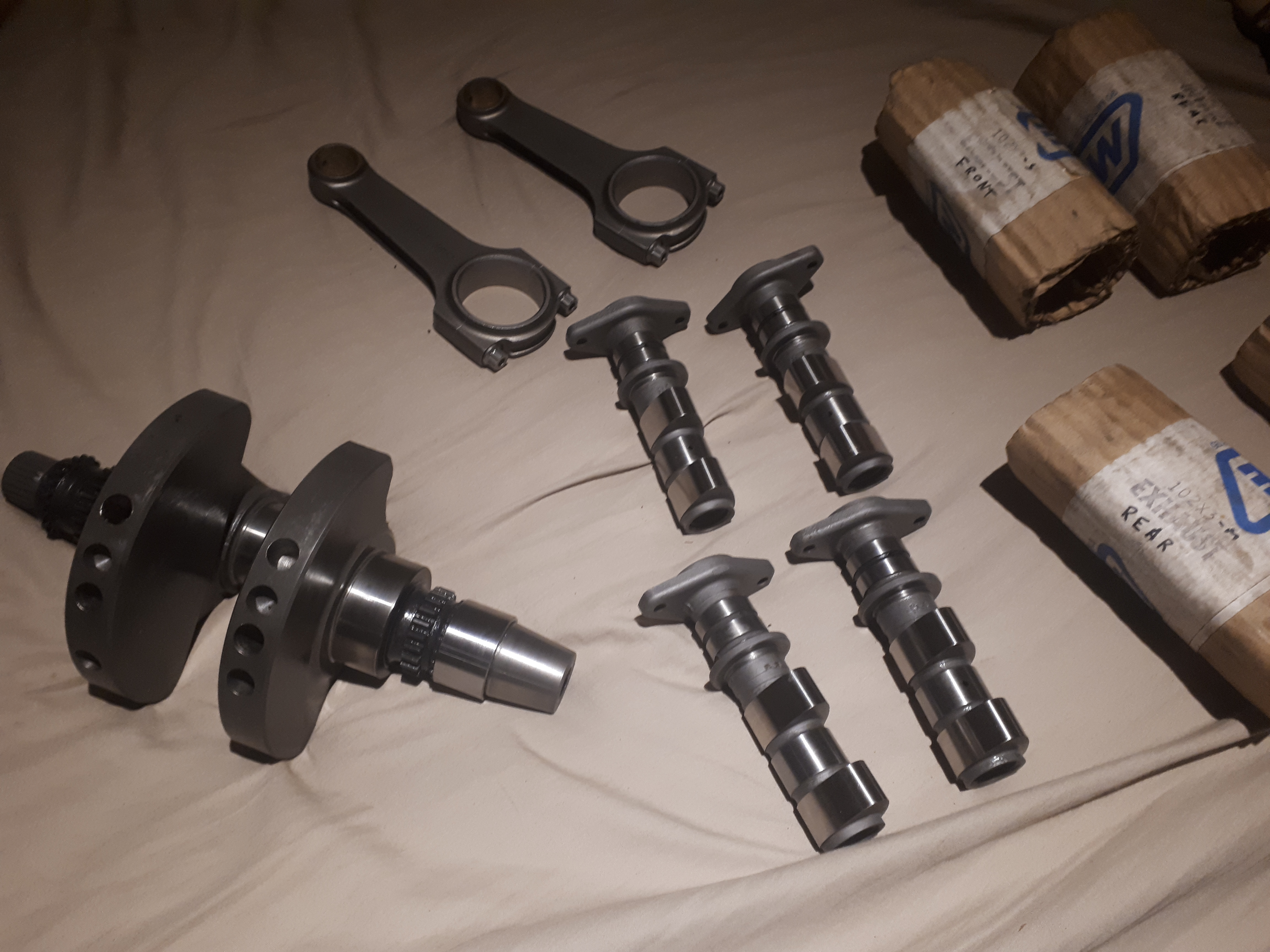

Great news! It seems theses are some real deal parts.
the crank is in new honda box with the crankshaft part number labeled "Moriwaki balanced blueprinted crankshaft"
I received two sets of carillo rods.. the shipping label says they were shipped to a Honda manufacure plant in toronto.
the cams are in a megacycle cams box labelled stage 2, but I think they may be moriwaki that have beed reprofiled.
I measured the lift at 10.9mm on the intake cam and 10.8mm on the exaust cam.
The date on the box said they were made in 1999.. Im thinking these parts were all part of an R&D project at honda.

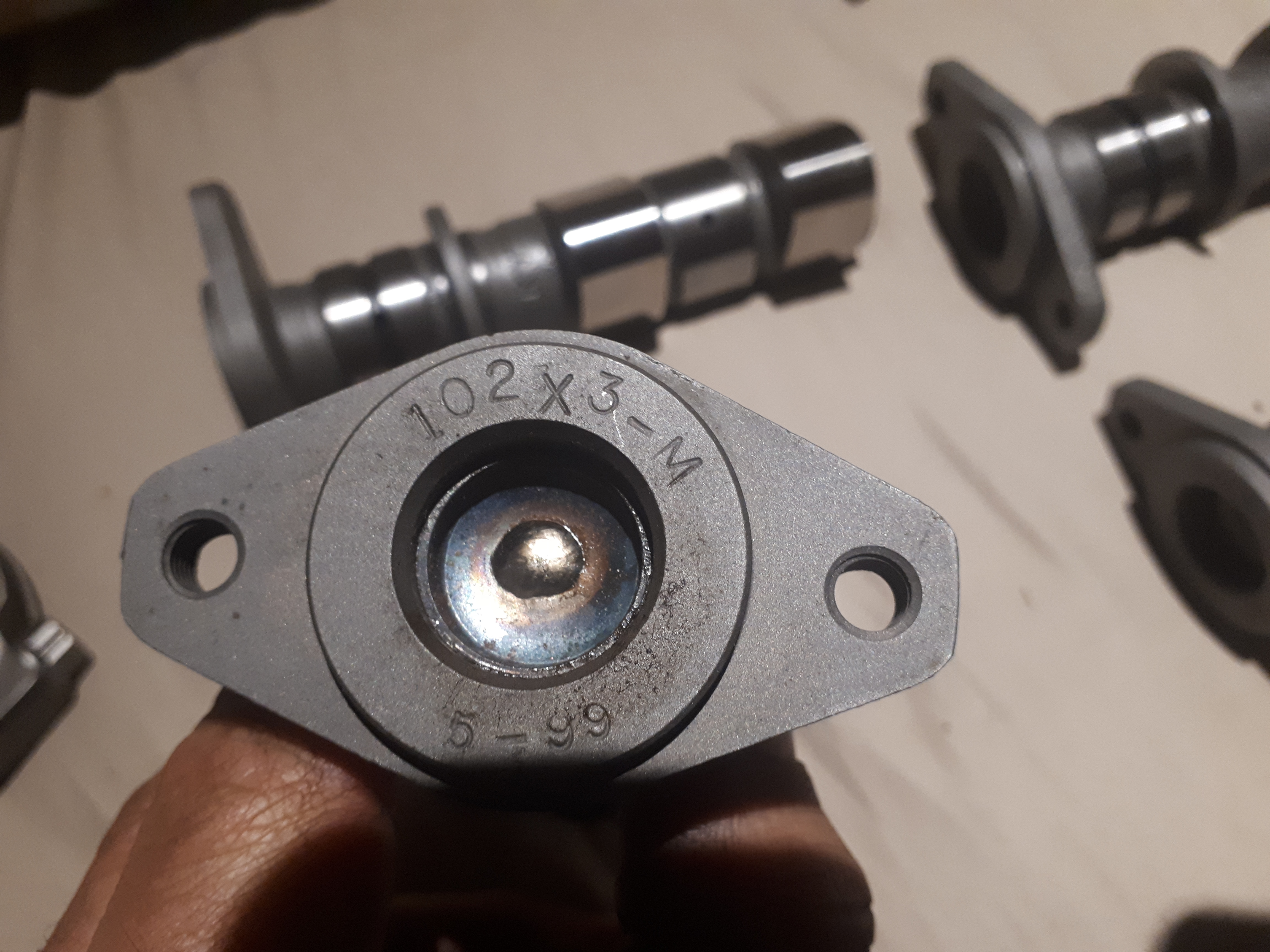

so after talking to the chap I bought this stuff from, he said everything was supplied by Honda to a local guy who was racing a vtr and was sponsered by honda.

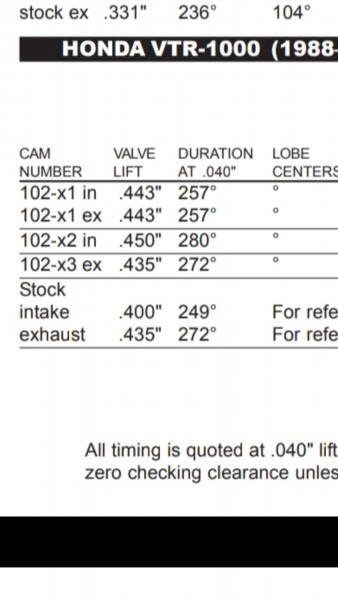

I looked up the cam specs in the mega cycle book from the stamped 102X3 on the ends.
the specs are:
Intake:
Lift - 11.43mm
Duration @ 40 thou - 280deg
exhaust:
Lift 11.05mm
Duration @ 40 thou- 272deg
also says: must use racing pistons and springs.

Is it just me.. or do these degree numbers seem very high.
Im thinking that its because its measured at 40thou instead of the standard 50thou
