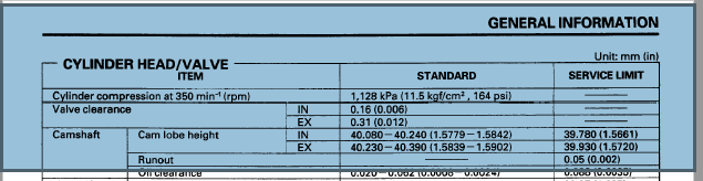

KermitLeFrog wrote: Mon Dec 24, 2018 5:53 pm Interesting that they don't give a tolerance in the manual, or have I missed it?
Page 1-7 in the factory manual
The 1st number you see is the "specification" the perfect clearance, the next numbers are the range allowed.
In that chart 1st set of numbers is metric 2nd set ( SAE) )

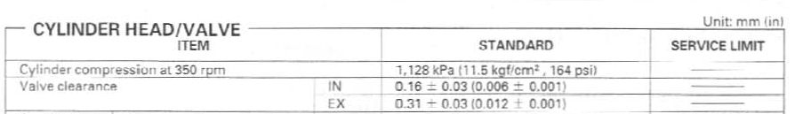

E.Marquez wrote: Mon Dec 24, 2018 7:34 pm
My manual

KermitLeFrog wrote: Mon Dec 24, 2018 10:16 pm
My manual
Is that a factory manual or an after market?
I have three different factory manuals all are the same with the spec and tolerance :confused
