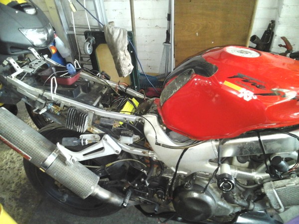

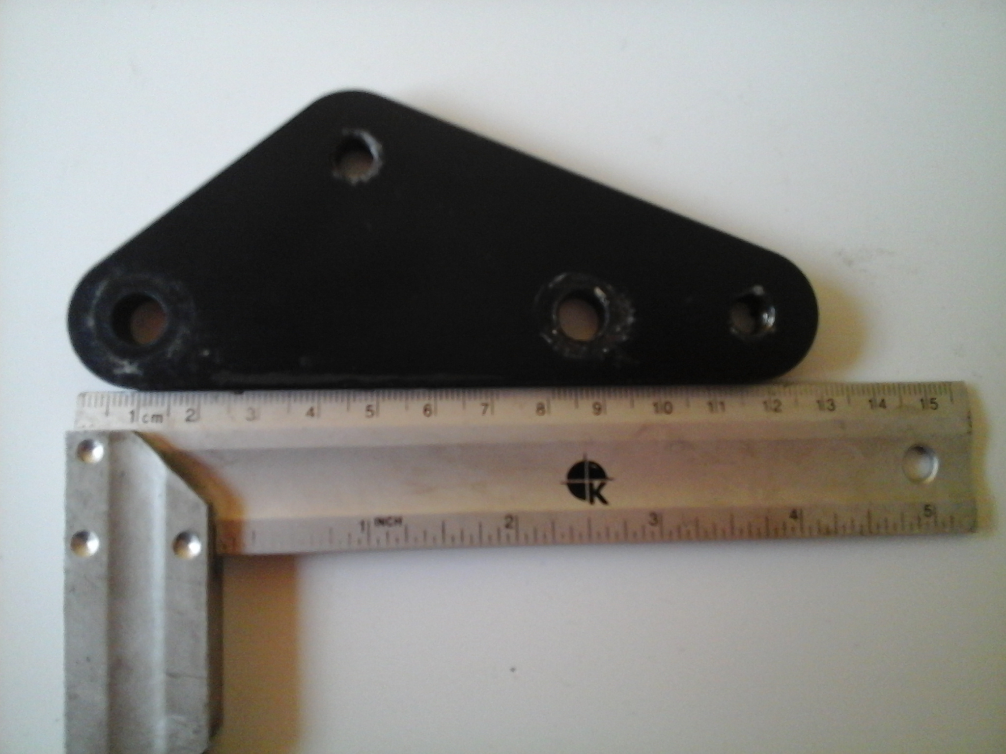

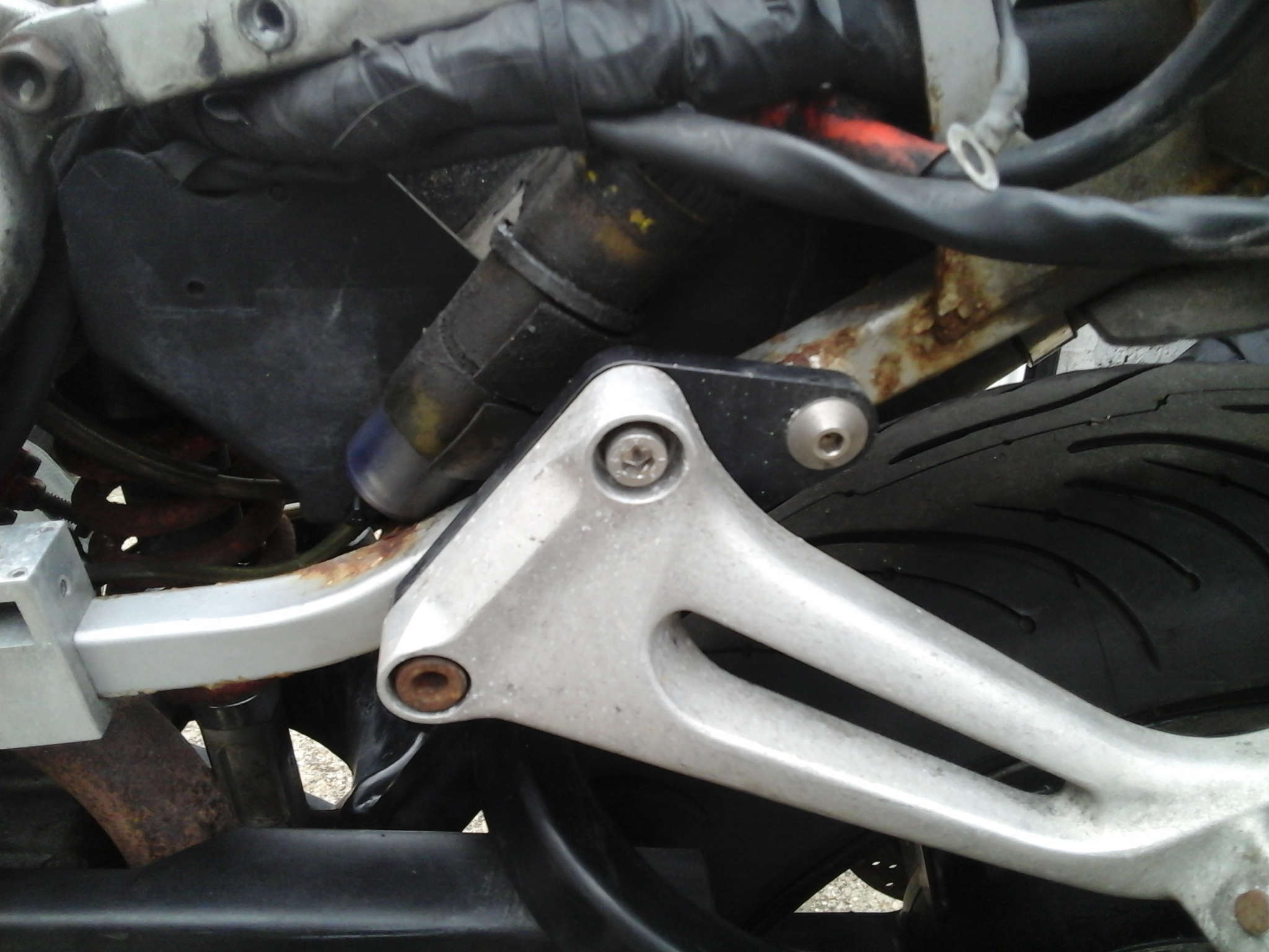

A simple metal plate to alter the angle of the dangle of the rear hangers...

Posts: 15977
Re: Aftermarket exhausts
TheBozBoz wrote: Sun Nov 08, 2020 2:50 pm So simple yet so effective! Is there some on on the forum that makes these?
Sent from my G3311 using Tapatalk
It's a bit of ali plate with three holes in. You could make some quicker than ordering some.
Stack one on top of the other when shaping and drilling to ensure both sides are the same.
