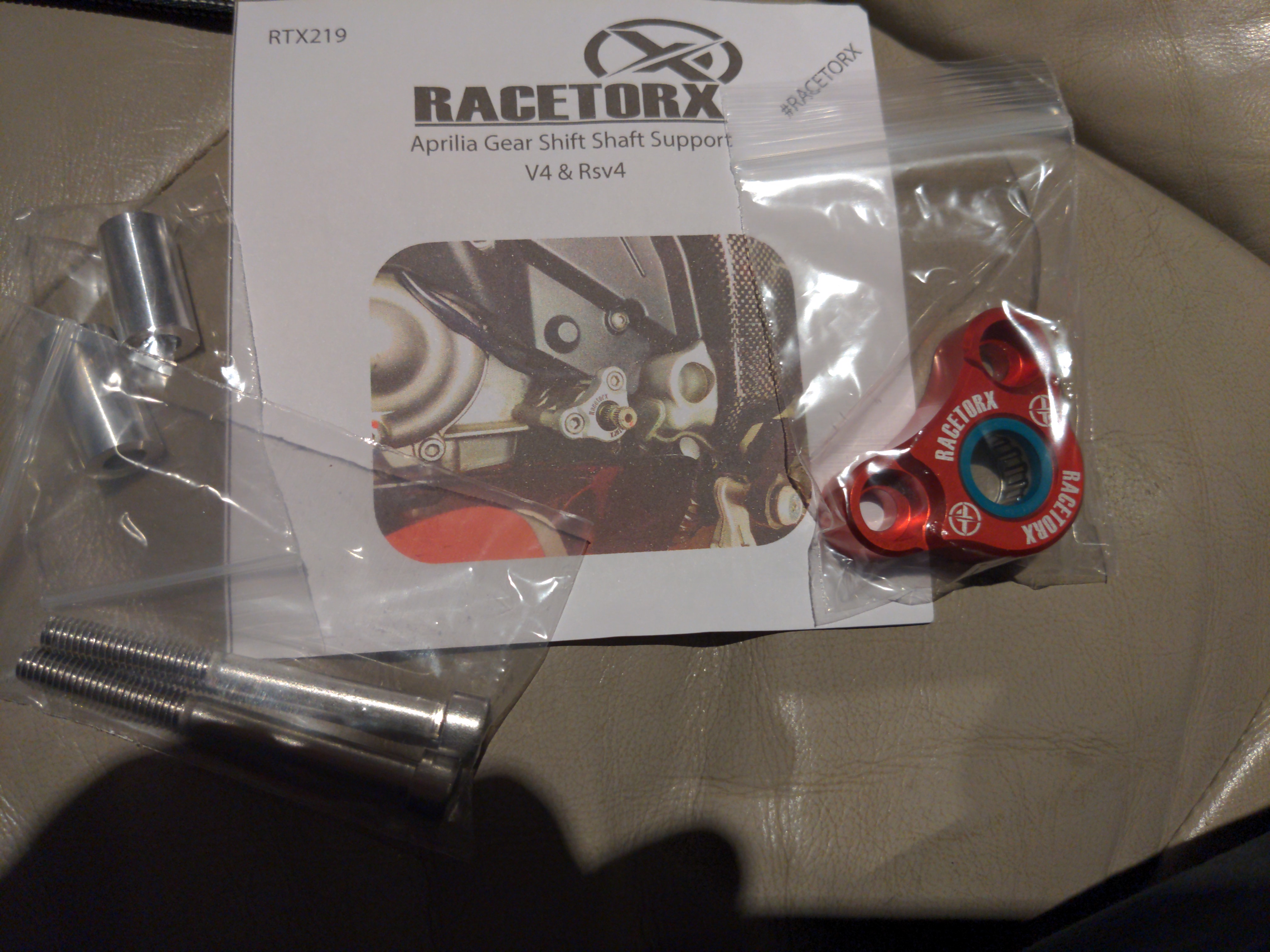

For the Tuono you can buy a gear shaft support bearing. I am struggling to understand how it can make a difference. After all, the gearchange shaft is a 12 or so mm diameter steel bar- it can't possibly be bent by the aluminium linkage.
But people say that fitting one improves gearchanging. It already has an up and down quickshifter, which feels good, no false shifts, I can't fault it.
So, as I have a £30 birthday gift from work, I thought I'd get one to see if I can tell the difference.
All I can think of so far is that it will help to minimise damage if I drop it on its lh side, unless the force acts directly along the shaft axis. Any oblique force will benefit from some additional support.
Any ideas as to how, mechanically, it can do anything other than add weight?

Well, fitted, and no discernible difference. The standard shaft bearing is also an outrigger, so the racetorx one just added a little extra support even further out nearer the lever at the gearbox end.
I did get two missed downshifts to first, but that's par for the course when downshifting at lower revs, it's perfect at mid to high revs.
The only good point was that I dug out more weight in old chain lube and grit than the weight of the new parts!
The standard bearing on a V4 Aprilia motor is already placed right towards the outer end of the shaft, if it were a design that left a long length of unsupported shaft it might be worthwhile.
Nicely made, though.

I don't want to sound like a permanent Cassandra on all of this but what will that prove? The radial movement of the end of the shaft when shifting gear will be very small. A combination of the bending strain (fractions of a micron or less?) plus the slack (if any) in the end bearing/bush. Both of these combined will be negligible. Any possible reduction in this negligible amount will have no effect on the operation of the transmission.
What will probably have a very small effect is the extra friction caused by the additional bearing and seals. But I can't see this being noticeable either until the seals fail and the bearing gets knackered. In essence this is a nicely made piece of bright red bling/tat which in the case of a V4 Aprilia is pointless. This sort of stuff really makes my engineering head hurt.

That's what I thought as well, but I had some "bike" money to spend and thought I'd decide for myself whether there was any truth in the occasional rave reviews you see supporting the product.
If the standard-fit outrigger bearing was sloppy it might make a difference, I suppose.
Myth busted, for me, anyway, on that model.
