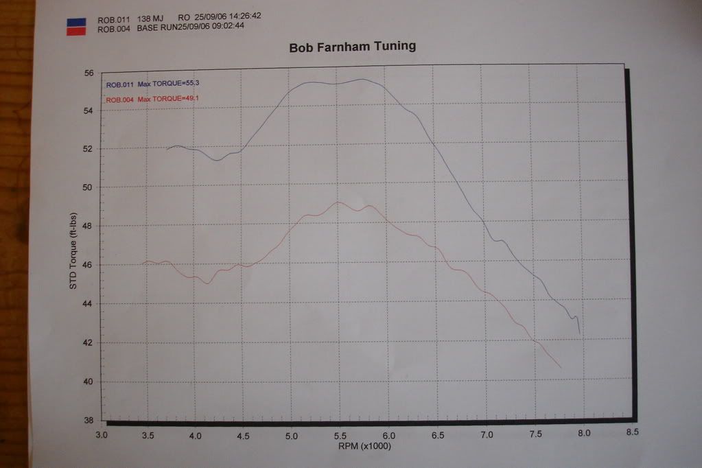

Modifications:
Airbox removal
K & N Filters
Rejet 138 (up from 110)
1 Tooth up on front sprocket.
All carried out at Bob Farnham Tuning, Wrotham, Kent TN15 7RR.
Rear Wheel Horsepower with Triumph Race Cans cans: 60.1 BHP
Rear Wheel Horsepower after 65.1 BHP
Rear Wheel Torque with Triumph Race Cans: 49.1 ft lbs
Rear Wheel Torque after 55.5 ft lbs

Nice torque curves Rob.
Looks like money well spent :lol:
Posts: 22440
That looks quite impressive Rob :!: How does the difference feel on the road :?:

Hi Chaps
The engine rev's faster, so the bike accelerates harder. The intake noise is incredible, so that also adds to the fun and keeps me pinning the throttle. I'm loving every minute on this bike.
Next plan is to have Bob Farnham gas flow the head, skim the head to increase the compression ratio, and modify the valve seating. This work should increase the rear wheel power to about 75BHP with torque gaines everwhere. That's getting on for 90 BHP at the crank. That's only 15 shy of the 105 BHP claimed by Honda for my Storm!!!

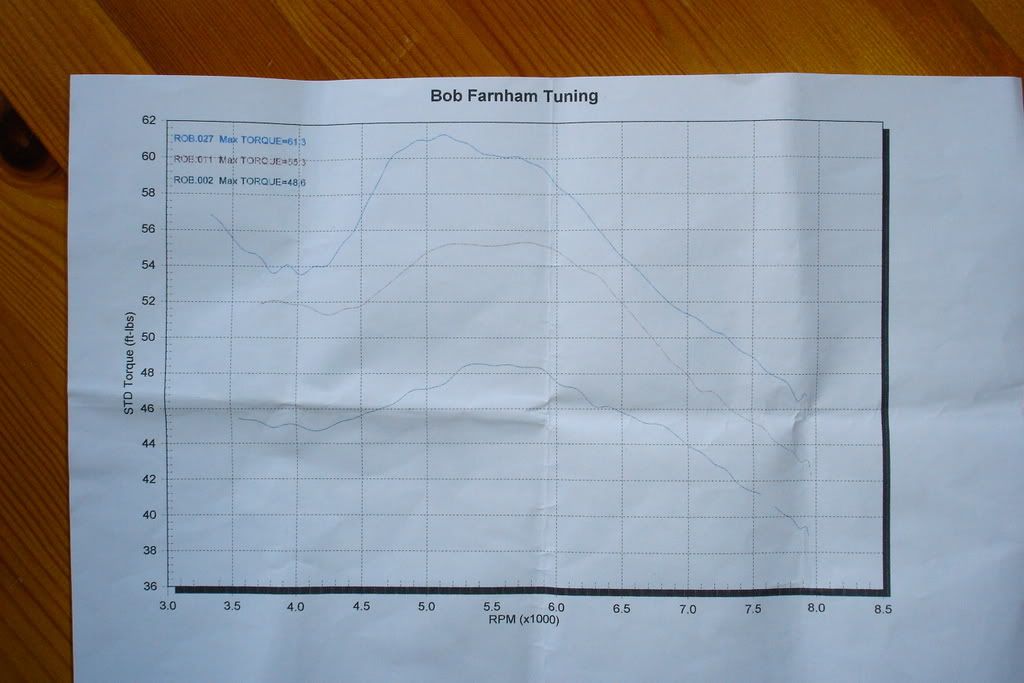

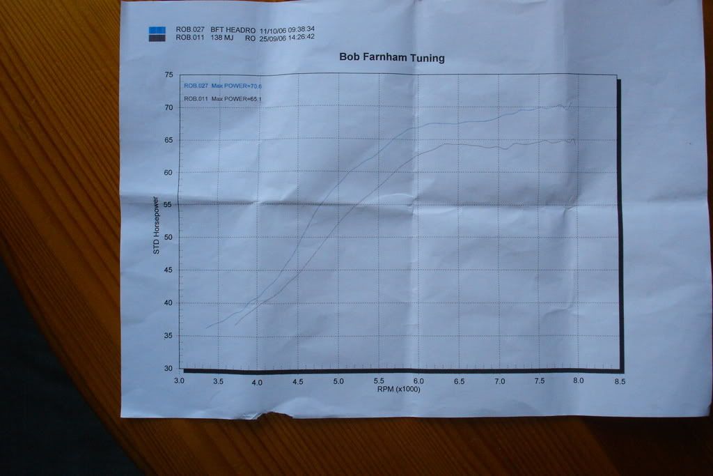

MODIFIED CYLINDER HEAD RESULTS
Post by robnobrakes »
Its now back after the cylinder head work.
Rear Wheel BHP now 70.6
Torque now 61.3 ft/Lbs
The final BHP figure gives a 32% improvement over a stock bike which makes about 53 rear wheel BHP.
The final torque figure gives a 27% improvement over my bike fitted with race cans.
These improvements are very impressive IMO. The bike is so much quicker everywhere. My chum on his 955i Speed Triple said he had to use all his revs to get past me on the way back from the tuners today, and that was at over 90mph before he managed it!!

Posts: 22440
Cheers for posting that Rob :!:
That is quite an amazing increase in BHP and torque from the standard engine :!: very impressive indeed :!:
How do you find the engine vibration wise now the compression has been increased :?:
Hi Chris
The first things I noticed were:-
(1) Less vibration at all revs (and there wasn't much before)
(2) 10% stronger clutch springs were also fitted to prevent possible clutch slip in 4th gear. The gearchange is smoother, and the lever snicks into 1st at standstill with no clonking (which I had before, a bit like the Firestorm). Clutchless gearchanges up AND down the gearbox are a piece of cake (I don't try this between 1st & 2nd though).
This bike is getting better and better the more I ride it. I've just clicked over 1000 miles today, so the motor will loosen up a bit more I think.
