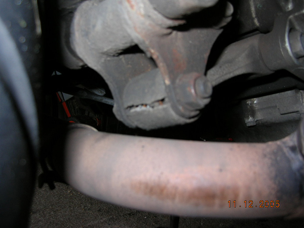

The swingarm bearings and linkage bearings need regular greasing, even more so if the bike is used all year round :!:
Don't leave it too late :!:
We've already had one bikes linkage split due to a seized bearing and another member has just had the rear end collapse on his bike, fortunately at low speed :!:
Courtesy of Pete.L :wink:
Rear linkage split.jpg (103.64 KiB) Viewed 15583 times

wow , good point and really nice pic to show us where. will check mine at weekend.

Just thought I should emphasize the "seized" bit just to reinforce it had nothing to do with my fat A$$ :wink:

More of an issue with bikes without huggers I would have thought. The Blade I bought was Huggerless and the lower linkage gets all the shi*e
Its more of a rear wheel crap displacement issue I think.

I doubt having a hugger would make much difference to the bottom linkages as they're 'open' to the elements and / or spray from rear tyre regardless of whether a hugger is fiited or not.
The bottom linkage lies below the level of the swining arm, while huggers tend to sit ontop and merely protect the shock and the undertray from crap.
IMO a very important addition to any bike that doesn't come with one as standard (as most don't).

wombles me.. have you ever cleaned that area?
looks neglected...like hell

Got it oin one RedstormV
That was my old linkage and I had a Hugger and fairing lower fitted from almost new.
In my defence, the bike was ridden all year round though and what started off as a little squeak when I sat on it in the mornings disappeared so I didn't think about it again until I found the crack. It shat me up a bit cause I had no idea I was potentially riding a death trap, it still even handled okay 8O

Just looked at mine,but cos its a grey rainy day,it's quite dark in my garage.
Im sure i could see a sort of line,just in the same place of the crack in pic above,but to be honest ,think it's just a casting mark.
Also noticed how close it is to exhaust pipe, cant be much more than a cm away,possibly the heat from pipe ,especialy when goin slow,or stationary dries the joint out :?:

Hi all, it was my bike that had the shock link collapse, thank god at low speed. PLEASE check yours, would hate to read about someone on here getting hurt for the sake of a 2 minute check.
Be safe, Chris.
