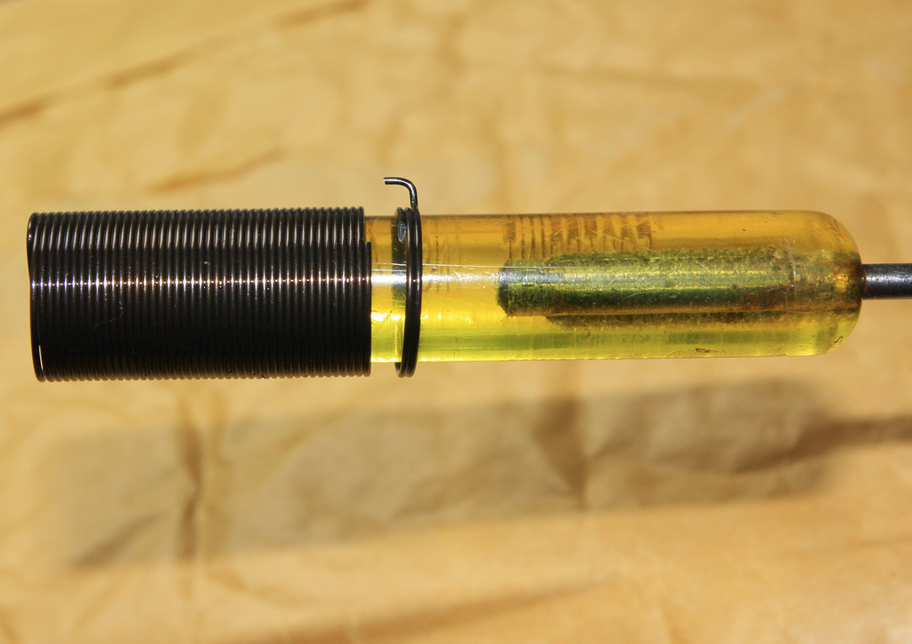

A few weeks ago I took the Storm for a ride out, I'd only done around 15 miles when the front CCT decided to fail. As I had fitted the Stopper Mod I was able to ride the bike back home :D
Yesterday I stripped the old CCT to have a look at the broken spring. This is what I found, I wasn't expecting the spring to be broken at the bottom end:-
In the bottom photo It almost looks like the spring had been cut half way through, obviously it hadn't.

It's proven the stopper mod works :clap: well done .
I didn't think the spring was That big .
Spring always fail near the end as it gets worked the hardest !

Recently a new forum member had some aftermarket springs crafted up, I wonder if his source has any more or if a company like this ( http://www.lancashire-spring.co.uk ), could perform a professional metallurgic analysis on why it failed and suggest a better replacement.

That was the best bit really being able to ride it back home. No waiting around for the break down truck or any damage to the valves. New CCT fitted with the stopper mod, I repaired it the day after I got back. I already had a brand new CCT waiting to go.
lloydie wrote:It's proven the stopper mod works :clap: well done .
It's surprising how big I can make it look with the right gear :wink: :lol:
Yes I agree about the springs failing near the end, but the ones I've seen are usually broken at the other end, the end which is furthest away from the engine oil,

Fantastic photos :thumbup:
+1 You got to love a bit of Macro :thumbup:
It's good to have some good close up pics of where they fail. At least they can be used to show others exactly what goes wrong. If new CCT's where not so expensive to replace I would consider the stop mod over manuals if dong it again. It would be nice to be able to just buy new springs. They just look to thin and fragile to me and you can see particles of rust starting to form on the outside. Maybe if the springs where a thicker coil they would not snap so easily.

Interesting photo's Chris. I had a return spring in a door handle fail in the same way, however no valves were damaged in that incident!! :lol:

i'm really glad you posted that picture sirch.
i was talking to a vtr owner the other night and he said that every failed cct he'd stripped had failed due to the bike not being used which he said caused rust to form on the spring inturn causing the spring to break...your picture clearly shows there's no rust on the spring,
it's good to hear the stopper mod worked and you got home without damaging the engine
I had one fail at low revs pulling off a roundabout when it had been replaced with a new one 18 months previously. And I used my bike every day......properly, too.
But it's noticeable how many fronts fail, and so few rears- I've really only seen two rears, can't think how many fronts, though- dozens.
The only reason I can see is that the rears fill with oil, and the front's don't.
As the part number is the same, it should be 50:50.
