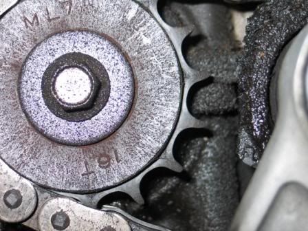

BigVeeGrin
Posts: 2521
Location: Glasgow
Re: Oh dear - rather worrying noise, pointers please
Post by BigVeeGrin »
First investigation and I guess I need a new chain and sprocket given the state of this!
would that be the culprit?
Posts: 22397
BVG, I agree, that sprocket is quite badly worn and I would replace it with a chain and sprocket kit. However it doesn't look like it's worn enough for the chain to be slipping on it, so I don't think that is your problem.
