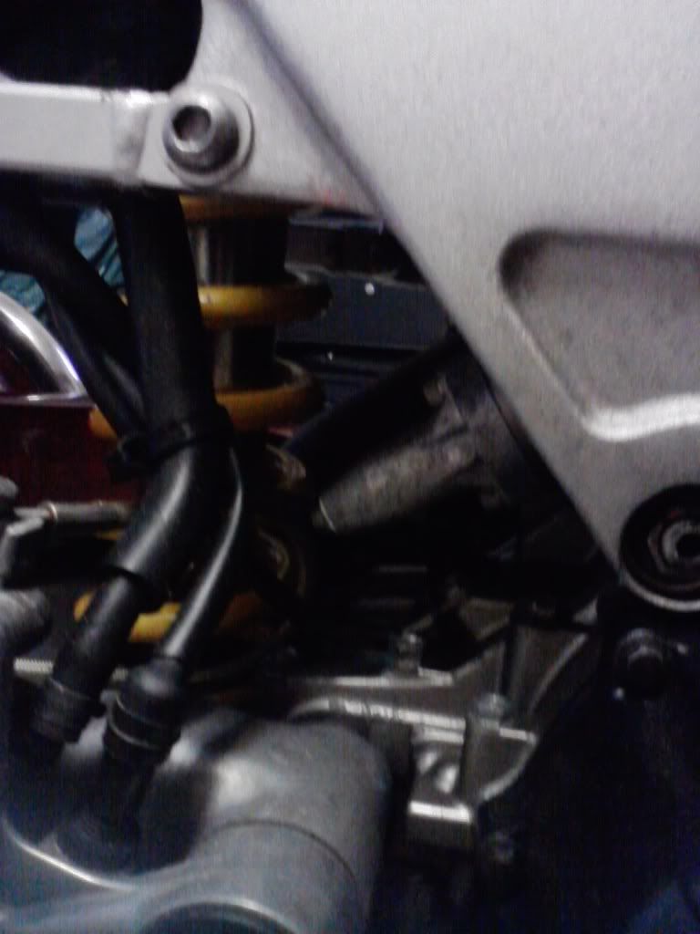

Hello, just bought a vtr, I've read about the cct problem a few times, but have a question. The last owner had them changed by the dealer it was bought from, less than 500 miles ago (receipt for it too), and now have these, which I'm presuming are standard type?Image
My question is surely now they've been replaced with new ones, Honda would have made them failsafe, after older problems and now not require manual CCT's?
Or is the consensus they're exactly the same - shite?
Any help info much appreciated

Honda wont admit there is a problem and have not made them fail safe so you either need manuals or do the stopper mod, btw not sure if its just the picture but they look like they have had a hard 500 miles :D

No, it's just a crap camera-phone!
