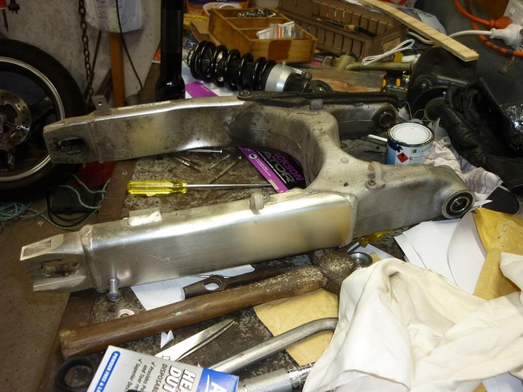

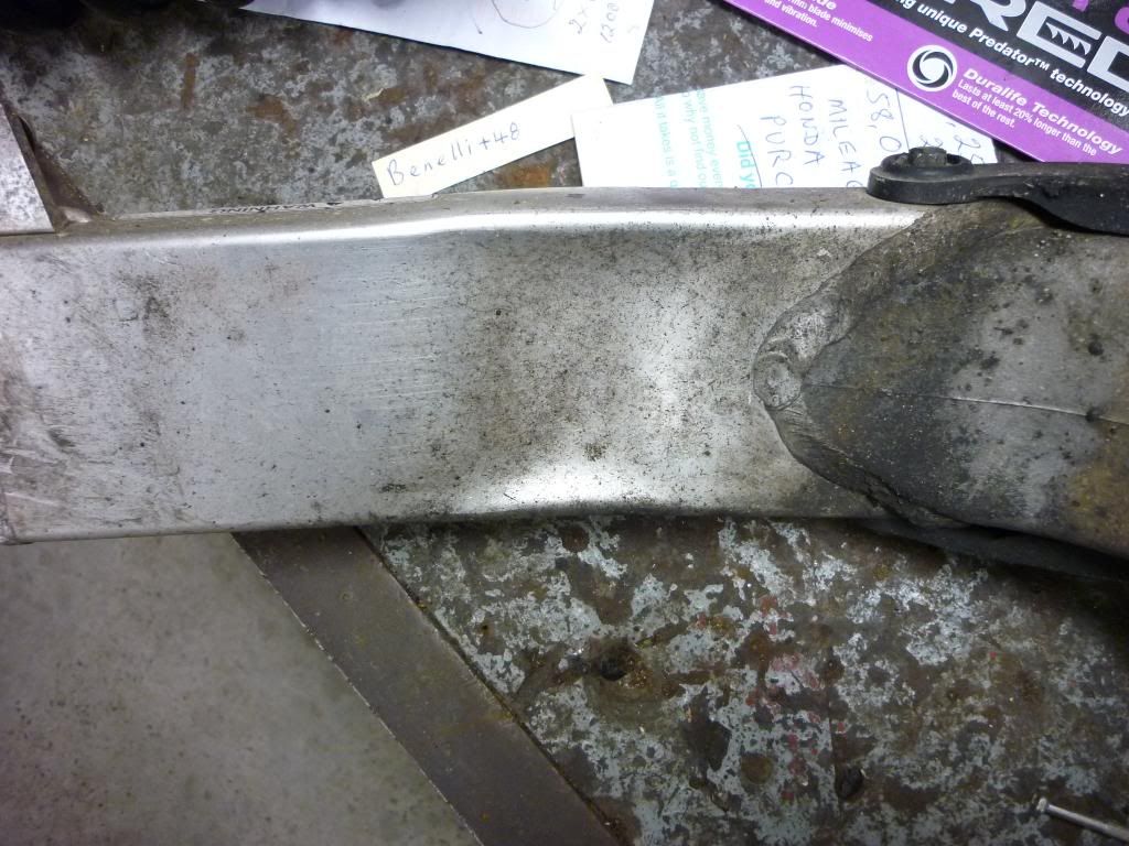

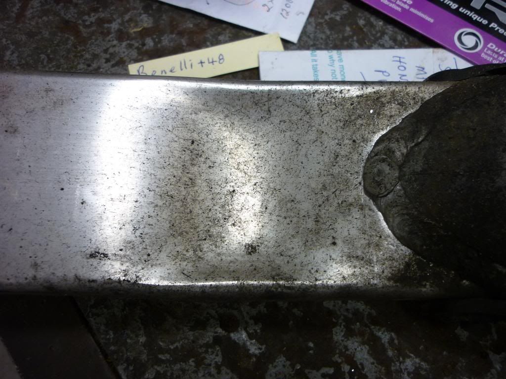

Also the swingarm has what appears to be a dent on the inside of the drive side alloy arm. See Pictures below. Is this damage and does it matter or is the arm manufactured this way for some reason?

swingarm dent is normal, that is how they are fabricated.

A bit relieved about the dent in the swingarm not being an issue. I can go ahead and clean it all up now and see where I stand with the top bracket modification.

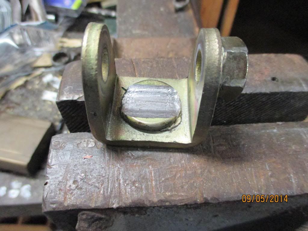

I seem to have solved my problem with the top bracket interferring with the top of the shock by having the center of the bracket milled in a concave shape to resemble the same curve on the top of the shock. See below:
I have yet to reassemble it all though as I am waiting on one of the bearings for the rear link that was difficult to source here in Australia.
This way I was able to remove metal to give the clearance required without weakening the whole "U" shaped bracket. If I had removed metal all the way across which would have been much easier it would have weakened the whole setup.
