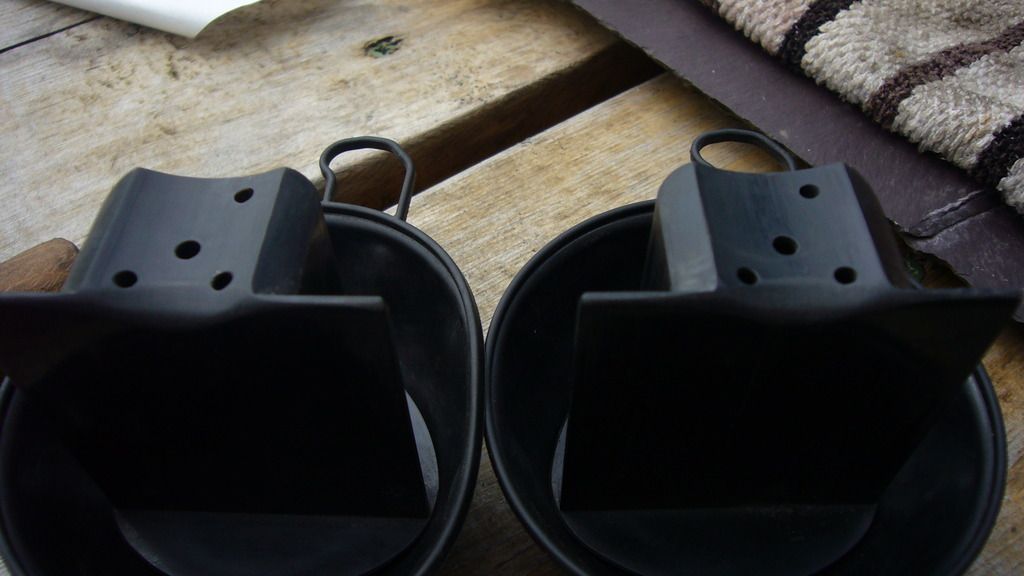

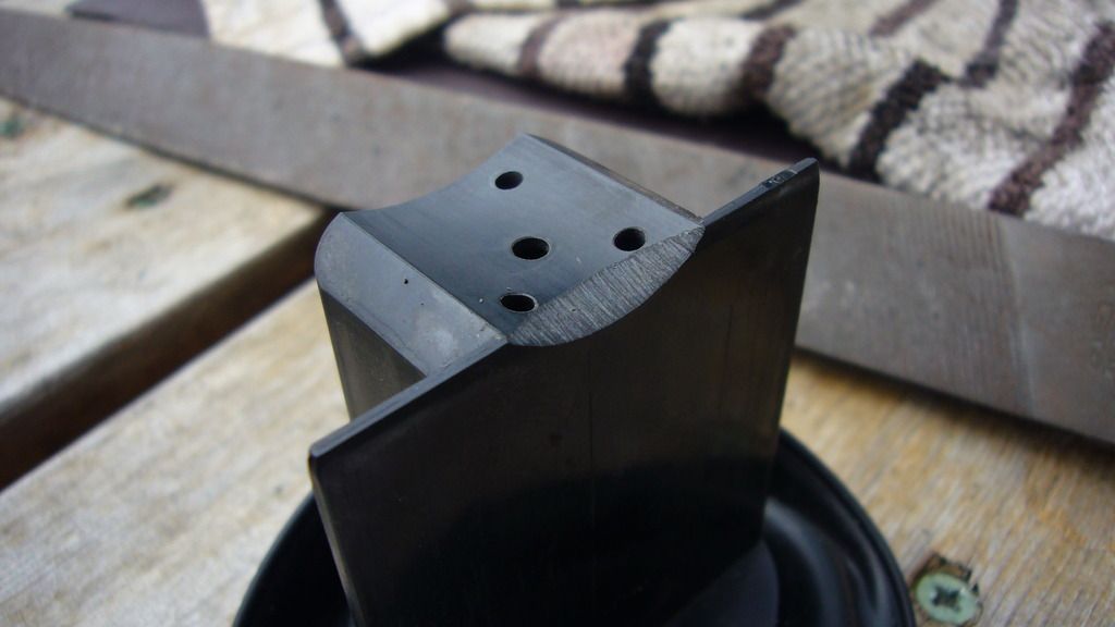

Here are the pictures 8O
This picture below, highlights the angle I used. It increased the leanness from 3500rpm, & cleared its self at 5200rpm.

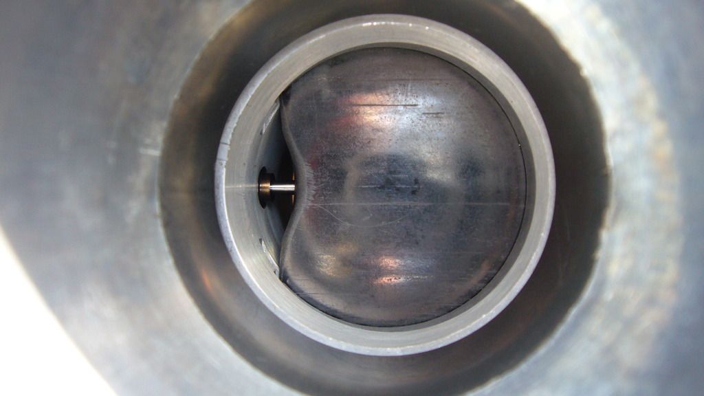

This is of one fitted.

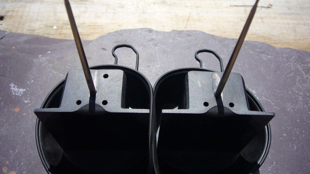

This is the pair lightly sanded.

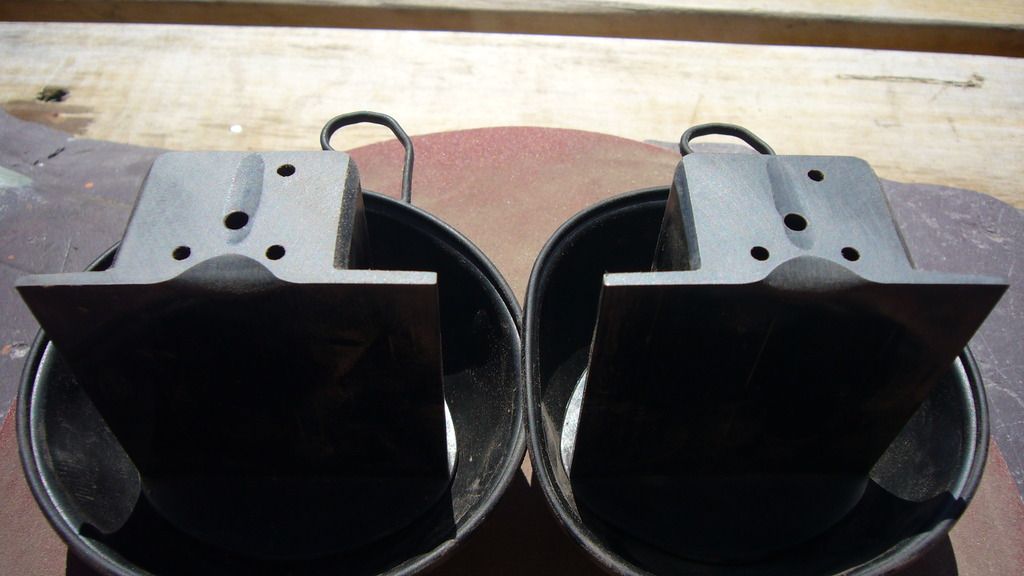

After learning what the above modification did, I decided to flat the slides down so there was no radius left & see what happened then.
The bike ran horrifically lean now, not even choke would help the issue at 4000rpm.
Here are the pictures.
