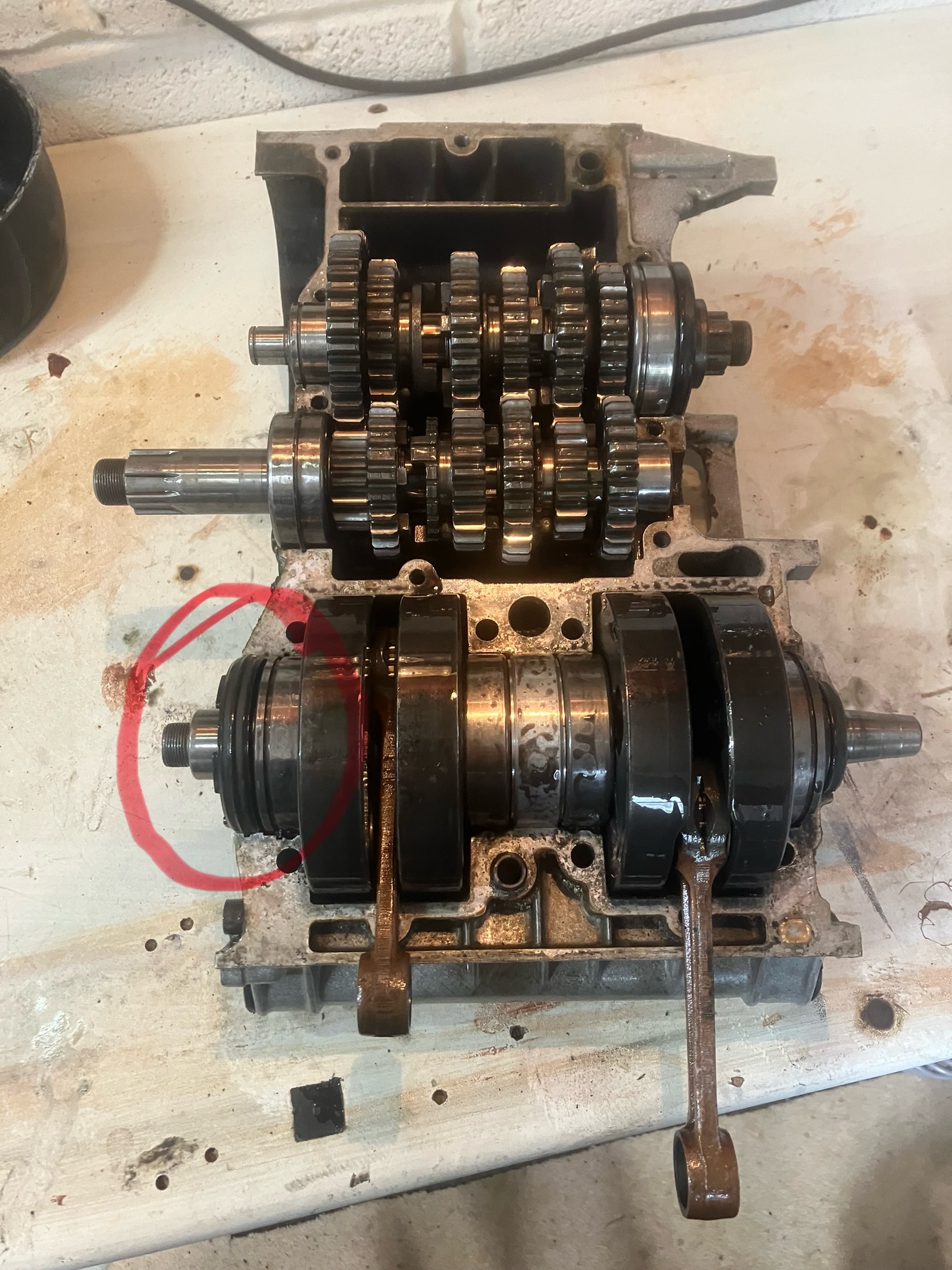

Well that might not be true! I posted the same photos on the RD forum and one of the guys spotted the oil seal on the clutch side of the crank is fitted the wrong way round in my disassemby photos (the castellated part should face the bearing aparantly. I obviously put it back together the same way it was when i took it apart! GRRR
Seal wrong
Seal wrong
so now I have to decide if it will be an issue in the short term and can I wait and fix it next time I am in there…….as I am sure this wont be the first time I have to split it to clean bits of piston out of the crankcase!
To my way of thinking the seal has to stop oil coming in from the gearbox side and stop air pressure (+ve and -ve) from the crank side and if the lip shape is fairly symmetrical, then it has to work both ways round, its not as if 2 stroke crank case pressure is that high that it is critical which side the spring is.
@fabiostar, can you post a photo of your crank seal before you fit it?
Re: The RD400 drag bike
Al mines the other way round :eek2 as in yours is the wrong way , god knows what difference it makes but urs is back to front.
the little castlations are to keep the seal away from the bearing face, or so iv always been told

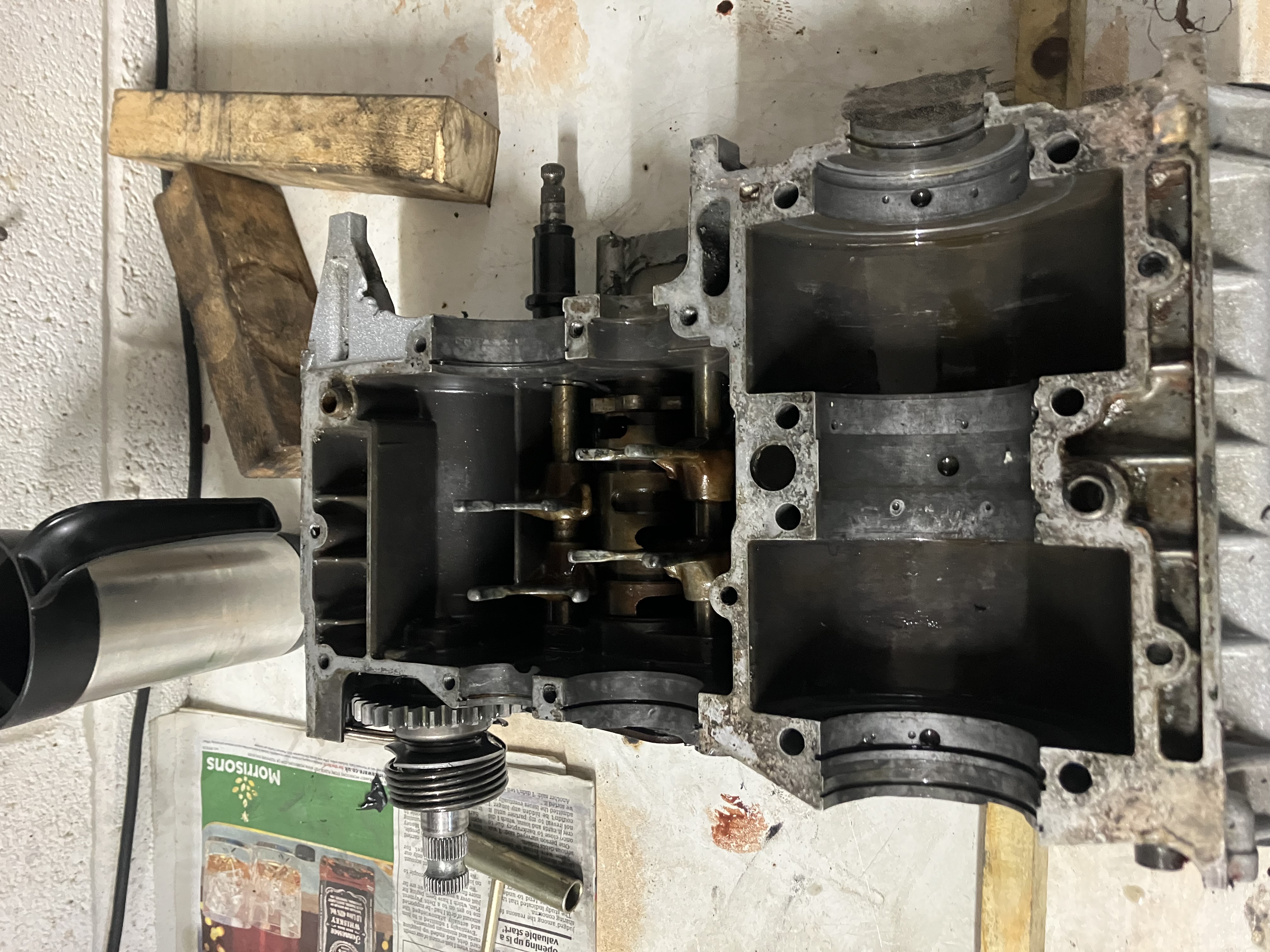

As I have a few days to wait i had a more detailed look at the crankcases.
I had spotted that there are a couple of the M6 crankcase threads near the back of the gearbox are starting to fail, so I will drill and helicoil them.
More interestingly, I also noticed wearmarks from the rotation of crank on the inside of the cases, more investigation showed that the crank has been welded up at the big ends, which is a good thing for a tuned engine…. Except they hadn’t bothered to grind back the welds, so that was what had been touching the cases. :o
so I masked up all the bearings and ground the welds back, then washed it all again.
also of note is that one big end is hollow and the other is solid, so the cranks are obviously a mix and match of parts from various generations of RD400. Not ideal for balance, but it will have to do!

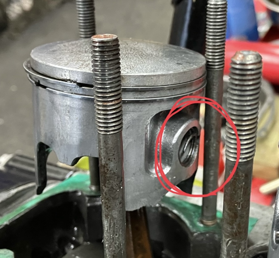

Oh and while I am commenting on bodges that I keep finding, here is a good one.
When I took the LH piston off, there was 2 circlips fitted on the inner side of the small end!!
That was a timebomb waiting to wreck the bore when it worked its way out
AMCQ46 wrote: Mon Mar 18, 2024 7:42 pm Oh and while I am commenting on bodges that I keep finding, here is a good one.
8O 8O
A good job you found that Al :thumbup: :thumbup:
Holy jesus that was proper lucky to find those clips :eek2
Great spot Al, that could have been costly
fabiostar wrote: Tue Mar 19, 2024 7:23 pm Holy jesus that was proper lucky to find those clips :eek2
Better two than none.
If there was room for two, is the gudgeon pin shorter than it should be- is one just a spacer?
