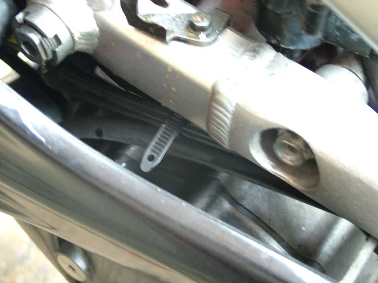

Just spent lunch trying to work out why the engine cover won't fit and it looks like someone's run the loom through the clip that supports the fuel line to the front carb. At least that's what I think is wrong from memory, it was driving me mad last night trying to work out why the cover wouldn't stay in place on the left. Carbs back on this weekend I hope.
I know what your talking about.Yeh that loom should run on the underside of the bottom spar on the frame. The only wiring near that clip is what goes to the thermostat. The clip is only for the fuel line. I took mine off as it become something else to do when removing the tank/carbs. No need for it really.looks like someone's run the loom through the clip that supports the fuel line to the front carb.

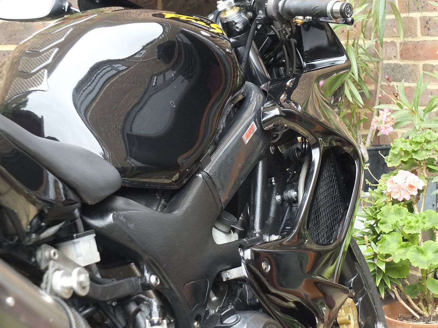

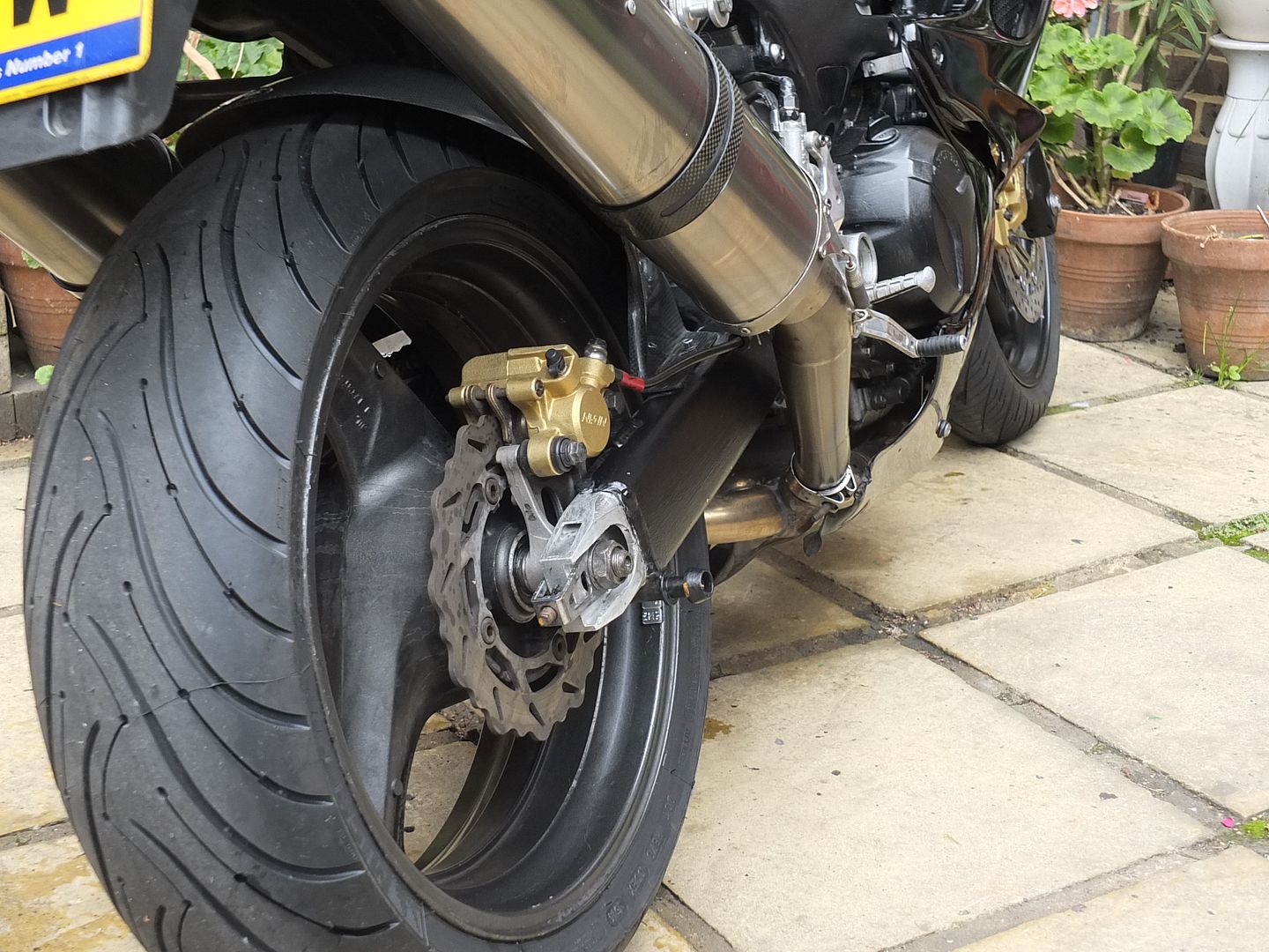

I washed and waxed it.
1 coat of Bilt cleanser polish
1 coat of Finnis
1 coat of Hydra
And a bit of WD 40 on my cans and a few other bits.
1 coat of Finnis
1 coat of Hydra
There's a smear on the r/h can Carl...
Shoddy work not impressed...
