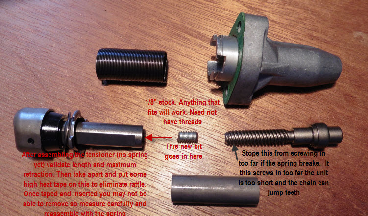

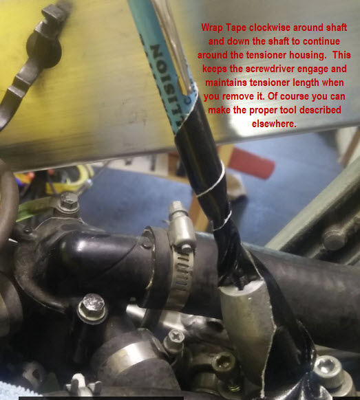

OK, I am a New VTR owner from Seattle. It's a 17,000 mile Red 1998 in decent but ignored condition. I've just completed the stopper mod on the front cylinder. The existing stock CCTs have a red dot (that mean anything?). I'm doing other operations at the same time so Tank, Carbs, and both valve covers are off. The Access plates on left side for crank and reference marks are removed. Instead the special tool to secure the CCT we used a screw driver and tape. DON'T follow my path until some senior members have a look at this. I had trouble following the drawings but understood the objective and made this up.
Here is the screwdriver and tape trick for holding the length during removal. 1/2 turn took away tension. This may not work on the rear CCT because oil drips out:
screwdriver trick.jpg (71.38 KiB) Viewed 23386 times

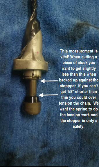

Here is the unit as removed with screwdriver taped to hold position. The measurement shown, FOR YOUR BIKE is vital.
CCT Removed.jpg (72.96 KiB) Viewed 23386 times

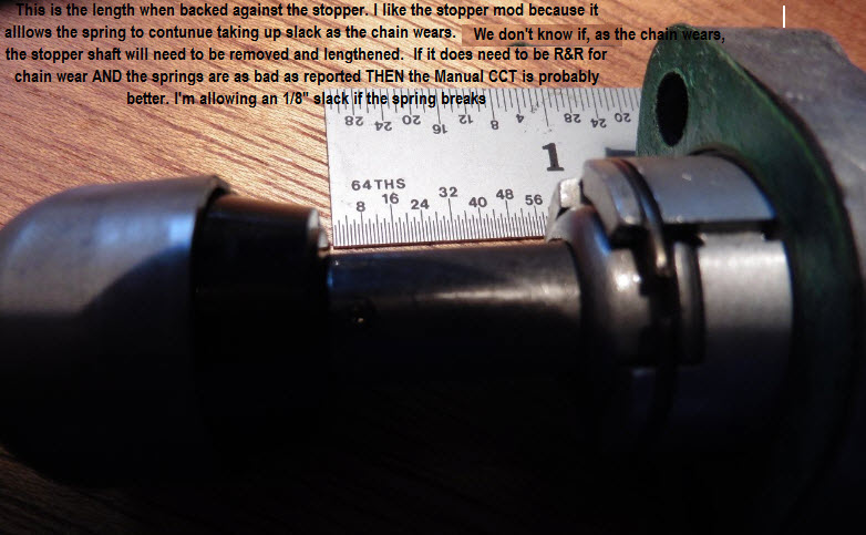

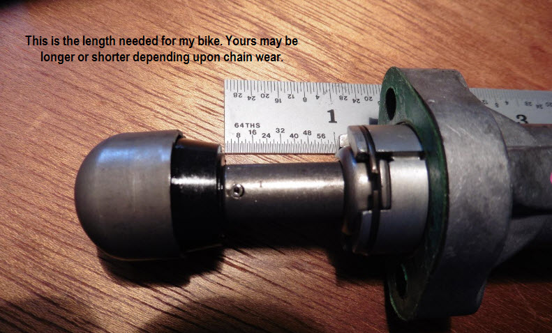

Here is how I did this. Comments welcome. I have not yet re installed. Yes, I will turn the engine by hand and check tension and also make sure I can get a 1/2 turn back for safety of chain. When Assembling the final time after measurments are verified, engage the spring before winding. This is a bit like a pull cord in a lawnmower. Make sure the assembled unit springs the tensioner out
CCT detail.jpg (147.49 KiB) Viewed 23386 times
Desired length for my bike
Retracted "Spring Broken Safety Length"

First of all welcome to the forum :thumbup:
Personally I would rather a locking key (such a title for a piece of tin plate 1mm thick :lol: ) was used, as IMHO your screwdriver could turn without you realising it with only sticky tape holding the tension from the spring, that would mean your measurements would be out. I know with you checking your measurements with the ruler that would show up, but if it is out you will have to refit the CCT and start all over again.
If I have got this right, you have fully stripped the CCT for access of fitting the spacer rod (in your case a threaded bar). The reason I suggest you knock out the plunger pin (roll pin) instead allowing you to remove the plunger head to fit the spacer rod, that leaves the spring set at the correct tension as set at manufacturing, note the spring is pre-set on assembly. The problem you have now is knowing how much tension is needed to be put on the spring when you reassemble the CCT workings, so the correct tension is applied to the cam chain.

A check would be how long a new section you needed- it's usually around 11-12mm.
Good write-up, but it's hard to read the red writing!
