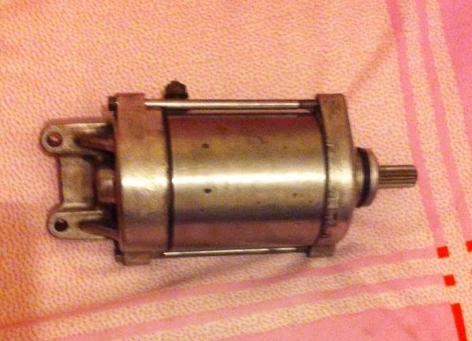

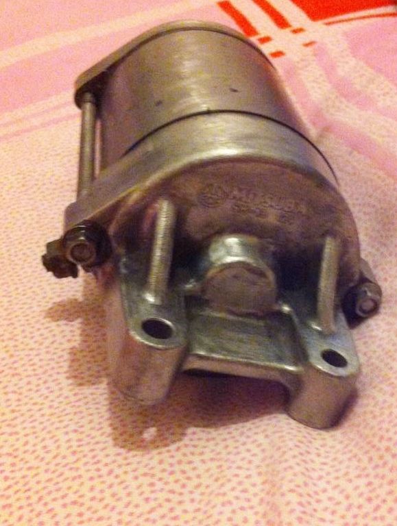

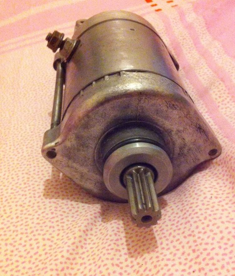

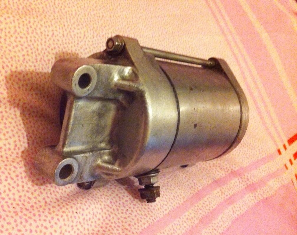

very productive day today, I've been tinkering with starter motors, I have two that were worse for wear, then greeneyedgecko aka Christine very kindly sent me here old starter motor, completely free of charge, thankyou again Christine.... :thumbup:
so I set about making one good starter from the three, I found that two of the three main cylinders had minor damage on the inside, just below the hole that the main bolt passes thru.
other had the odd perished seal, I even had to cut the two long bolts off of Christine's starter as they had seized on.... 8O
with the help of carl I managed to figure out an easy way of getting all the magnets in place, what a tricky job until carl showed me.
the proof will be in the pudding, I plan on putting this starter on my bike and then checking out the condition of the starter that comes off.
sadly I have no before pictures, just the finished starter.

Good work Marty, your gonna be in the crap if thats your duvet though Matey.
bigtwinthing wrote:Good work Marty, your gonna be in the crap if thats your duvet though Matey.
not mine mate, it's my nan's....... :shh:
don't tell her or i'll be in the sh1t...... :lol: :lol: :lol: :lol: :lol:
Nice one Marty, just needs a paint to make it look good :lol: :lol: :lol:
I tried to do one last year and through it at the wall ! Them magnets are a right pain in the butt to fit back in so well done Marty :clap: :thumbup:
