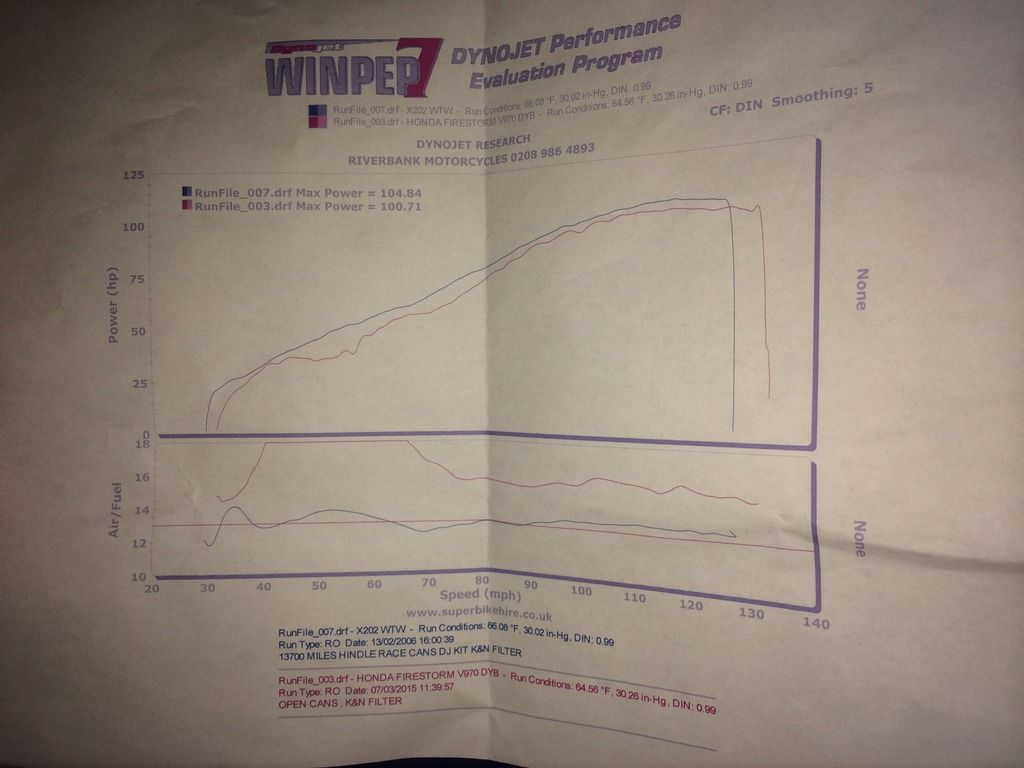

Fitted my dynojet kit earlier :D
Was running stupidly lean, check out the printout below for a laugh (I'm the red line)
Need to get it re dynoed next weekend to fine tune it

That's not good !!!
Them k&nfilters really feck things up .
I'm off to the Dyno on the 28th and hoping mine is on the rich side to begin with .
