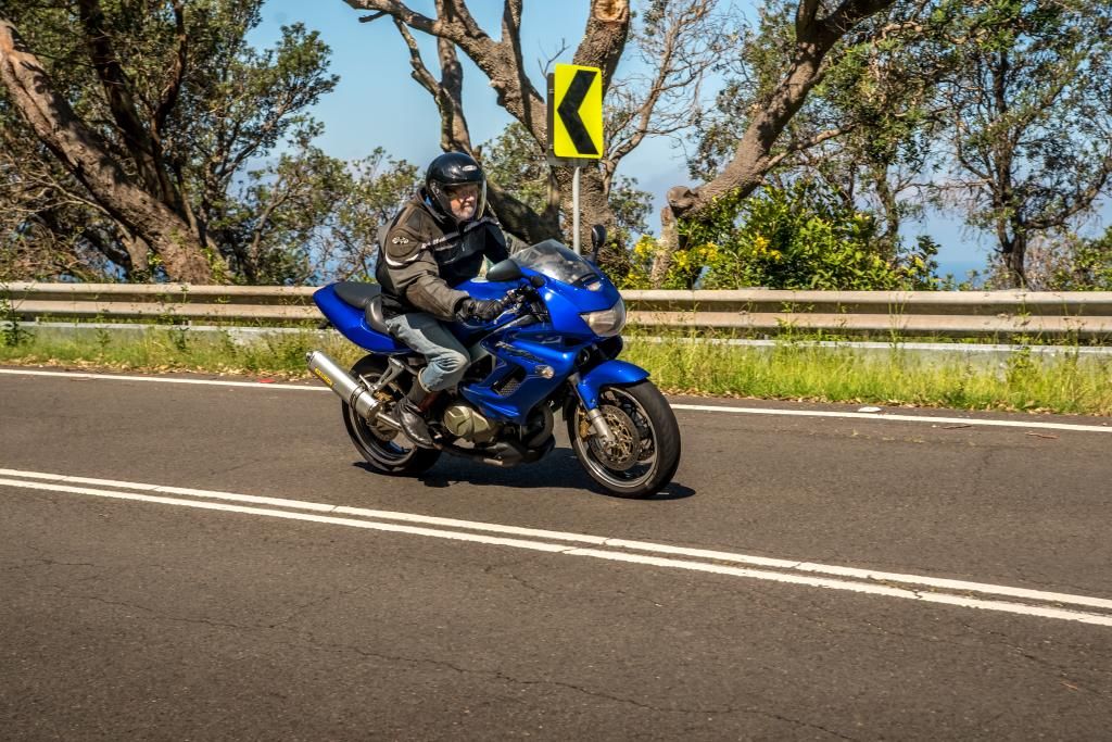

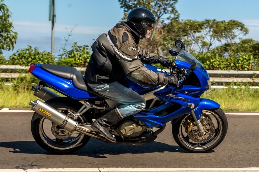

Just as an indication I bought my VTR '03 model last March with 58,000km on the clock. It turned over to 60,000km a few months ago and I did the big 60,000km service on it including new oil and filter. This motor is as fresh as. It goes like a rocket, no smoke or any indications of any wear on anything to do with the motor. It is worth checking the rear dog bone and the needle rollers in there. They are very suspect to water ingress and deterioration -- mine were in a disgusting position. You will also need to do some research and make a decision on what tp do with the cam chain tensioners. Do a search and you will see the options. I did the "stopper mod" and am happy with the results. The tensioners works as it was designed to with a safety element built in.
I would say at 60,0000km your motor is just run in if my motor at the same mileage is anything to go by.

My 03 is the same colour!

Downunder,
DON'T EVER, EVER MENTION COLOUR ON HERE. You will start a debate that will go on for months. NO, NO, NO :cry:
Some people on this forum think that the colour of a VTR relates to speed. I never really got it from a mechanical or scientific point of view.
