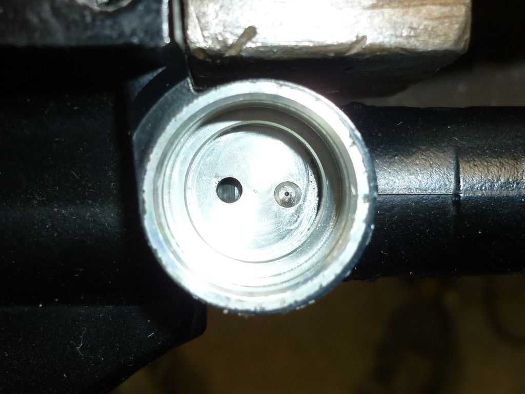

Re: Brake caliper service question.
Chris, see picture below:
You would need to remove the reservoir, rubber pipe and connector to the M/C. This could be a bit messy, use plenty of rags around the M/C to protect the bike.
Using a steel bristle from a steel bristled brush stuck into the end of a matchstick poke the wire through the small hole and while working the piston back and forth wiggle the wire around inside the small hole to clear it of any muck.
Good Luck.
Good Luck.
thunderbolt wrote:Chris, see picture below:
Good Luck.
Don, many thanks for the photo
I actually got around to putting the front of the bike up on the paddock stand today. I can only get approximately three quarters of one full turn when giving the front wheel a good hard spin, so not good
Cheers,
Don, I have now removed each caliper in turn to see which caliper is binding, it's both of them not just the one.thunderbolt wrote:Chris remove each caliper in turn and give the wheel a good spin and see if you can work out which caliper is at fault.
If you probe gently with the match stick tool you should be able to detect if it is touching on a soft material (rubber) or a harder material (aluminium).
Before I either remove the calipers to pull apart again, or before I check the relief hole, I'm going to open one of bleed valves on the calipers and see if the wheel then spins free. My way of thinking is, if it doesn't change anything then it must be something to do with the seals. If the wheel then spins free then I will go about checking the relief hole.
Thanks for getting back to me on the piston seal information when using the matchstick tool
