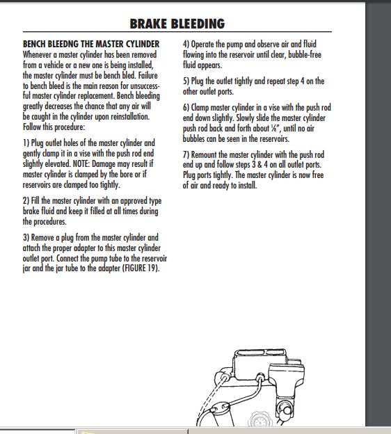

as you can see in this instructions sheet, new cleaned parts reserve as rule problems of bleeding..
