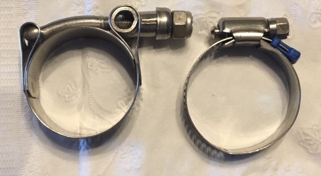

And perhaps I've used different T bolt clamp types then you have seen, but all I have on hand and used open up just fine to clear the tube size they are bought for. No bent clamps, kinked or otherwise.
T bolt open.jpg (46.92 KiB) Viewed 2612 times
Once you unscrew the adjustment nut, the "T bolt" swings out of the way and gives you an open section to the clamp.

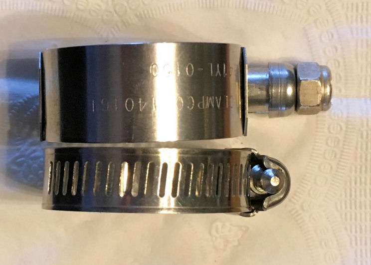

Bulker? Ya I suppose so... to me its fine as I know what the benefits are and the "bulk" screams quality precision, no damaged hose buy the clamp band holes (I use a lot of silicone hose, can not use standard worm gear clamps on those at all) and just "better" but to each his own.
And that "bulk" means wider clamp area so Im good with that as well.
But for sure the common use of worm gear clamps to hold things together, "mount" an accessory, "repair" a broken thing, tightened end till the hose is oozing out the clamp band hole
