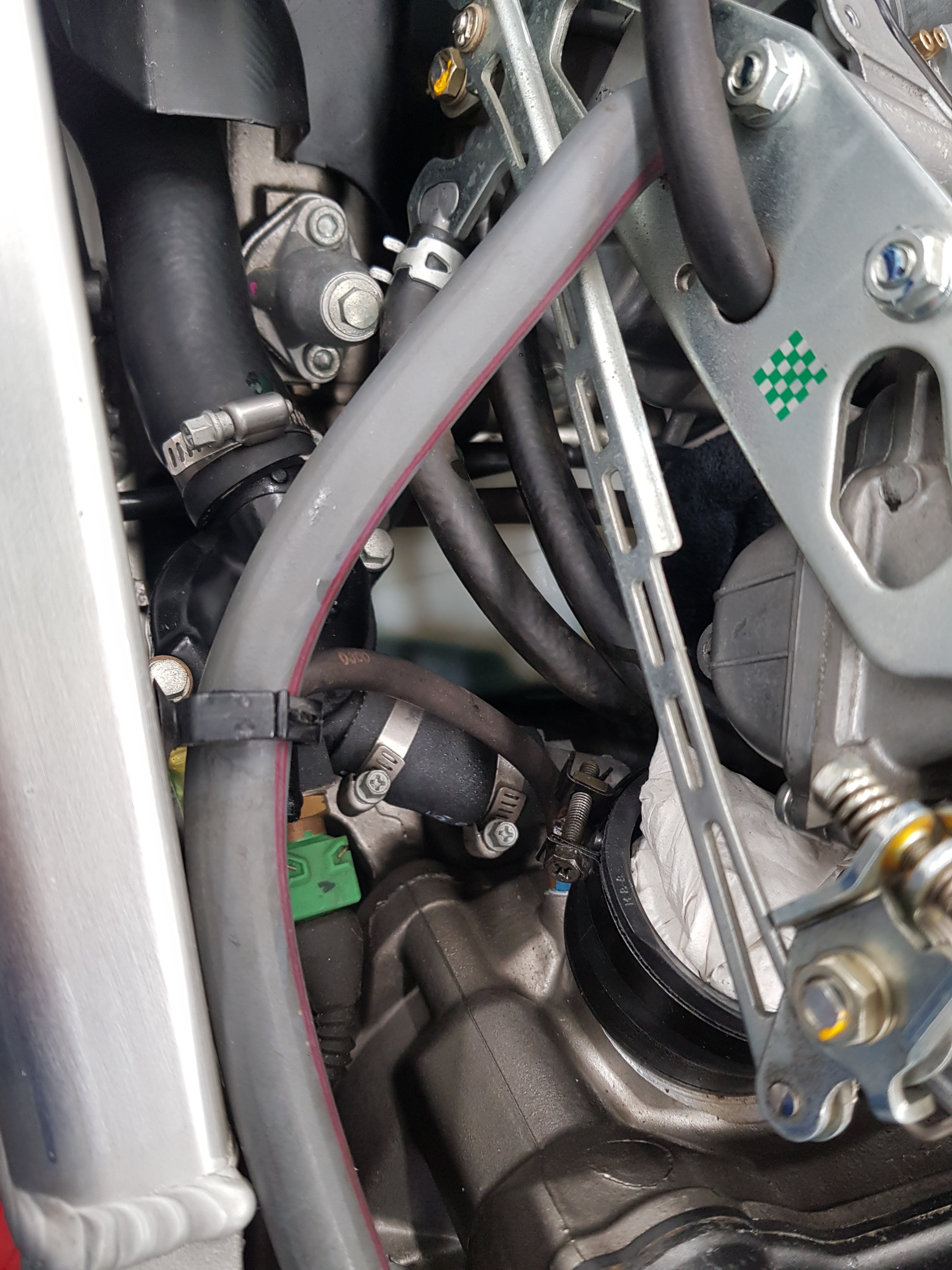

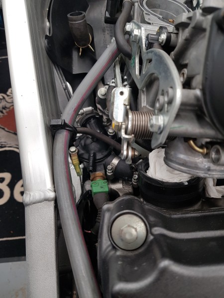

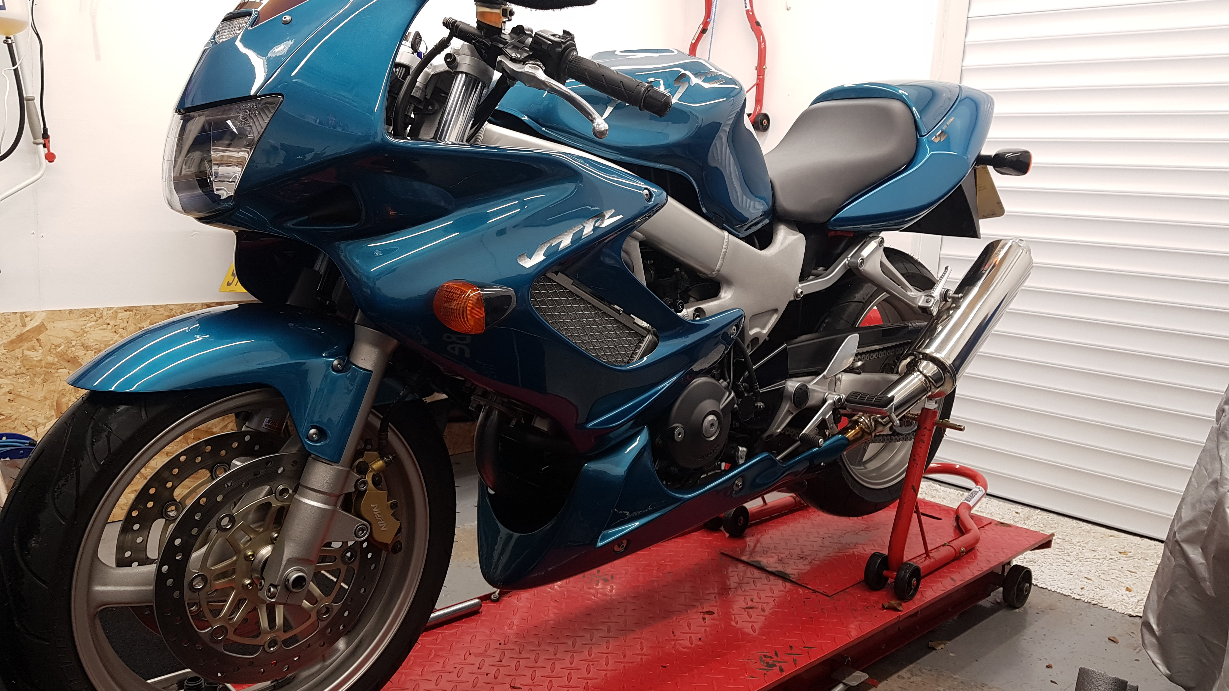

. Couple of pictures to ponder over.

wow!
Was it kept in a vacuum bag? That's spotless

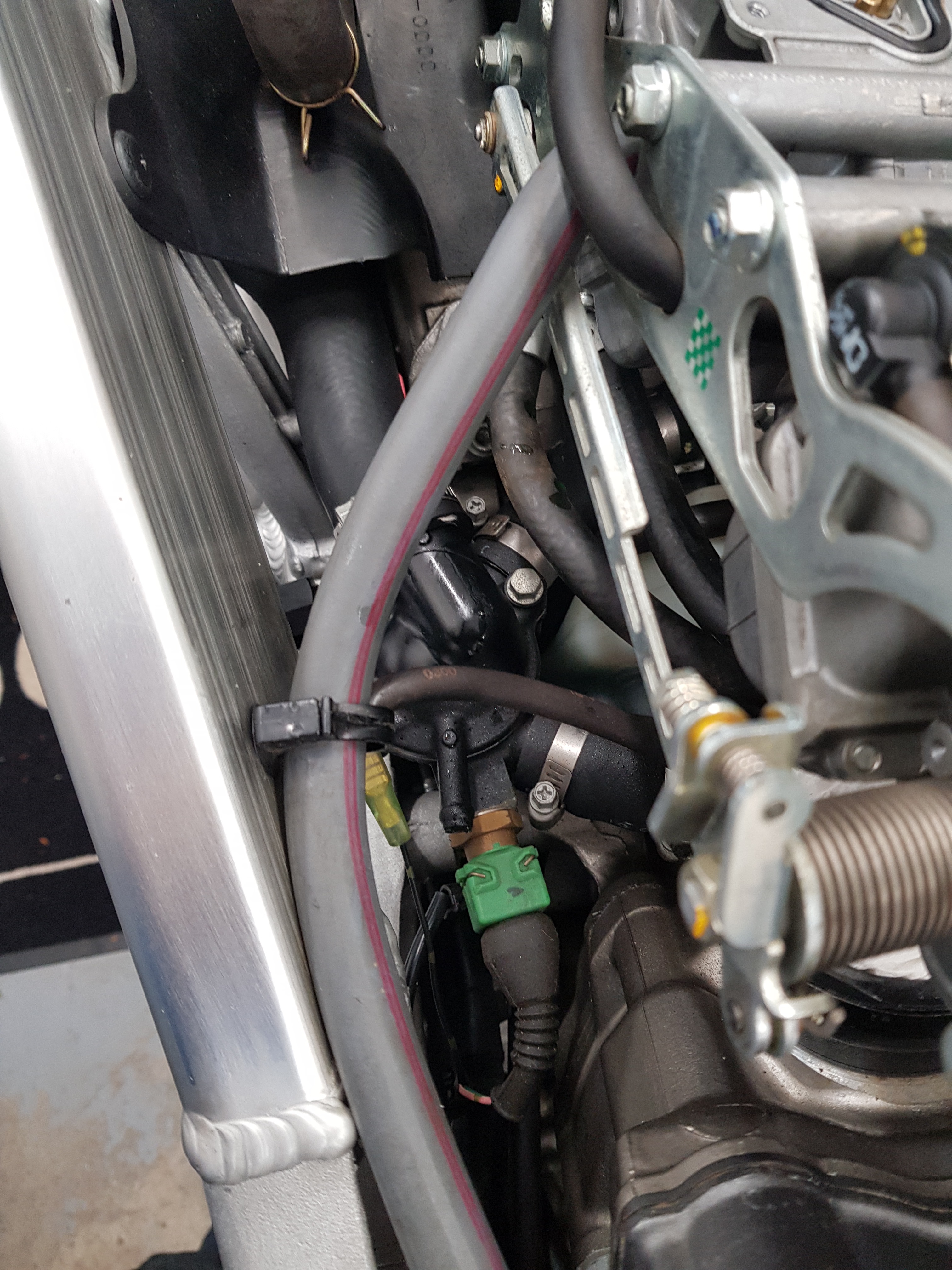

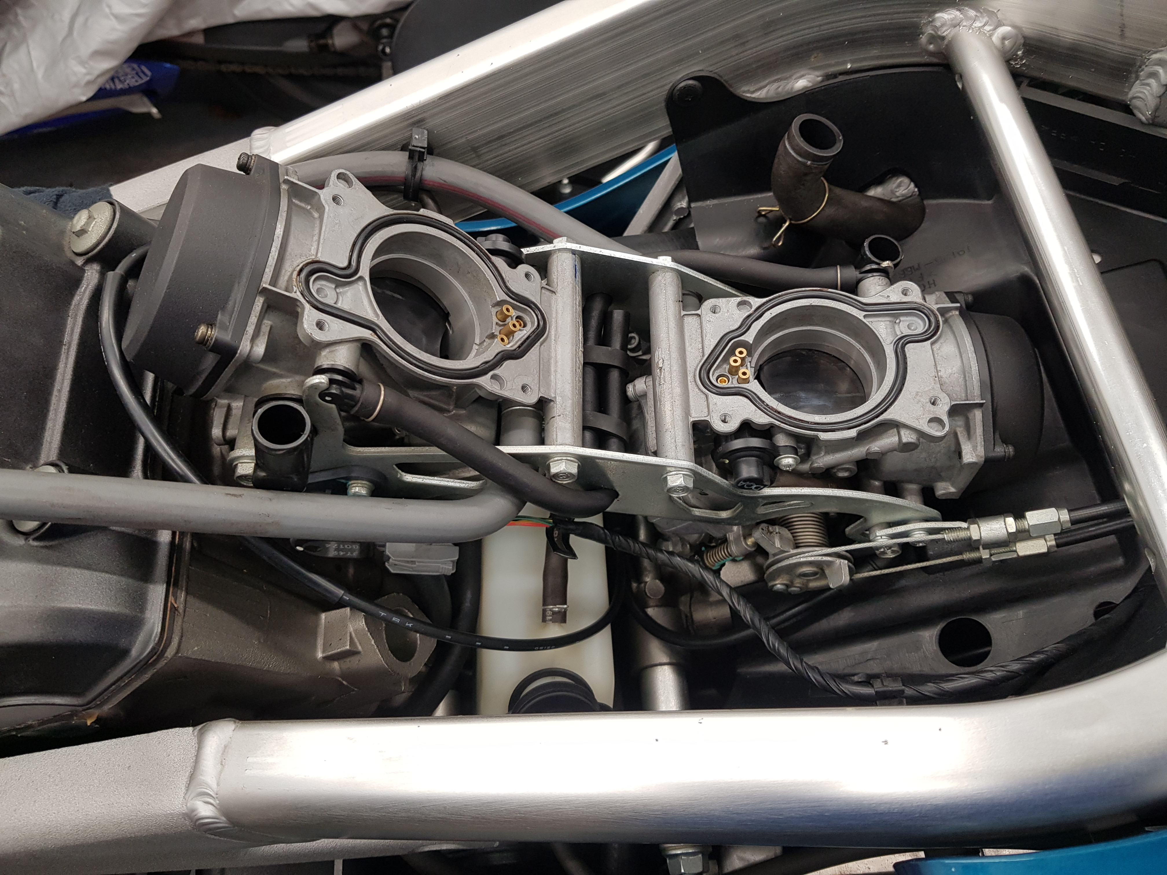

Very clean bike, Are you changing the cam chain tensioners while you have it apart ?, It would be a very wise move. Bazza on here dose them.
For the brass takeoff contact "Morgan carb tune" online (link below) and they will sell you a pack of 4, they are cheap and then you can pass on or sell the other 3 when someone else needs one, there are 2 sizes just check the thread on the grub screw as I can't remember which size you need,

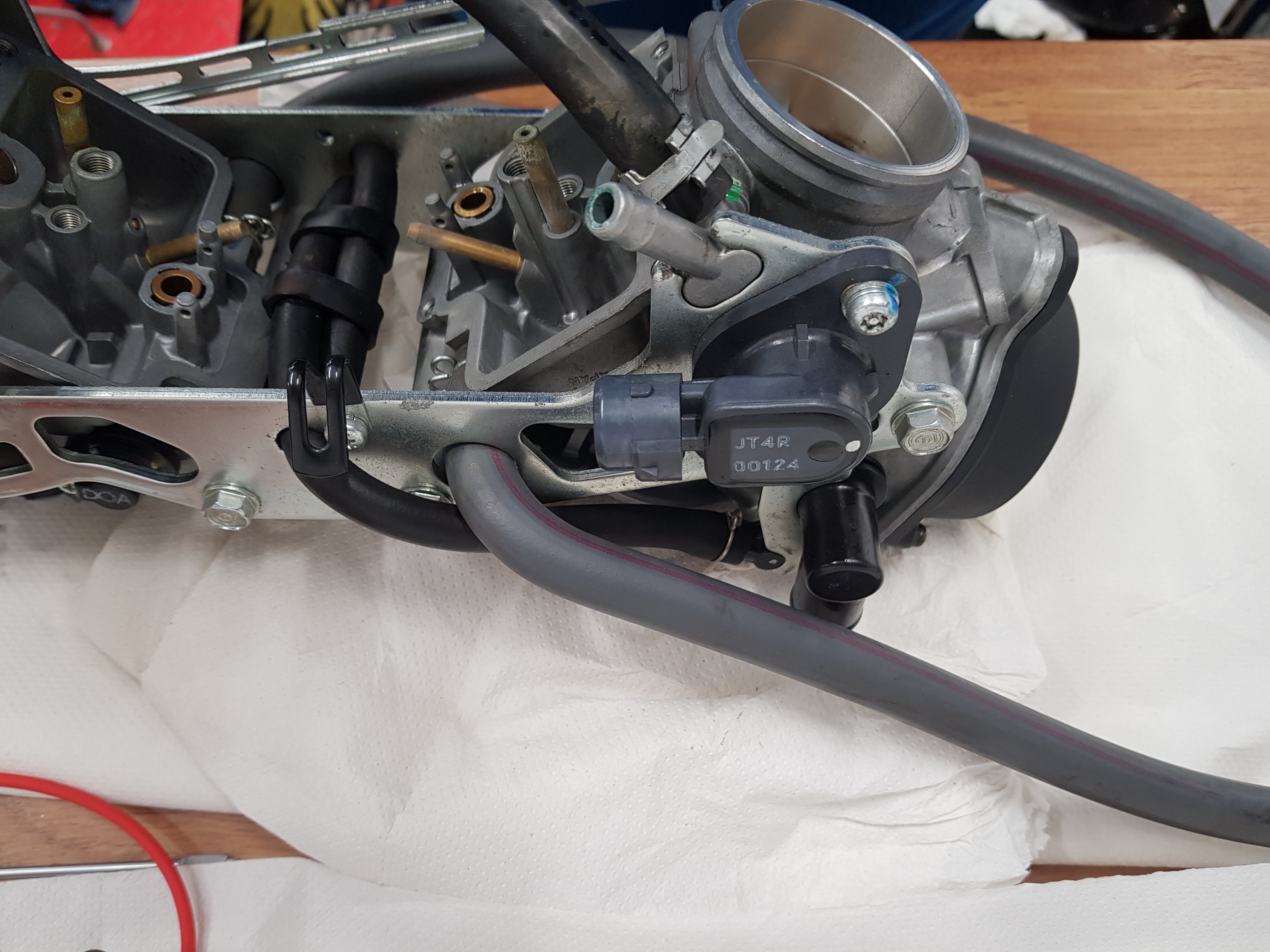

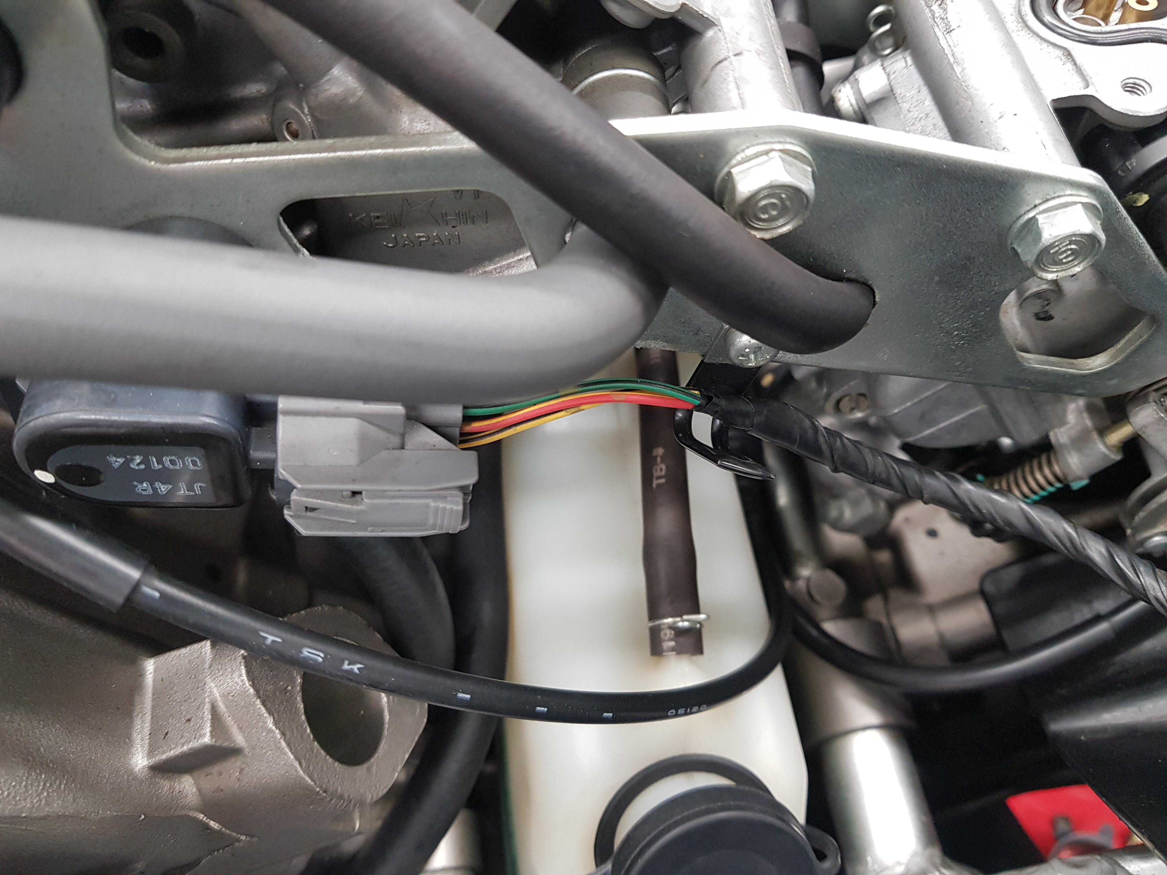

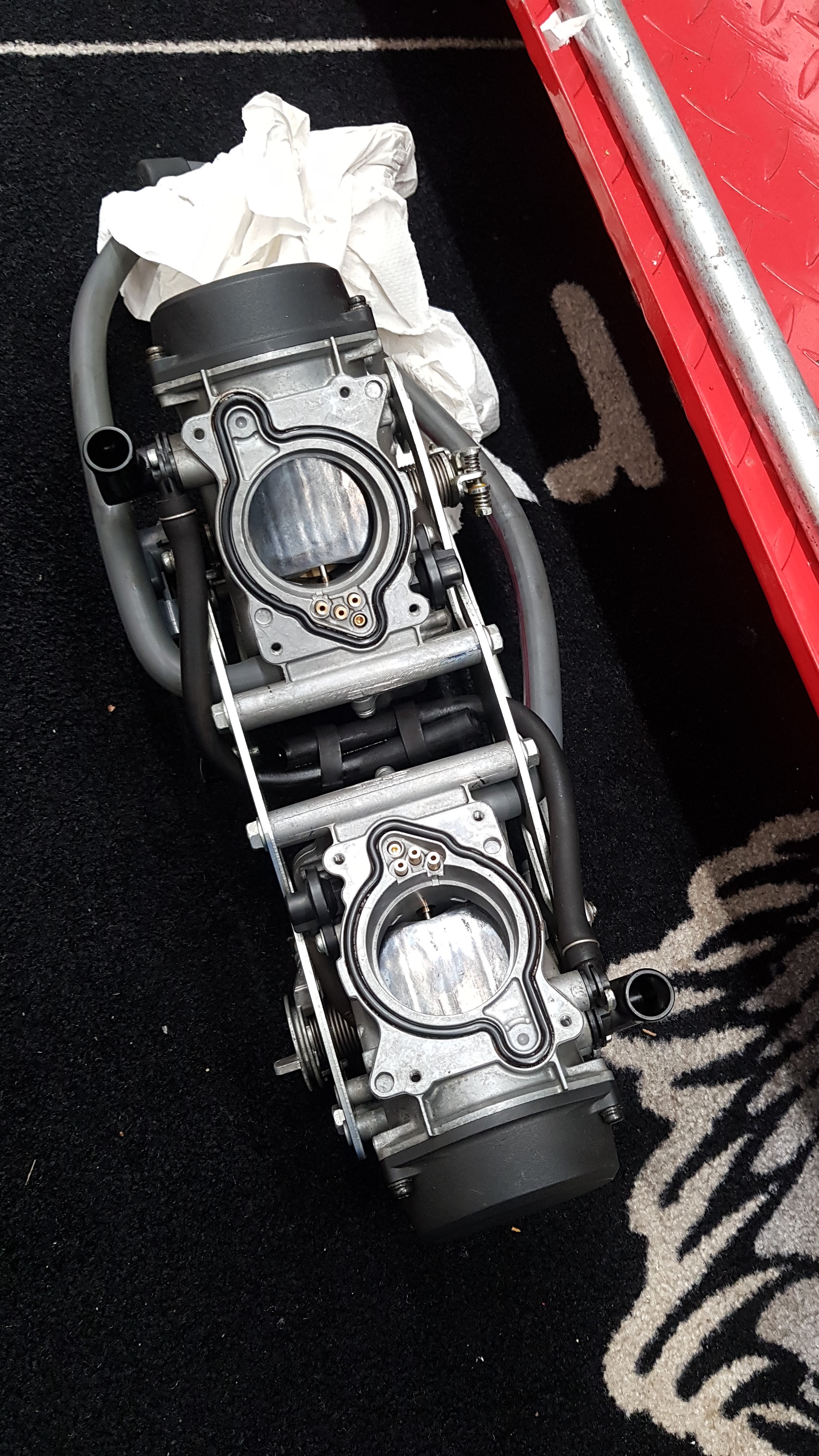

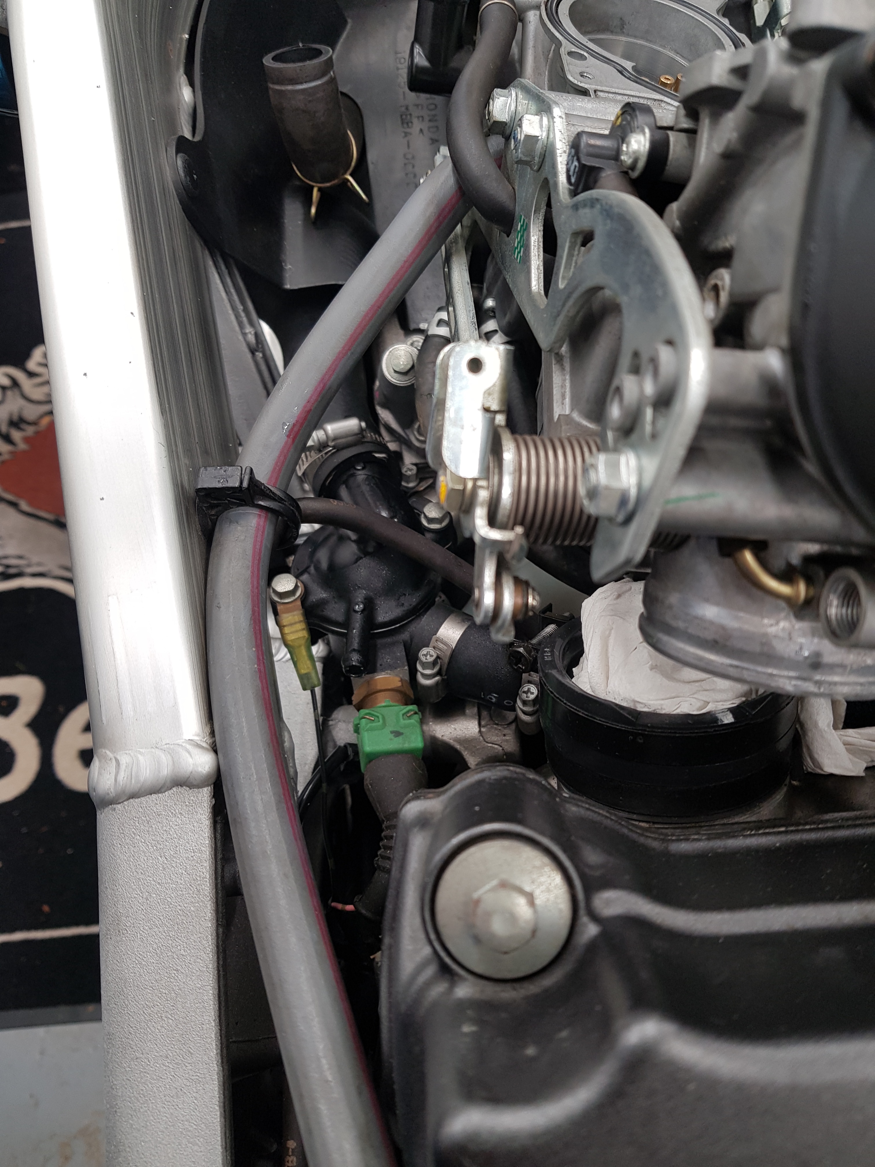

I do believe the bike was in padgetts for a number of years untill they decided to sell it and believe it or not iam the 8 owner the others obviously did not use it. My son collect the bike and when he road it back he said it was at awful low speed ,so hence the reason for the carb strip down and clean. Iam going to adjust the tps as the reading was 860 ,I have also ordered a brass fitting to sync the carbs just waiting for that to come , not going to bother with the cam chain adjuster at the moment.

Your choice on the tensioners but they are known to fail, mileage means nothing (could even be more likely to fail) and if they do fail you'll probably be rebuilding the engine, £50 and a bit of time will avoid any troubles, would be such a shame but it happens fairly often.Vfrjohn wrote: ↑Wed Dec 29, 2021 11:50 am I do believe the bike was in padgetts for a number of years untill they decided to sell it and believe it or not iam the 8 owner the others obviously did not use it. My son collect the bike and when he road it back he said it was at awful low speed ,so hence the reason for the carb strip down and clean. Iam going to adjust the tps as the reading was 860 ,I have also ordered a brass fitting to sync the carbs just waiting for that to come , not going to bother with the cam chain adjuster at the moment.

My VTR ran like a dog at low revs farting and occasional stumble/stalling purchased a secondhand set of carbs set TPS on these could only get to 520 ohms, cleaned and carb synced now runs a treat. TPS is well worth it, before adjustment mine was 860.Vfrjohn wrote: ↑Wed Dec 29, 2021 11:50 am I do believe the bike was in padgetts for a number of years untill they decided to sell it and believe it or not iam the 8 owner the others obviously did not use it. My son collect the bike and when he road it back he said it was at awful low speed ,so hence the reason for the carb strip down and clean. Iam going to adjust the tps as the reading was 860 ,I have also ordered a brass fitting to sync the carbs just waiting for that to come , not going to bother with the cam chain adjuster at the moment.

Please think long and hard about the CCT’s. Age, storage and low mileage are common ingredients for failure, particularly the front.

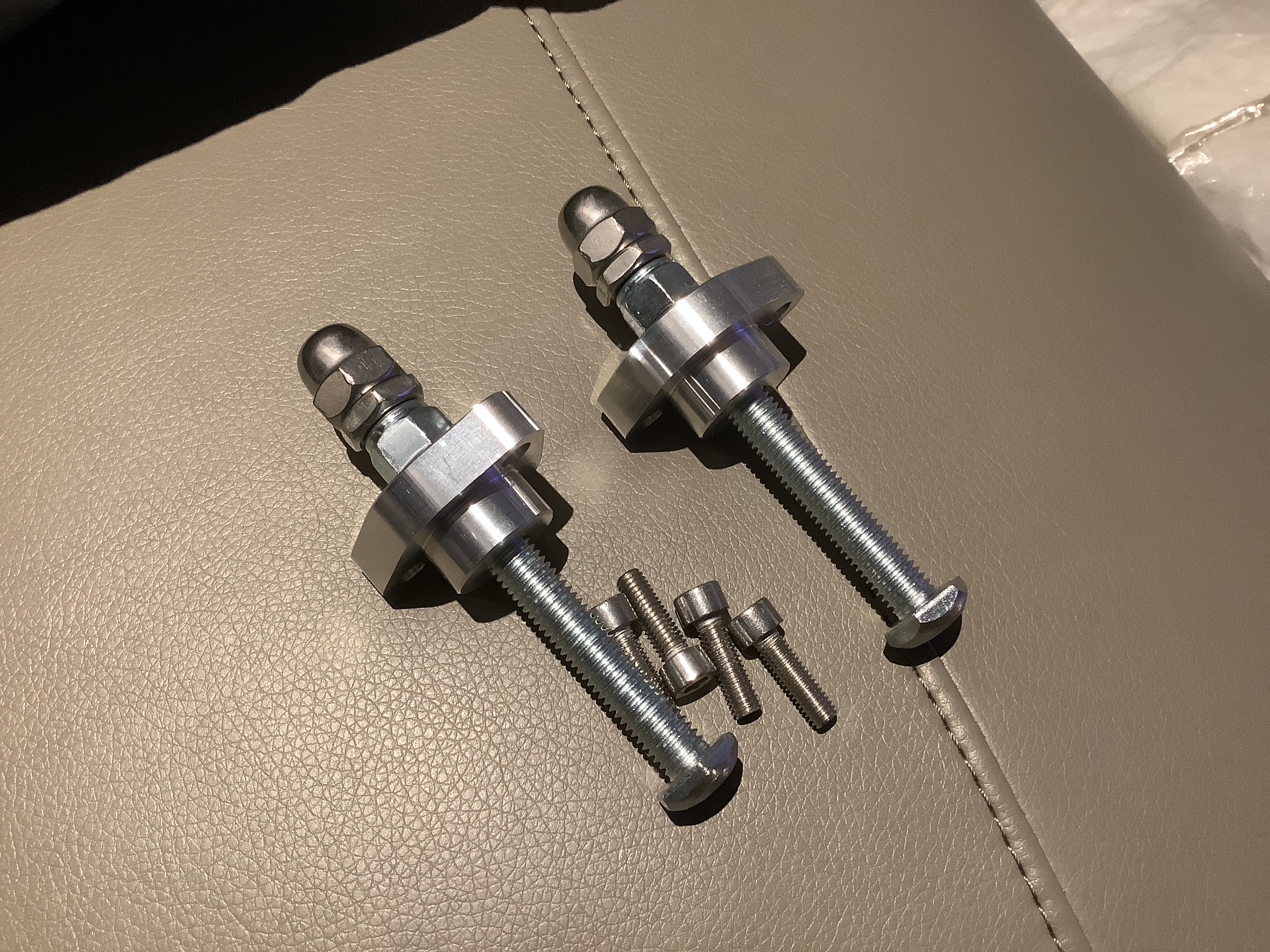

Warning Don't just whip the old tensioners out, you need this :
Here (as long as you can use a spanner) is a fool proof guide to fitting manual tensioners, someone wouldn't go to all the trouble of writing this if it wasn't an issue, look how many pages the thread has.

Well just been to my sons and he said there’s a big with a couple of bits in it and look what I found.

Thanks for posting the photo's of your bike, almost unbelievable condition for it's age. It certainly has been extremely well looked after.

I bought a bike very similar history as yours.It had been laid up for years with only around 4000 miles with mot history to prove it.Almost the very first thing i did was to change acct's to manuals for peace of mind.As said on here you are half way there with the carbs off and you have the mcct's already.Really it's a no brainer.
