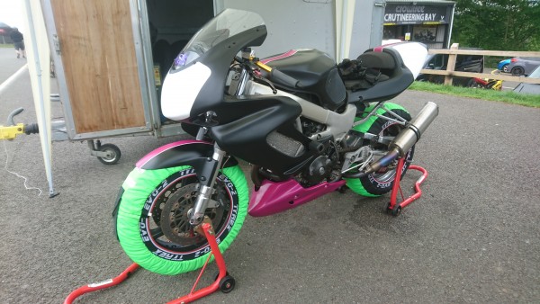

It had its first proper thrashing yesterday but it was a bit hit and miss.
To get there I still had to add spacers and extend some of the belly pan brackets Mac sent. The race Mori belly pan clearly works best with the stage 2 exhaust and cut away sump. Still, it looks OK and mounts higher which meant no scraping on the tarmac. Bleeding the brakes took forever. No idea why, I've not had a problem before. And I replaced the chain link as well as set the forks up.
The misses:
It fell over when I was setting up the evening before. Fortunately the only damage was to already scratched crash bobbins and bar ends.
Stripped a thread on a case bolt. Not the bolt but the engine. A longer bolt got me going again but I'm not sure how long that will last. Might get it helicoiled at the next oil change.

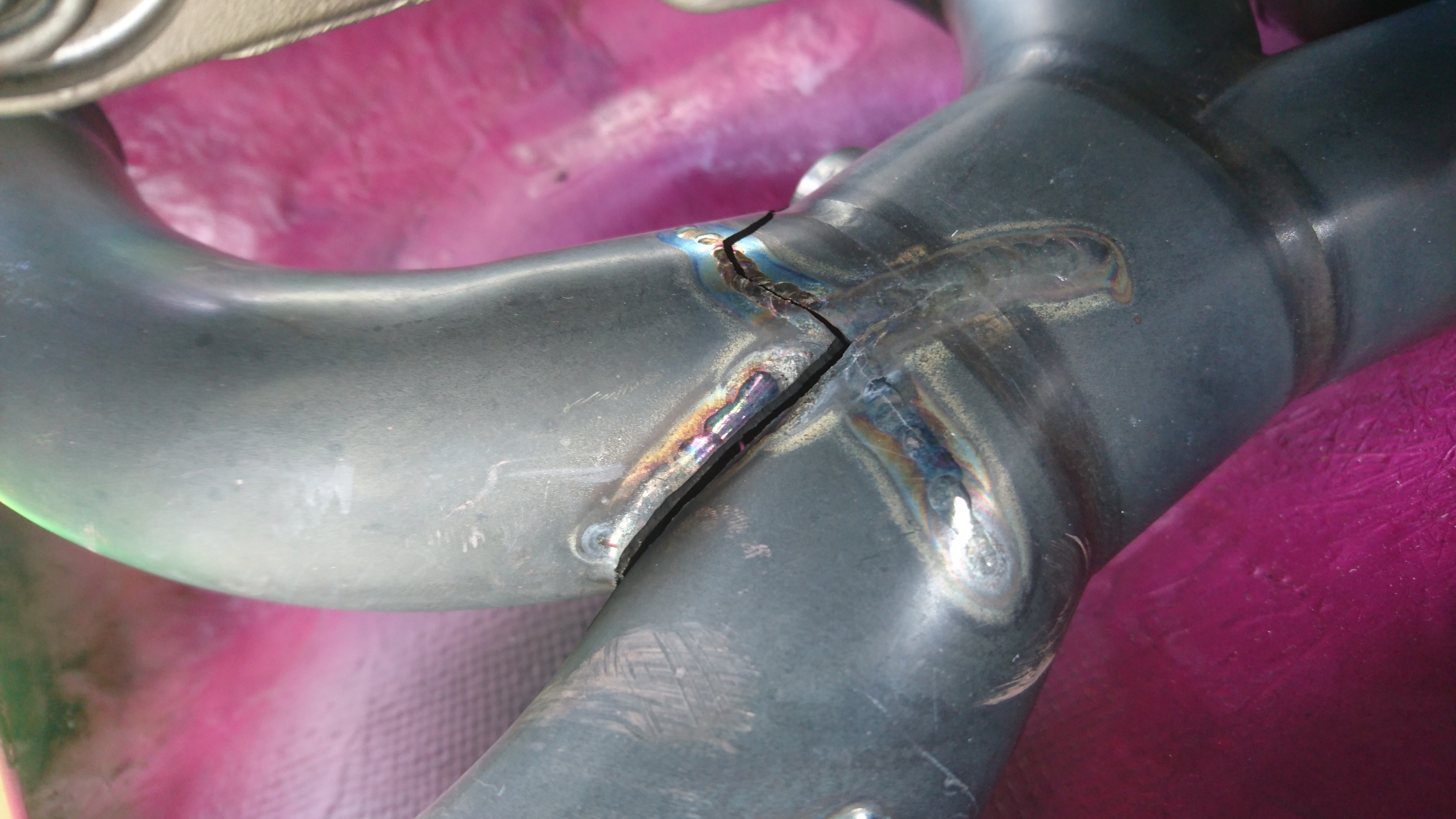

The exhaust cracked at the collector during my thrid session. That sent me home to an early bath. A mate called later and said he could have had me back out on track but it might not have lasted the day.
But these were all outweighed by the hits. Firstly it runs and runs well. I think the one size larger mains have sorted the top end but mid-range might be a little rich.
The handling is chalk and cheese. It turns in better, changes lines better and drives better. I was running the same times in my third session as I was running at the end of my last Cadwell day and it felt easy. I've changed so much I can't put it down to which change(s) but the combination of braced frame, swingarm, lower yolk, new fork oil and changed tyres have made a difference I can feel, I'm sure of it.
Last time I was at Cadwell I could feel a definite dip at the apex of Charlies 2. That dip is still there but I hardly felt it. I'm putting that down to the stiffer chassis (i.e the bike was flexing before) as the forks were fresh then, as were the tyres. Hall bends and the chicane were no where near as easy to switch direction and I was very comfortable braking into the Gooseneck with the bike on it's side. I had it leant over all the way from Chris Curves to the Gooseneck when last time I was picking it up and driving upright before chucking it in. And I'm sure I could feel ripples on the approach I've not fealt before. I'm putting that down to a flexi chassis absorbing them last time, but my forks were slightly slow on the rebound.
I need a steering damper as it wags its head over any little lump. The one I have won't mount where I had it on the other frame and it's too long for this frame, so I'm on the lookout for one with a stroke between 100mm and 125mm.

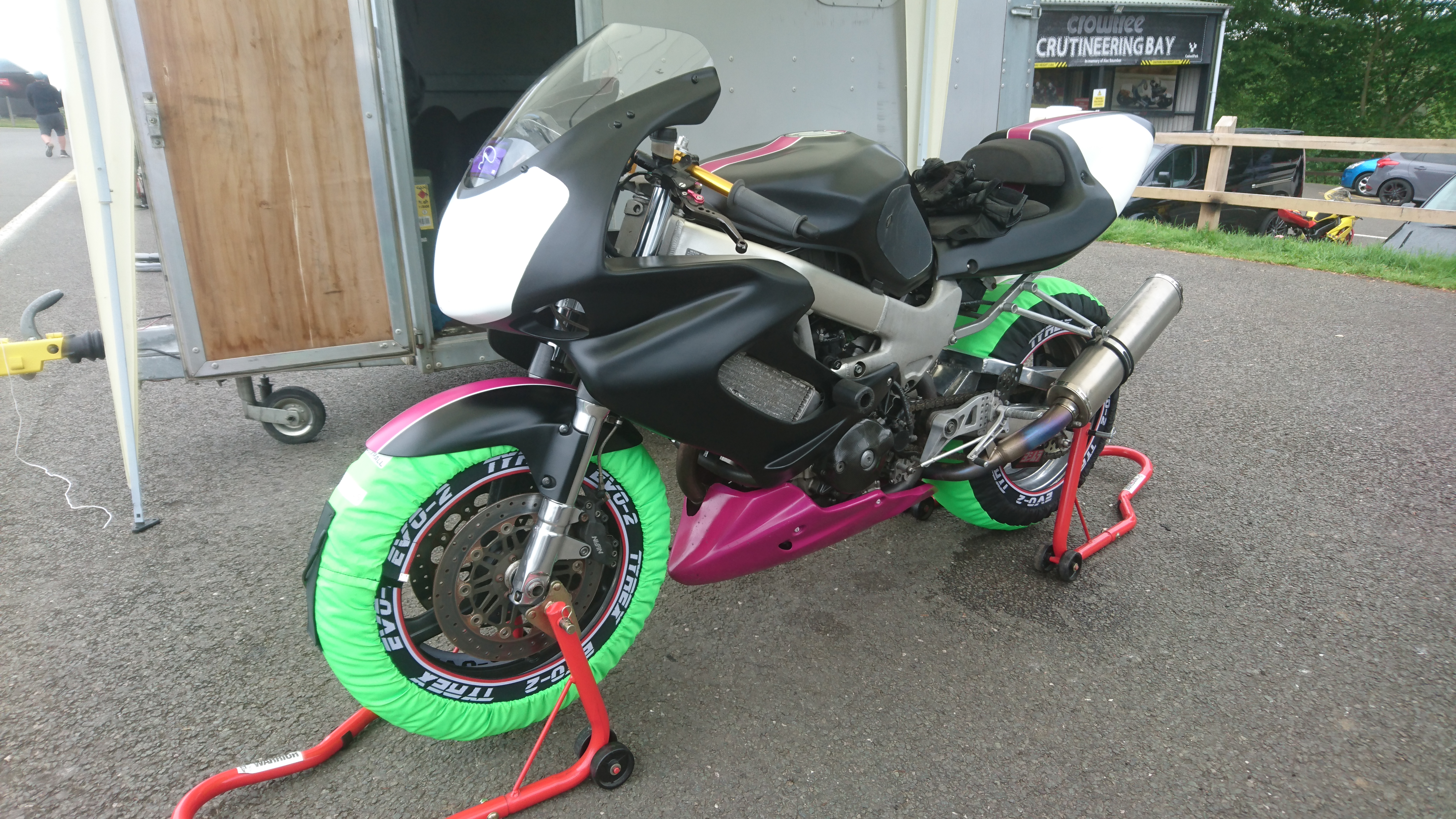

The tyre warmers clash a bit
Knackered exhaust

looking good nick. well apart from the pipe crack but thats just bad luck..whats nice to hear is a normal human can actually feel the difference the frame makes
the guy that used to own that frame, the last day i was on track with the yellow bike theres a fast bumpy 120mph corner at kirkstown over here, i was getting tied in knots and i rem him just blasting straight through it every time, i couldnt work out why but at the time i didnt realise what chassis he had as i hadnt really checked out his bike. it wasnt until i bought the bike a few years later to get the motor for my bike that i realised what is was
great to see it back were it belongs on track.

Good to read about how all your hard work and time has paid offfreeridenick wrote: ↑Thu May 23, 2019 12:34 pm It had its first proper thrashing yesterday but it was a bit hit and miss.

The green tyre warmers look great

Shame about the headers .

So apart from the damage and my riding there's not much I think I can change now. The exhaust was fixed with an expensive purchase from Japan - if anyone has a Mori high-level left hand link pipe spare let me know, and gearing could be played with but aside from that I think it's done. Famous last words.
