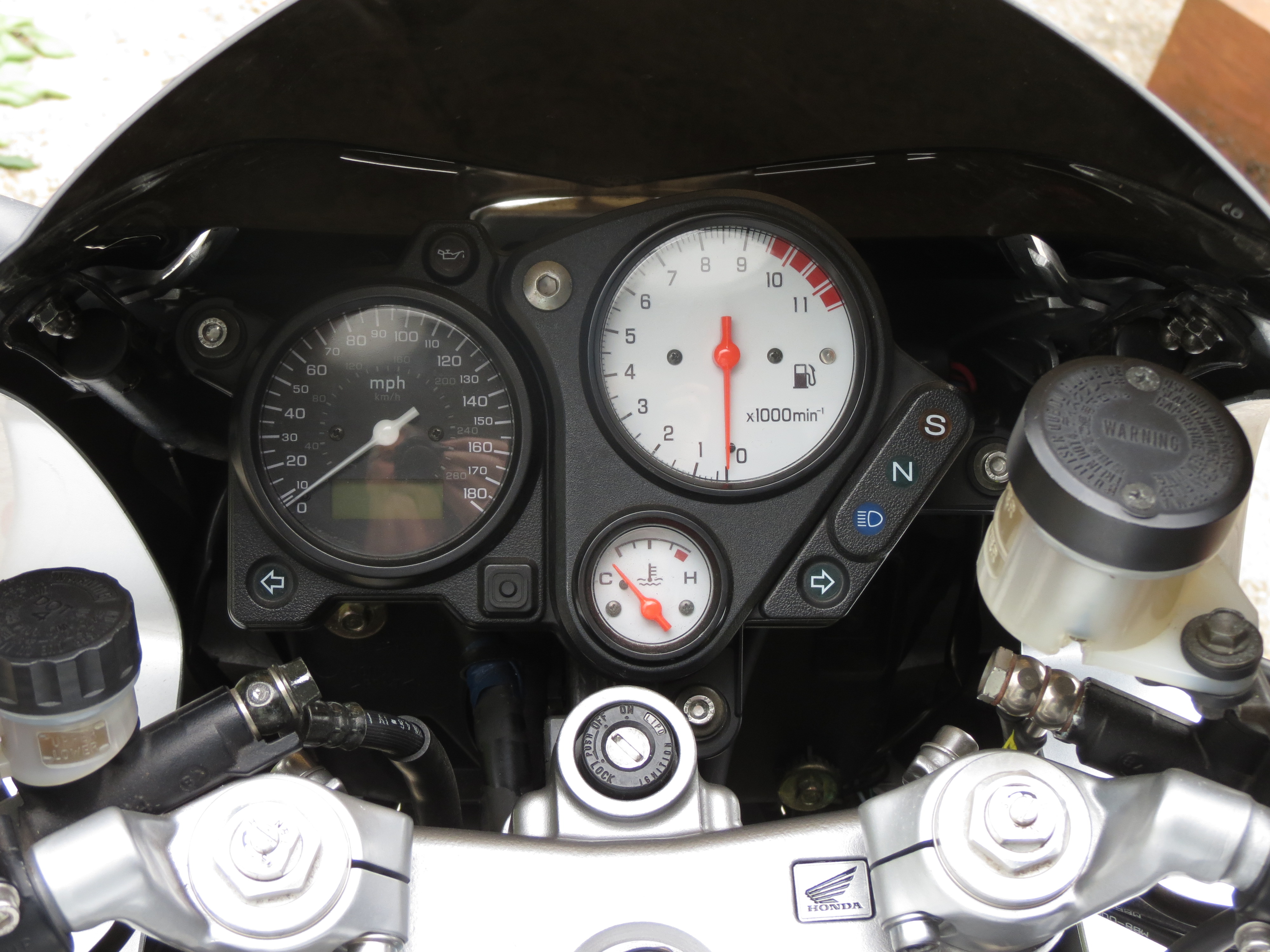

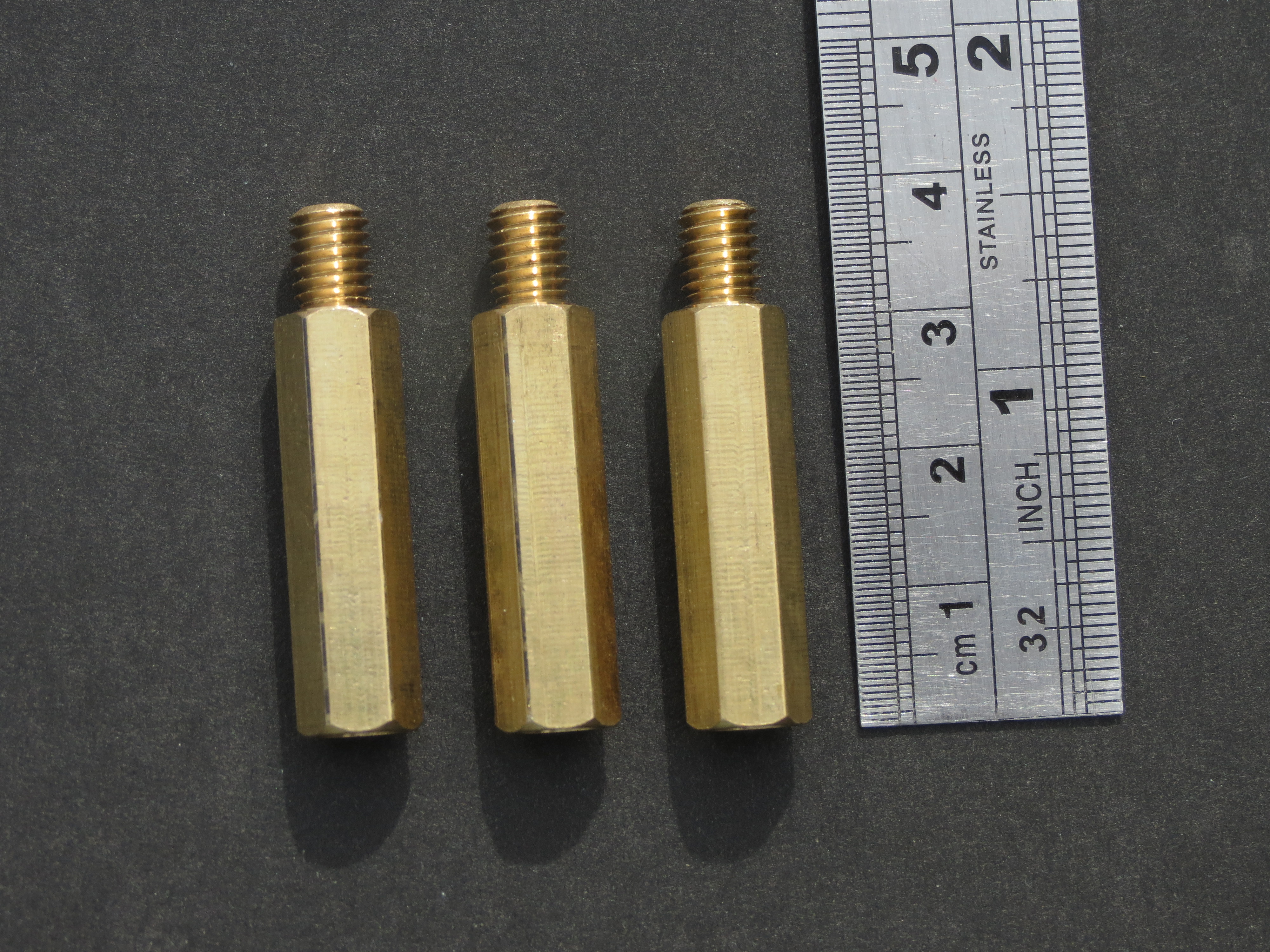

Added 3 30mm spacers under the instrument pod. What with having the VFR bars, just seemed to be to far away. They are brass, so etch primed them, then satin black. Fitted with washers between the spaces and the pod. https://www.ebay.co.uk/itm/M6-x-30-mm-8 ... 2749.l2649.
