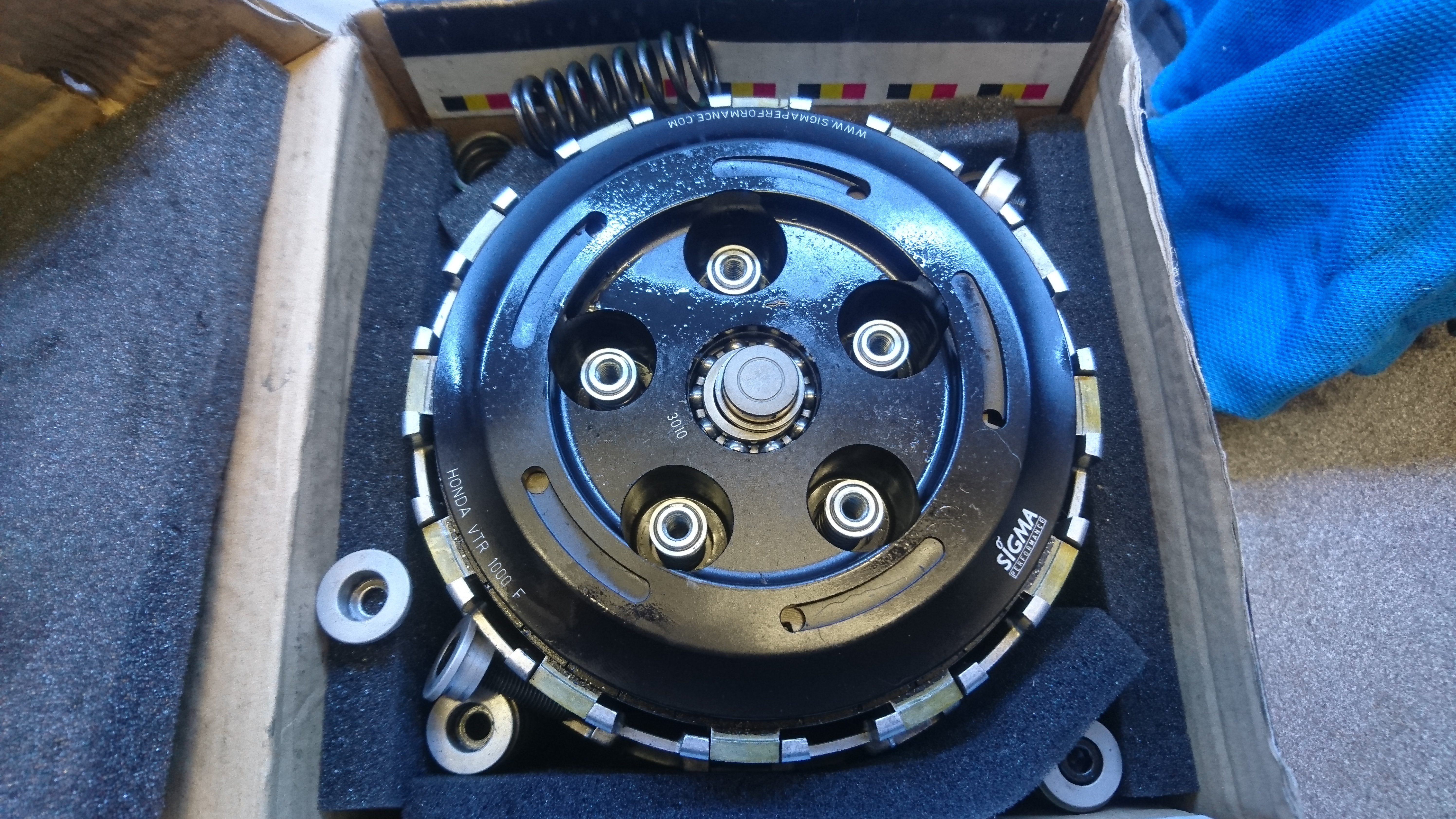

Proof that rocking horse do poo!
Re: From 107 to 128
freeridenick wrote: Fri Oct 02, 2020 7:27 pm Proof that rocking horse do poo!
As rare as hens teeth :lol:
I'm glad to see a bit of good luck going your way Nick 8)
Posts: 1660
Re: From 107 to 128
Only about twenty of the Sigma ones made apparently Chris. They have no stock and no parts
Re: From 107 to 128
Nice find......though if you have too much extra cash lying around I know where there are a few (though not from Sigma) still around :wink:
https://www.yoyodyneti.com/product-p/t19303.htm
Posts: 1660
Re: From 107 to 128
8541Hawk wrote: Fri Oct 02, 2020 9:17 pm Nice find......though if you have too much extra cash lying around I know where there are a few (though not from Sigma) still around :wink:
They were my fallback option.
Posts: 16273
Re: From 107 to 128
You'll be pleased with that, I never felt I needed it on my Storm but it's essential on the SP2. I chose a Sigma as well.
Re: From 107 to 128
freeridenick wrote: Fri Oct 02, 2020 9:14 pm Only about twenty of the Sigma ones made apparently Chris. They have no stock and no parts
Nice one Nick :thumbup:
that looks sexy even in a box :lol: :lol: :lol:
