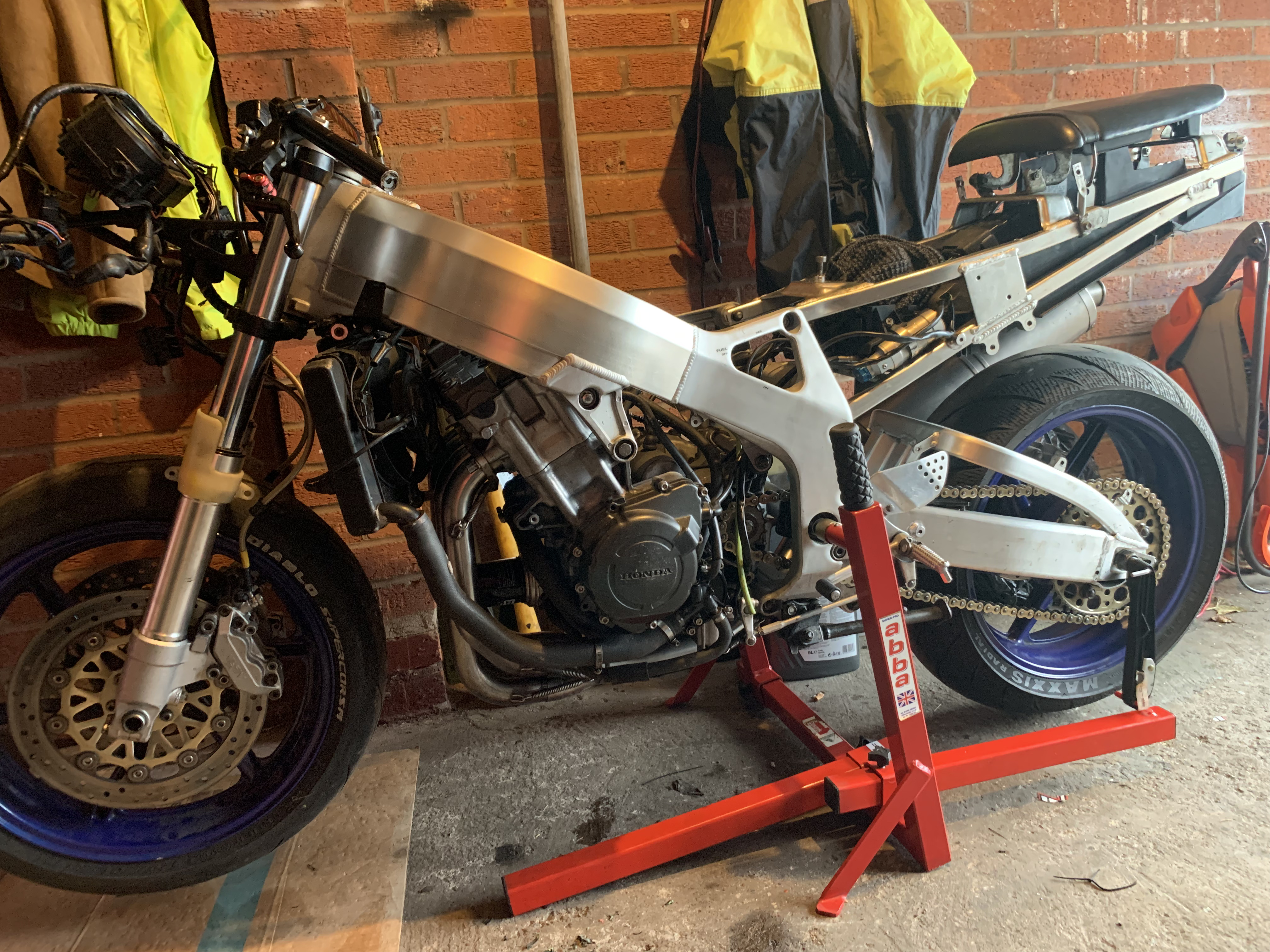

Almost back together , I have noticed now it’s up and level on the ABBA stand the rear sub frame is twisted too .
So that’ll get straightened soon enough .
Time to cover it up for the remainder of this year and start it up again in February .

Fitted new rear wheel bearings, sprocket bearing supplied wrong size
so reordered... the original sprocket bearing is free but still has collar number 8 attached so need to get that out of the free old bearing.
Subframe and wiring refitted loving the new PC'ed piano gloss wheels and satin black subframe and hangers.

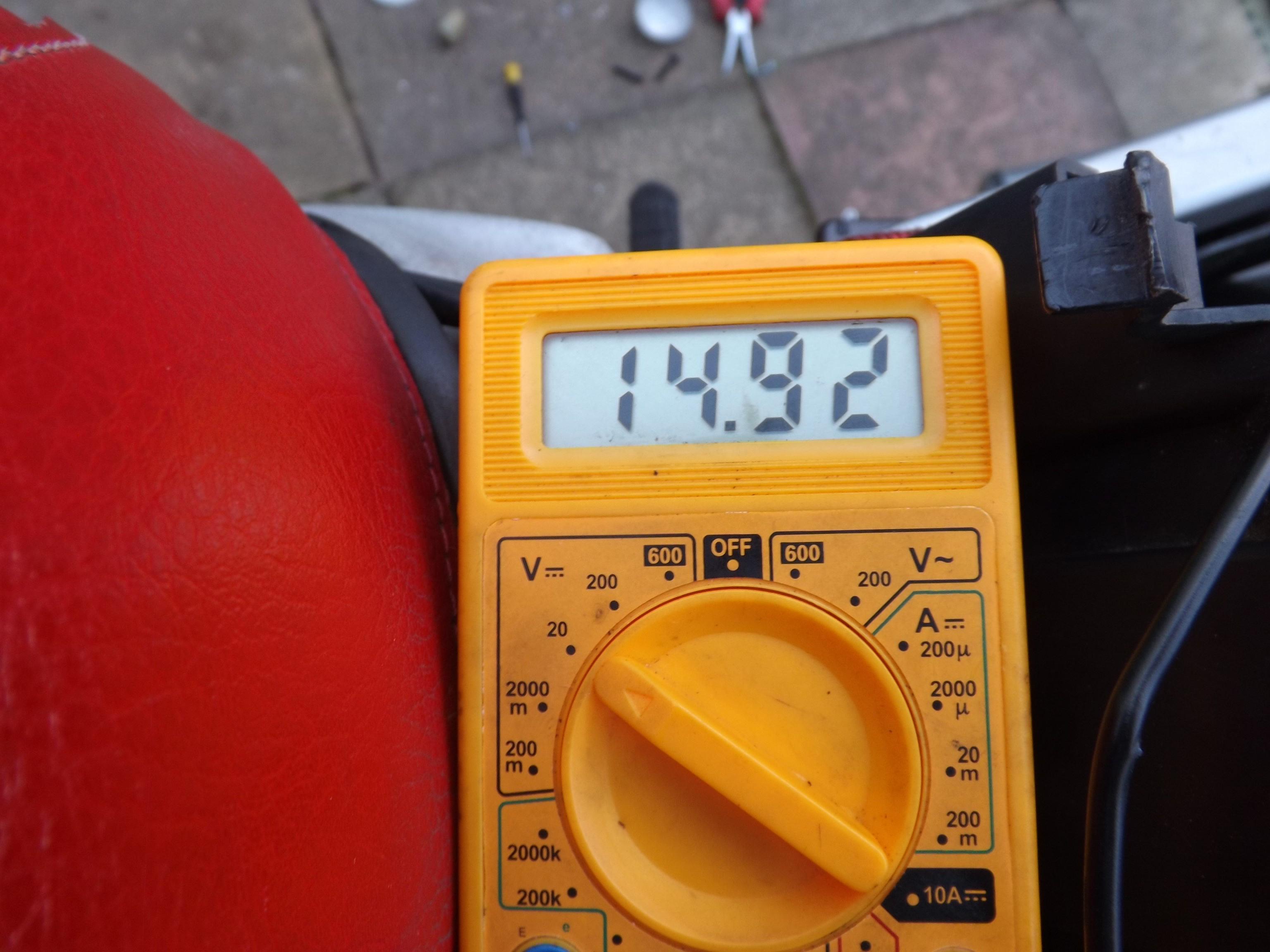

After the weekends battery woes...
Today I fitted a new battery & a Mosfett R/R...
Showing ...
So all is well.

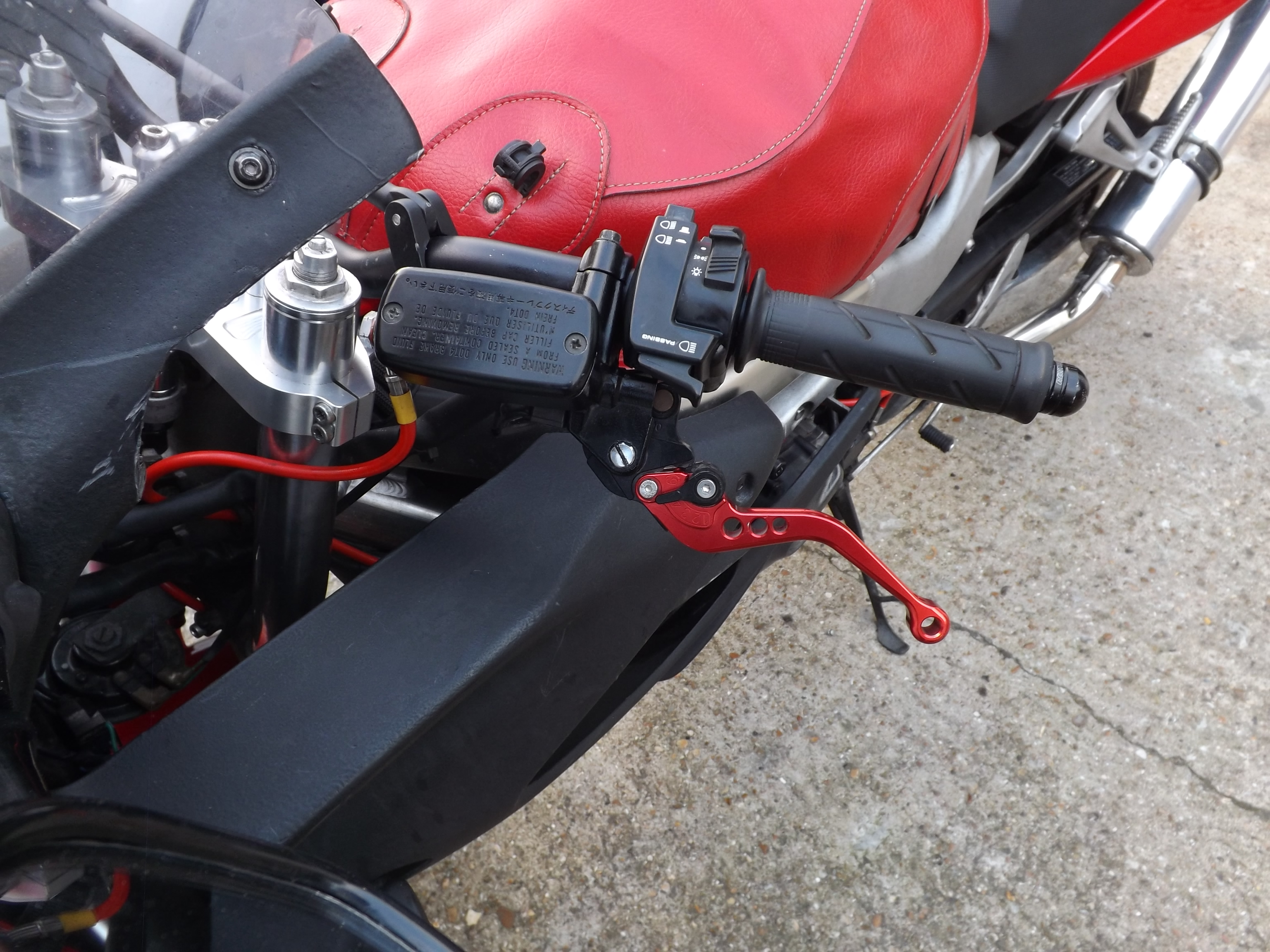

Also fitted the new VFR clutch M/C...
5 min reverse bleed all good.
