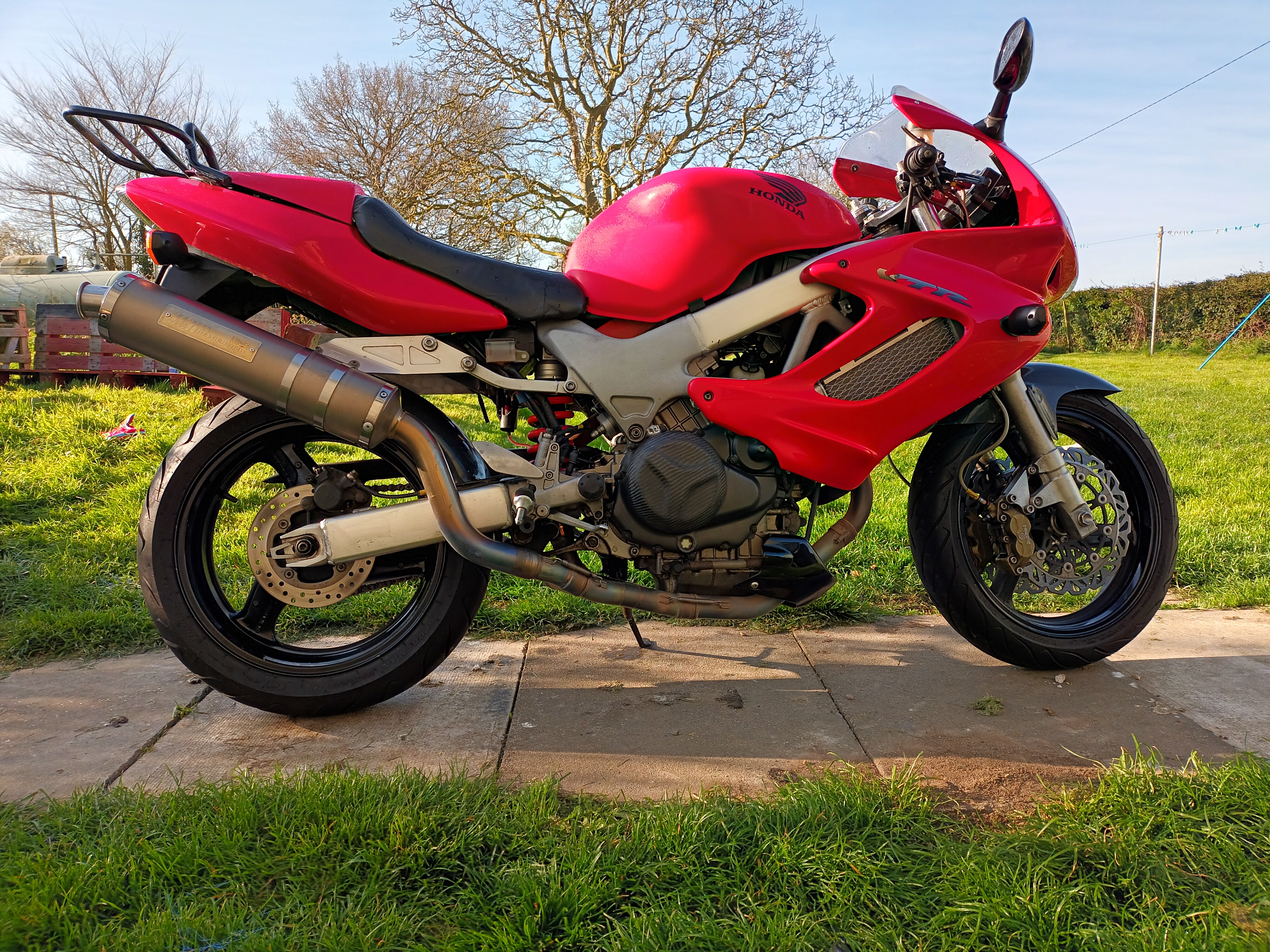

Not quite today but I have been dipping in and out over the last few days to get my 03 firestorm back on the road again after my RH low side.
I finally cleaned the bike which has been under wraps since the Scottish monsoon last August!
Removed my scraped rear tailpipe and replaced with an NOS tailpipe only to find out that the NOS pipe was from a pre-2002 model and narrower in the midsection...bummer. It fitted okay but looked skinny odd so removed and spend a while removing as much of the scrapes on the old pipe with various garryflex sanding blocks, upshot is that it's good enough to go back on.
The exhaust was leaking at the front header so luckily I managed to remove the both nuts, although a stud also came out but all intact. Had applied plusgas twice a day for 3 days and soaked a couple of pieces of sponge and stuck them on the nuts in an attempt to constantly feed them plusgas. Took my time and very slowly tightened and loosened until they freed up, happy with that. Cleaned up the area around the header and the clamp, removed the copper washer in readiness to replace with a new washer.
Removed fairing and fitted a new right hand outer part of the fairing and an inner left hand part that has been cracked since I got the bike in 2013, fairing looks great and an added bonus was that the old outer fairing had a small scratch that bugged me although not as much as the road rash on the rest of it
My to do list is now to replace the remaining scraped / broken parts, mirror, indicator, brake lever, handlebar bar end and inner weight that snapped, easy stuff. I also need to replace the RH crankcase cover, so will by default do an oil change, coolant flush n change. I have all the new parts and my intent is get the bike back to absolute standard.
I have been searching this forum it seems every five minutes to double check I'm doing the right thing and to learn from the experience here. I also print the pages from the manual that relate to the work I'm doing to triple check.

That should make good for the photo shoot
I'm also a fan of Plusgas, I like the way you used pieces of sponges thereItsaKeeper wrote: ↑Thu Apr 14, 2022 8:00 pm The exhaust was leaking at the front header so luckily I managed to remove the both nuts, although a stud also came out but all intact. Had applied plusgas twice a day for 3 days and soaked a couple of pieces of sponge and stuck them on the nuts in an attempt to constantly feed them plusgas. Took my time and very slowly tightened and loosened until they freed up, happy with that. Cleaned up the area around the header and the clamp, removed the copper washer in readiness to replace with a new washer.
Glad the see that you are back on here and rebuilding the bike to its best.ItsaKeeper wrote: ↑Thu Apr 14, 2022 8:00 pm Not quite today but I have been dipping in and out over the last few days to get my 03 firestorm back on the road again after my RH low side.
