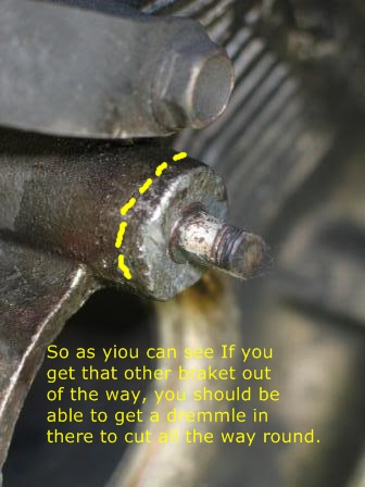

Posts: 18022
rollingthunderx2 wrote: Sat May 07, 2022 2:38 pm Still leaves the problem of actually getting it out..
I have it up on the bench with the front end off as Ive been doing the forks.
Ive dremelled a slot and used a mapp torch and an impact gun with a good fitting bit.
The good drill wont look at it. I think theres a broken drill or something in there as the bit is clicking.
The header flange was welded on as well as being completely rusted.
Theres a trick you can try... Cut a bit of the head itself off...
You'll have to do the other side to even it up...
Drastic but other than head off & take to a machinist you've tried everything else...
