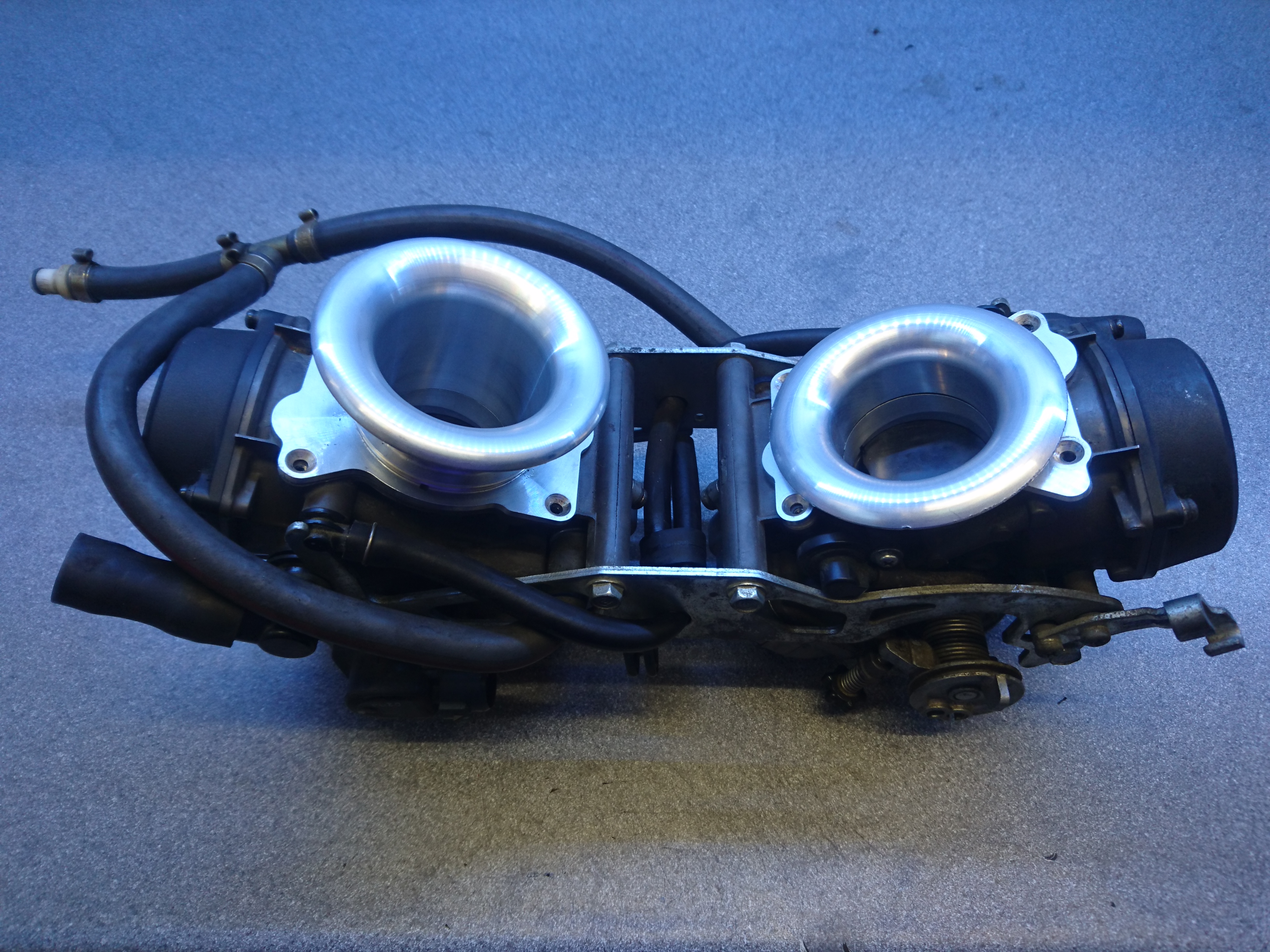

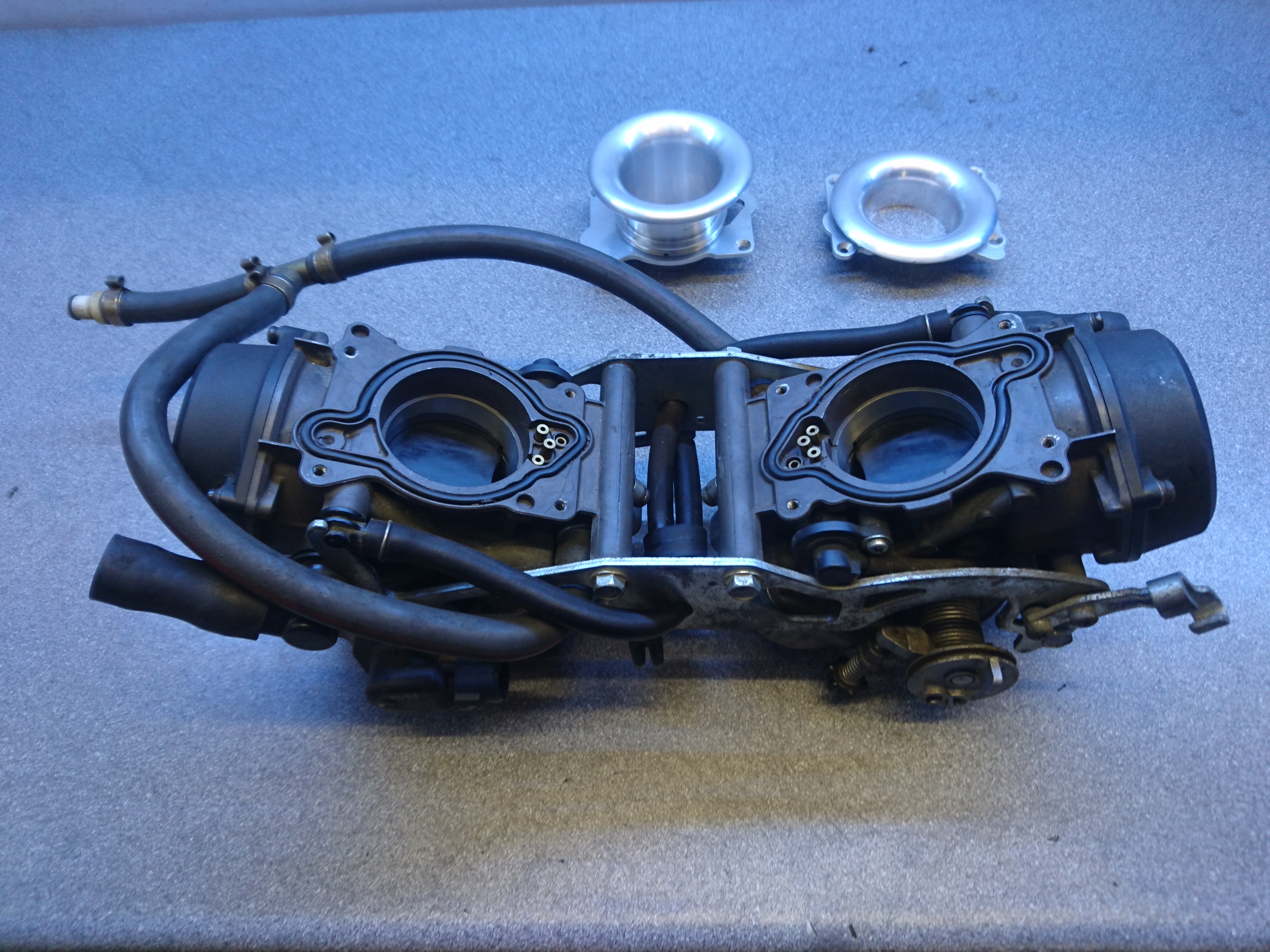

If those carbs are what I think they are WOW 8) 8)

Yes Chris, those carbs are what you think they are. They were pricey but came with a few other tasty bits FOC. Or maybe it's the other way round. More to follow on that front.

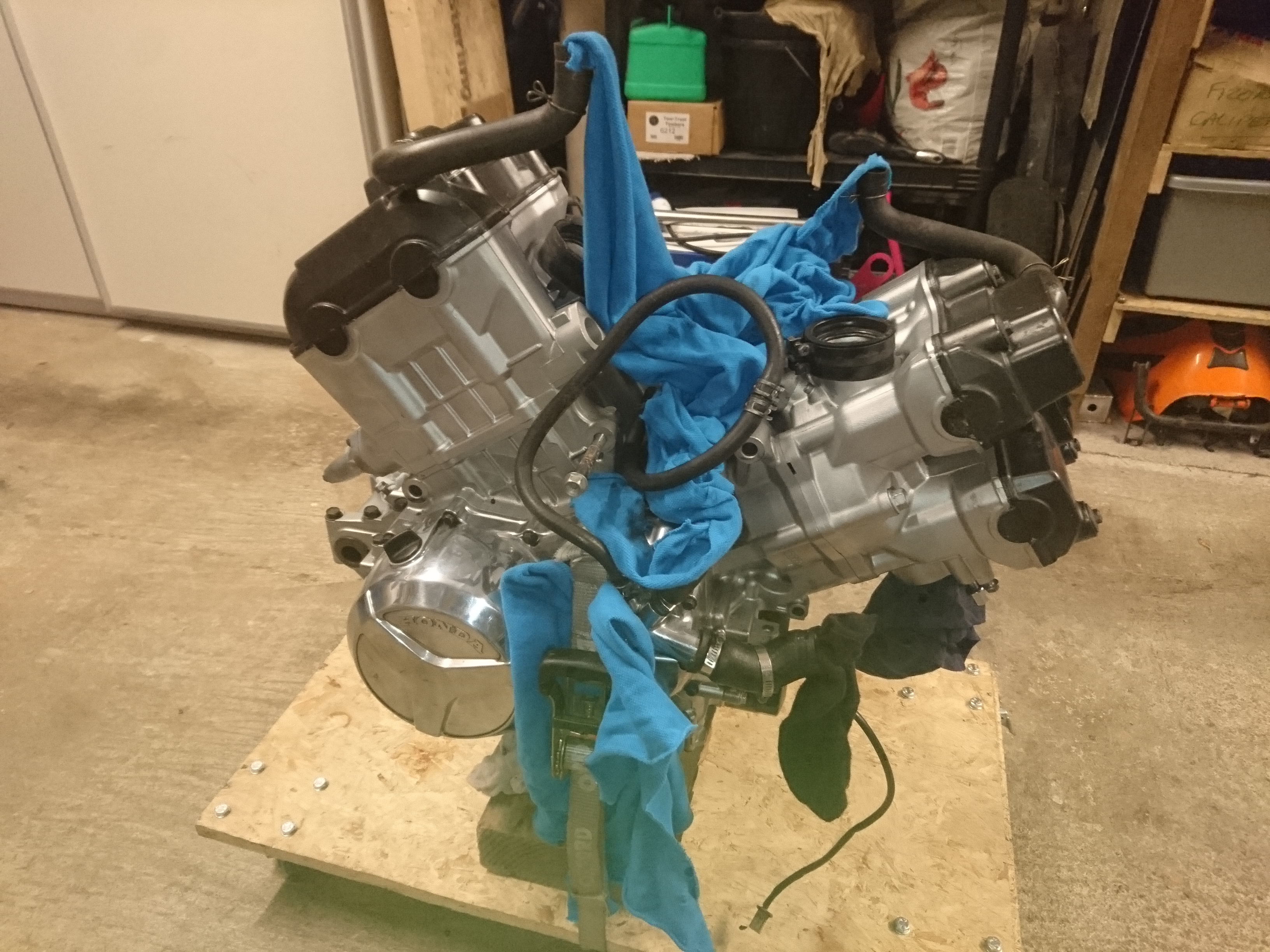

The new engine is now out of the donor bike and ready for transplant later this week. In theory I could have a running bike by the weekend but I think I'll get a few other jobs sorted before filling it with fluids and booking a Dyno session.
The polished covers will be going and the flywheel from the other engine will go in, along with the slipper clutch. Hopefully all done by Monday but I'm not going to stress about it if it's not all done.

that donkey is gona be proper, will be interesting to see just what gee gees its putting out :thumbup:
i actually like the polished cases, yeah im sick i know.

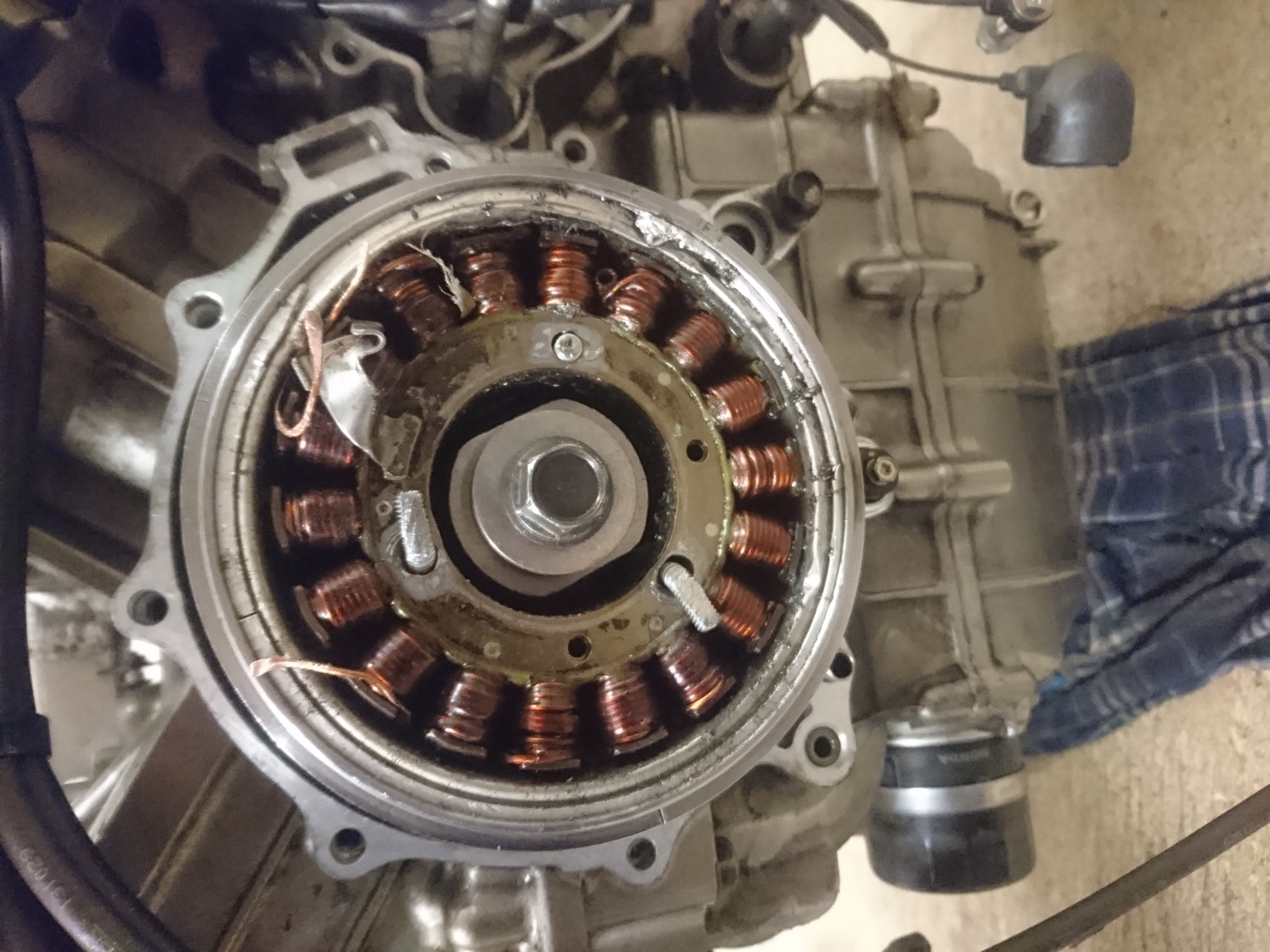

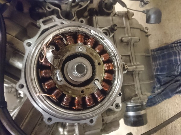

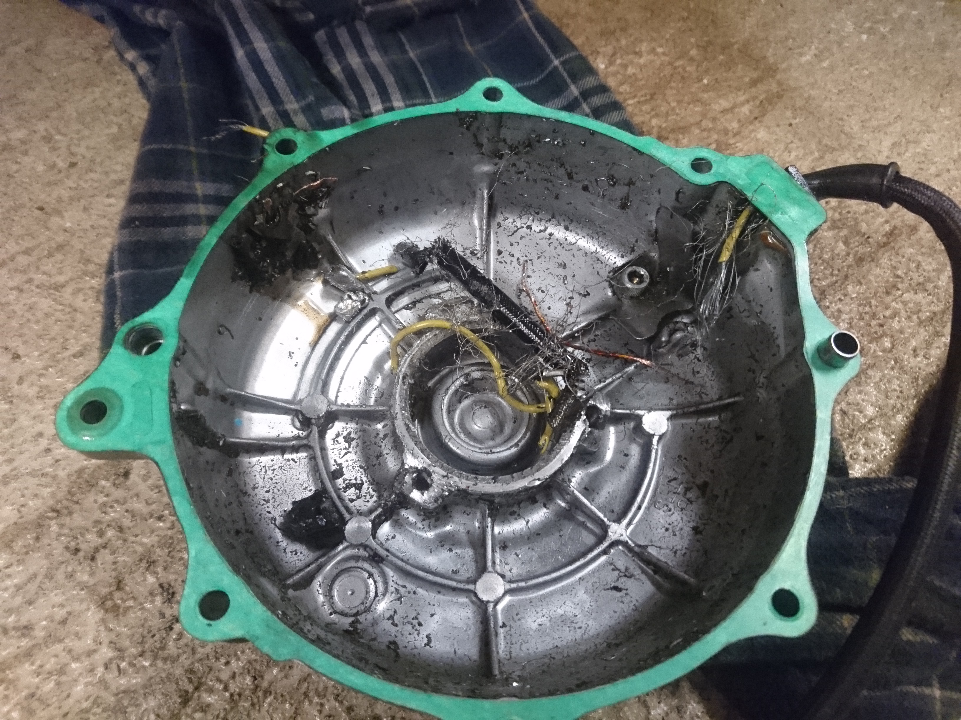

Oh dear
Oh dear
Quite nasty this
Quite nasty this
I wasn't sure whether this was a cause or a result of the engine failure until I tried to remove the flywheel. Being able to move the whole crank from side to side or up and down suggest Roger was right when he told me it was a massive oil starvation issue. My current guess is either the crank bearings have spun or the oil strainer is clogged. Either way the bearings have eaten themselves causing the flywheel to chew up the stator and probably a bunch of other parts are screwed too. Although the clutch looked OK when I pulled that cover off.
On the plus side, the engine turns over by hand freely enough so I'm hopeful the heads are OK. There's a slim chance the pistons are OK too but with the crank moving like that they're probably scored. The bottom end is toast though. Fortunately I've got another bottom end which should be rebuildable.
Next stop is a quick message to Fabio for another flywheel.
