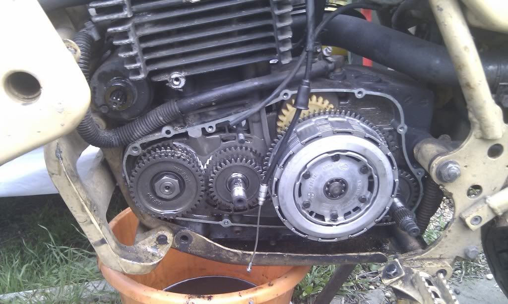

before taking the cam belt of i have to lock the crank while the bike is tdc
theres a a removable bolt under the engine i didnt know what i was supposed to do so i used the kick start bolt its the same but half inch longer that work
it turns out now i can use theoriginal bolt just take the two washers of it there there for that purpose -_-
its a rotax engine a 350 version same one used in aprilia's and mz i beleive plus other bikes
where you see the clutch basket on the clutch case near where the clutch cable is there a y shaped plate with lever sitting on 3 ball bearings when the cable is pulled it
lifts the lever causing the y shaped plate to scew sideways thus pushing the broken bolt into the centre of the clutch basket
hope that makes sense its the first actual clutch ive seen with me own eyes lol

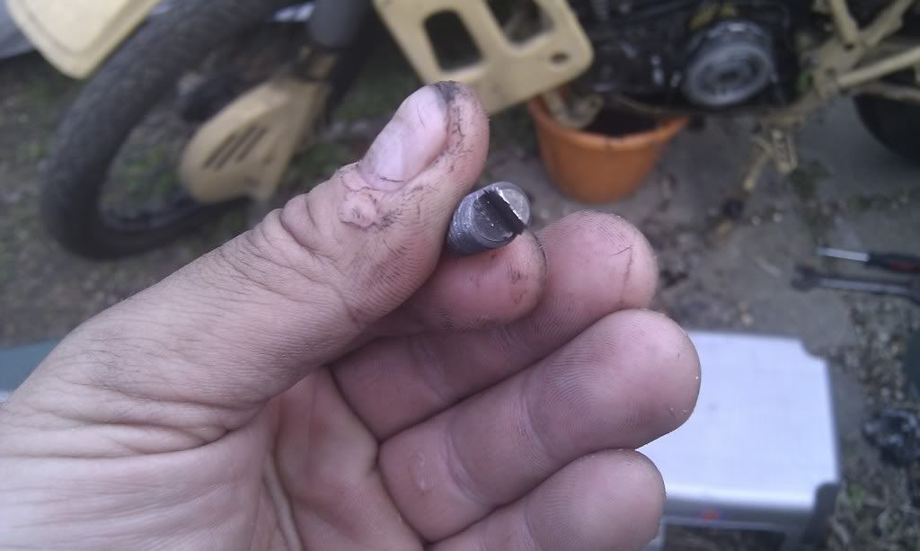

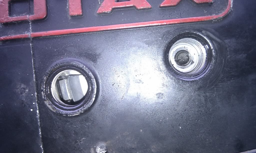

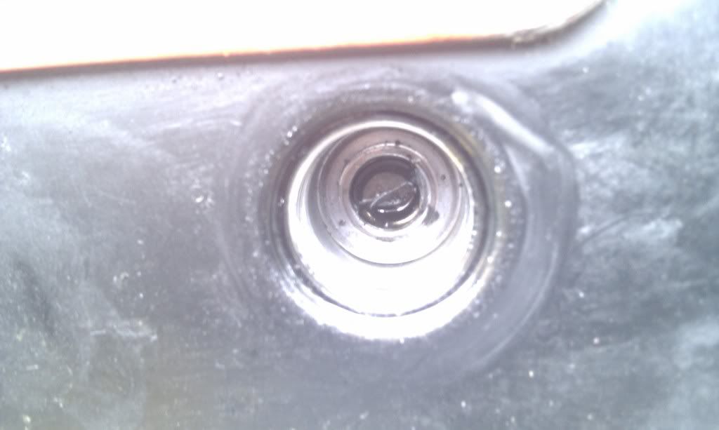

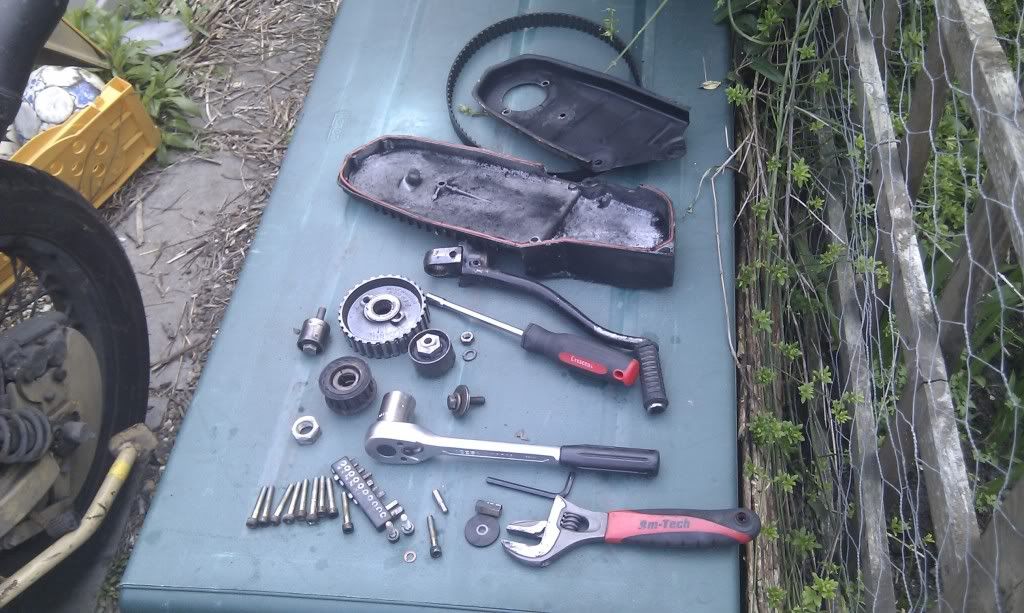

i would say and this is from a fellow non professional that your grass needs cuttingDarknomad wrote:had a twiddle with me mt350
noticed some essential bolts are missing
ones that hold the engine to the frame lol
ignoring that i decided to try and fix the clutch issue
on inspection of the two lil access holes on the engine things was definatley a little wrong
there was a tension nut missing and the bolt was broken
both in the right side hole
meant draining her from the frame oil sump
and engine sump
then taking of the belt cover the belt tthe belt tensioners some kinda gear cover
then the clutch cover
i do like looking at the moving bits in an angine
it was a pain in the butt to lock the crank in position
all to get this bolt out
anyway with advice from neighbour he had a bolt suitable for me to cut the head of and make
a slot for a screw driver so after sticking it all back together
she kind of works but is dragging the clutch atm i mean in gear with the clutch pulled right in
she is still turning the back wheel not sure how to fix this issue atm
