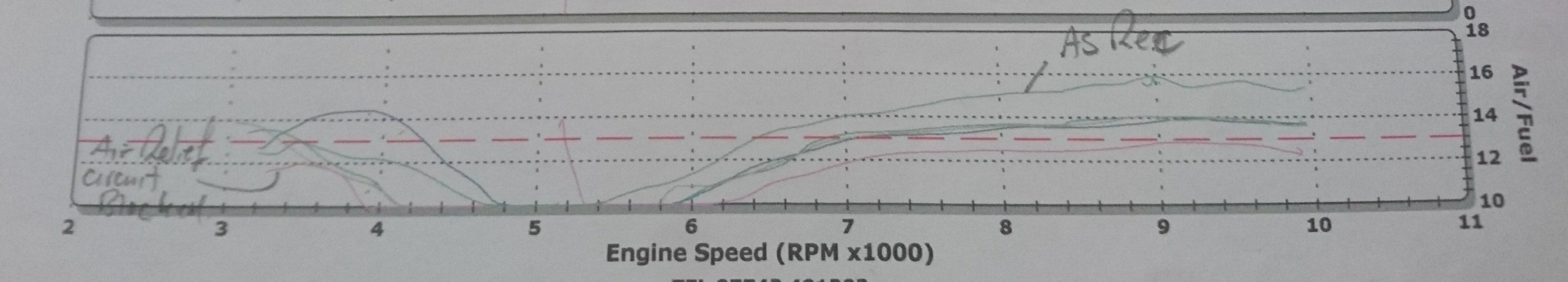

The trip to Junction 33 turned out to be a thoroughly annoying setback. Several small mishaps before it even got on the dyno set the tone and should have been in indicator of things to come. The bike has a massively over-rich problem from around 4k to over 6k and Andy can't sort it with the carbs. His view is that it's something in the induction that's causing a 'blockage' which is stopping air entering. Eventually this clears when the revs have got past it but I'm stumped as to what the problem could be. Roger was there too and he's got no idea either.

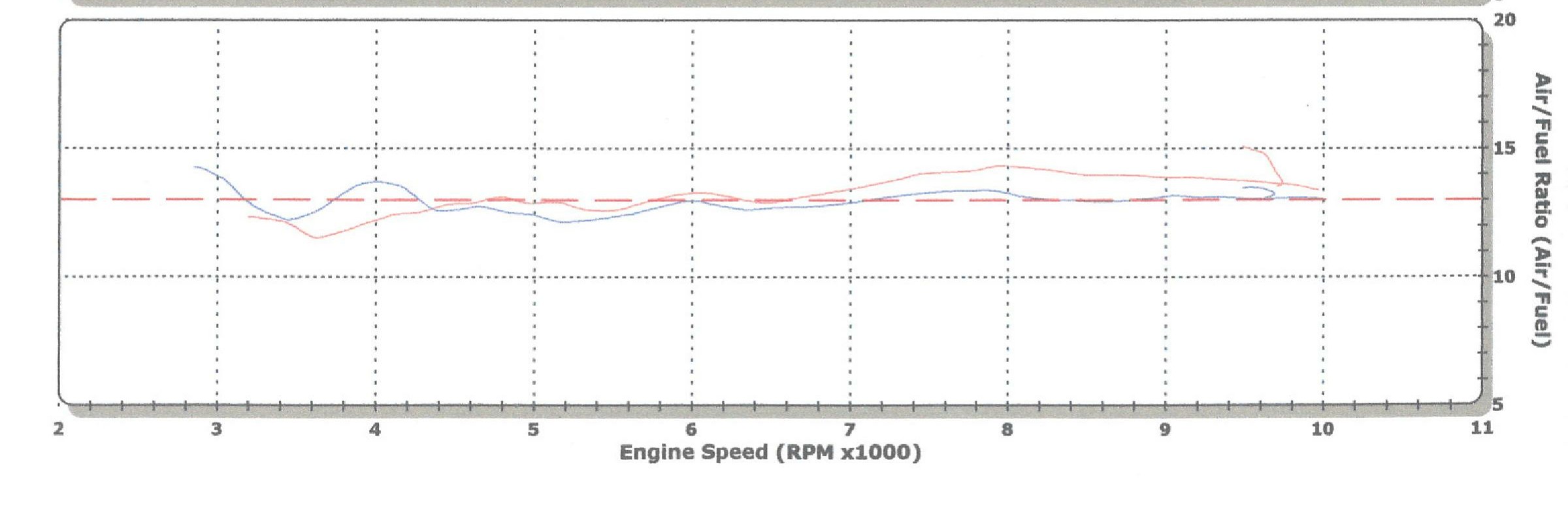

The A/F chart is below and the one from my old engine as a comparison. I've written everything I can remember from the runs plus the differences between my old, fit, engine and this new one. Answers and suggestions on a postcard please to:
Thoroughly despondent,
c/o anyone looking to buy a few Storms in bits,
at hunting ebay for local bikes that just run,
next to "I'm too old for this sh1t".
The top green line is as received and it's mega lean at the top end plus rich on the pilots. Blocking the main air relief circuit made that better but the rich condition was horrific (pink). The three other, overlapping lines, are with smaller pilots, larger mains, plus a trial with a more restrictive air filter. The larger mains sorted the lean top end but made the richness in midrange worse, so there was no point going bigger to get the top end right. At best it made 72 ft-lbs of torque and less than 120bhp. Way off my old engine and what Roger and I were expecting from this engine.
Engine differences :
Stg 2 Mori cams on the new one vs stg 1 Yoshi on the old one
Std valves vs +1mm inlet and +0.5mm outlet
Mori pistons vs JE
Mori carbs and needles vs stock cards with Dnyojet needles
Mori vleocity stacks vs two short stock ones
Air box and carbs the same exhaust
I know all these changes add up but I can't see how they have made such a huge difference when Roger has had good results with this sort of build before. All I can think of is that the valve timing is off, but that surely wouldn't make such a huge difference without the engine eating itself. Another thought is that the choke circuit on my carbs is blocked off but could be open. That, in my head, would give something like this but we didn't explore it on the day as I thought the choke circuit was deleted on these. Roger has confirmed choke was an option so I'm going to check tomorrow but if it's blocked I've no idea what to do other than stripping and checking everything. Which I can't face right now and I've a nasty opposition to throwing good money after bad.
New engine
Old engine
Re: From 107 to 128
I'm sorry to hear of your problem(s) Nick, how frustrating, and annoying I'm sure.
I was wondering how it performed out on the road, but I'm now thinking you didn't ride the bike to the Dyno centre :?:
What did you set the TPS at :?: and may be worth testing it to make sure it's working :eh:

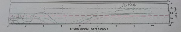

freeridenick wrote: Sun Mar 21, 2021 10:29 am The trip to Junction 33 turned out to be a thoroughly annoying setback. Several small mishaps before it even got on the dyno set the tone and should have been in indicator of things to come. The bike has a massively over-rich problem from around 4k to over 6k and Andy can't sort it with the carbs. His view is that it's something in the induction that's causing a 'blockage' which is stopping air entering. Eventually this clears when the revs have got past it but I'm stumped as to what the problem could be. Roger was there too and he's got no idea either.

sorry to read this. Hope you figure it out.
Re: From 107 to 128
A spare set of carbs would be a short cut to identifying the problem.
Alternatively, an ecu swap.
Could this be an advance timing issue?
Posts: 16732
Re: From 107 to 128
sounds ike a depressing nightmare!!
same as Tony, my next test would be to swap carbs

Thanks for the advice guys. I've checked the choke on the Mori carbs as these are blocked off with the needles and a cap, so it's not that. I've fitted my old carbs and airbox that worked well with the old engine. I've also discovered there's a Dyno operator in my town so I'll be calling them and working out what they can do and when. First step will be checking the old carbs have the same issue.
It could be an ignition problem, but it's the same ECU and ignitor box as before. I have spares somewhere, so will dig it out. If it's an advance problem then I'll need a programmable ECU and I'm not sure I have the energy for that. I know the HRC box had different timing around this rpm range, and also at the top end.
TPS was set to 500 ohms when I fitted them and checking them just now they are 450 ohms. I'm not sure this would cause such a big problem.
One thing that occurred to me today was the gap between the velocity stacks and the carb throat. Where the stock stacks would sit flush with the step in the carbs (Mori ones fit flush too when mounted direct to the carbs), fitting the Mori ones inside the airbox leaves a gap of about 5mm. Could this create enough air turbulence at certain rpm to effectively block the air flow? That could create the rich condition. Andy reckoned it was more likely a back pressure wave that was causing a plume of mixture to form over the carbs which then rushes in causing the richness. The sort of thing a balance pipe in the exhaust would cure so I'm probably clutching at straws. The counter to this is that the exhaust is the same as the one on the old engine and Roger has had success with stg2 builds and street exhaust. Finding a stg2 exhaust is virtually impossible and getting one made would be an expensive shot in the dark right now. I'd need to be certain it would work.
Re: From 107 to 128
I don't think a 5mm gap in the inlet tract would cause this, but it would be easy to make a plastic ring to fill the gap to check.
450 ohms is not the cause, this just adjusts the point at which the ignition advance curve operates- unless there's something in your ignition box map that says otherwise.
Can you plug it in and examine the advance curve?
The other thing might be carb vacuum. If one carb isn't getting enough vacuum to fully open the slide until higher revs it might explain this.
Diaphragm perhaps? Or split vac line?
Posts: 1659
Re: From 107 to 128
Lift holes, what about lift holes? Rereading the carb tuning guide reminded me that the HRC slides only used one hole. The ones with the Mori carbs had three, so I plugged one, but would the Mori stacks allow a much greater vacuum than stock? Enough to lift the slides too early and cause a rich condition just off the pilots and into where the needle operates? Therefore I need to plug one more hole and try that?
The Mori needles are much fatter than the DJ and FP ones with a much steeper taper. They have a longer straight section too. Presumably to stop this midrange richness.
I checked the diagrams when I rebuilt the carbs Tony but will check again. When you say vac lines do you mean from the air cut off valve to the small metal tube?

jesus i feel your pain nick. as for stacks.when i was trying to pull my hair out with mine i tried honda,mori and those aussie stacks all in one day and the problem wouldnt go away, i even tried mine with no stacks and that didnt show much difference either.
mine was hitting a spluttery wall in the mid range 5/6k which in my case didnt show up to bad on the dyno but made riding the bike impossible but it was rich in that range.
have you tried it with your old carbs? regardless of engine tune the mori carbs seem to have been the big change from one to the other engine.
i know your frame has restricted excess round the headstock, as in airflow but iv ridden that frame with the motor i now have in dori and it didnt have to problems you are having.
Re: From 107 to 128
fabiostar wrote: Mon Mar 22, 2021 10:11 pm jesus i feel your pain nick. as for stacks.when i was trying to pull my hair out with mine i tried honda,mori and those aussie stacks all in one day and the problem wouldnt go away, i even tried mine with no stacks and that didnt show much difference either.
i know your frame has restricted excess round the headstock, as in airflow but iv ridden that frame with the motor i now have in dori and it didnt have the problems you are having.
one other leftfield problem i had way back with my original engine which took a bit of finding was my ecu box was going bad and caused all sorts of runing and misfires at 6k.changed the ecu and away it went clean as. :thumbup:
