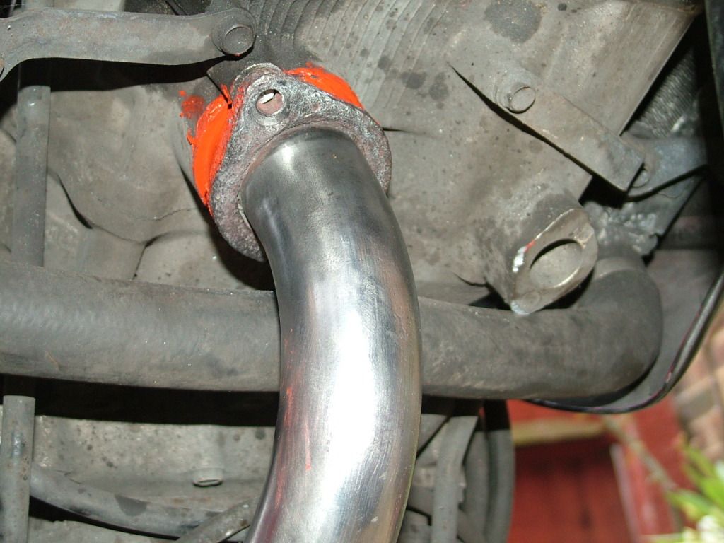

Just been out with the clay bars and drill smoothing out the roughness from the wire brush on my header pipes. Then gave them a quick buff of Autosol. They have come out pretty good and a vast improvement over what I started with. Could have done a better job and put a bit more time and effort into it, but it's too much hard work, so I settling for a vast improvement rather than perfection.
Just got to go out and drill the exhaust studs out the front cylinder. :( pain in the butt job :thumbdown:

I have had a nightmare of a day. Those bloody exhaust studs beat me :evil: couldn't drill them out. I was at it for about 3 hours drilling one stud. It's really p'd me off. Not sure what I'm gonna do about it now, maybe just get the dam thing spot welded so it held in place. It's not as if I will be taking the headers off again. Not in a hurry anyway. So put the headers back on with only silicone holding the front in place :( Those studs must be made out of Kryptonite or something.
Some pics.
The culprit, no bolts and held by silicone. Yes it's blood Red, not to keen on that either. Whurth High Temp silicone. They never mentioned it was Red. :twisted:
On the bright side of things.
it only took ten minutes to drill mine out .
you need better drill bits :lol:

Take the heads off.
It's a lot easier with them on the bench, and it doesn't take long.
Cost is only a couple of head gaskets.
You'd have had it done by now....
Take the heads off.
That's something I may have to consider. It's only the front cylinder. It would give me more access but I don't have a bench drill. Even with brand new metal bit's it was a struggle. Managed to drill about 2mm into one of the studs. Started with small pilot drill.
I did try removing the studs by other means, but they are well seized. So angle grinded the excess thread and got the drill out. I'm shocked how tuff those studs are. I never had this grief when I had to drill one out the Fazer.
