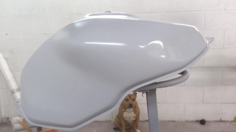

My little staff 'Bo' I had moved several times while taking photo's just before I took this one... It was until last night when I moved the photos from phone to pc that I noticed him in the background in this pic. Unless i'm taking the bike he always goes to work with me.

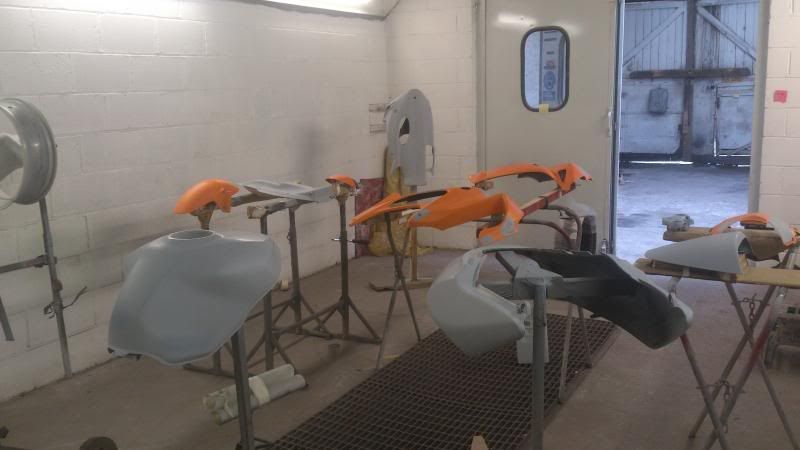

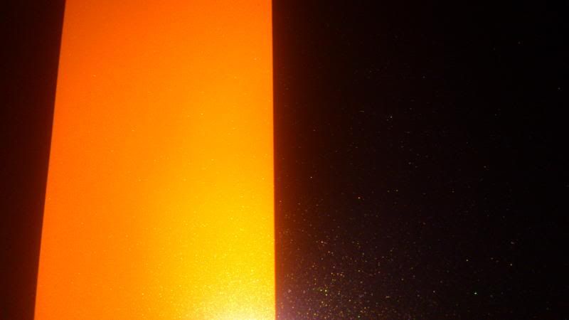

I think iv'e worked it out mate... didn't get to paint her today though.... finished prepping and then spent a bit of time knocking up some colour samples/test cards. Was a bit late in day to start painting... gonna be in the paint shop for best part of 3 hours doing this and didn't want the booth running late seeing as nice day and neighbors outside... my garage is in a residential area.

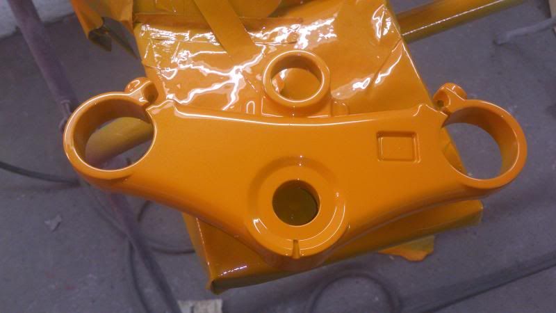

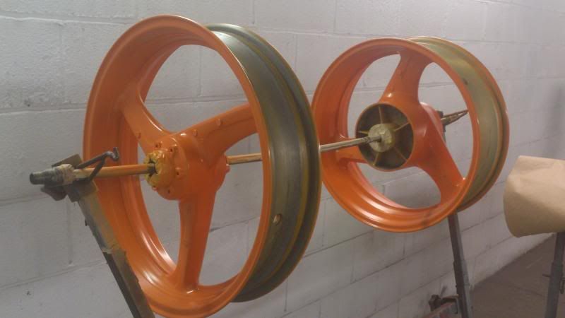

Black bike with orange front h/l panel, top yoke, number boards on both rear corners similar to below but with out a border... may do a section of the belly in orange and orange wheels.

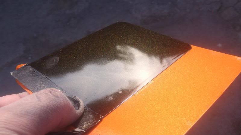

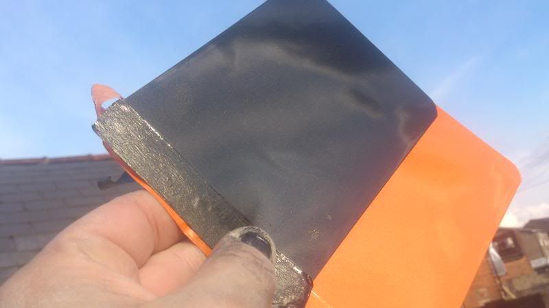

The colours... Gonna use a straight black tinter as the main colour.. the orange is kawasaki blazing orange (same orange I had before) which is a 3 coat.. base/mid/top coats

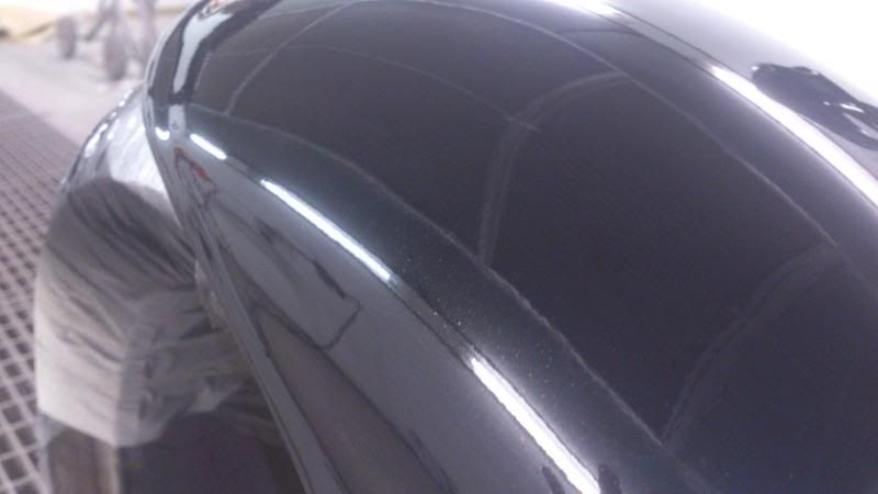

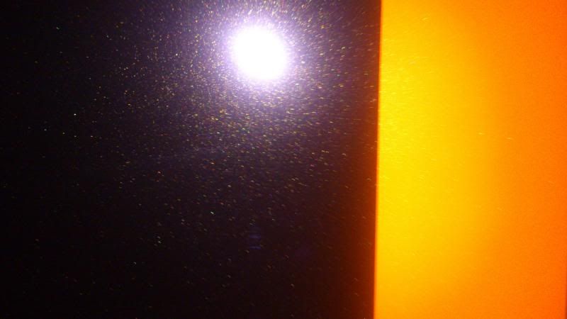

Plan is to paint black.. add the orange basecoat to areas mentioned.. then I will use the mid coat (effects coat) from the orange all over both black and orange the exception being the orange will have a few good coats of the effects coat but the black will only have one light coat... want the black to have a little something in it to make it different but at same time I want to keep the black as black as possible. Make sense? few photos below of 2 test cards i did earlier.. it was only a quick flick of paint which dried back a bit dull because I didn't bother putting heat on. The black has one good coat of mid coat on it but when i do the job I will be thinning down a bit more so the tint isn't quite as heavy. The black don't look very good in photo, hard trying to capture the effect properly on camera but seeing it stood outside in sunshine it look really nice.

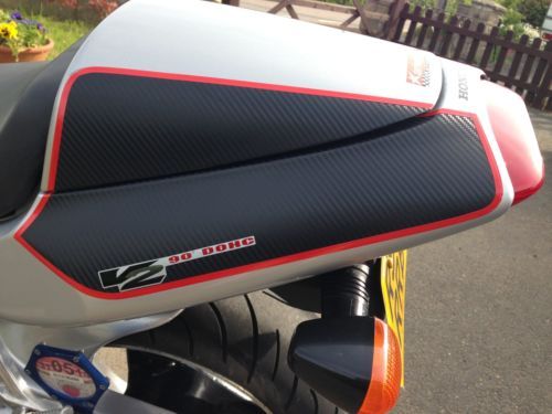

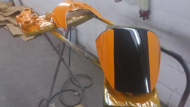

Looks very good that. The Black with some fleck in it is what I imagined. And the numerboard with t e carbon looks top notch. :thumbup:

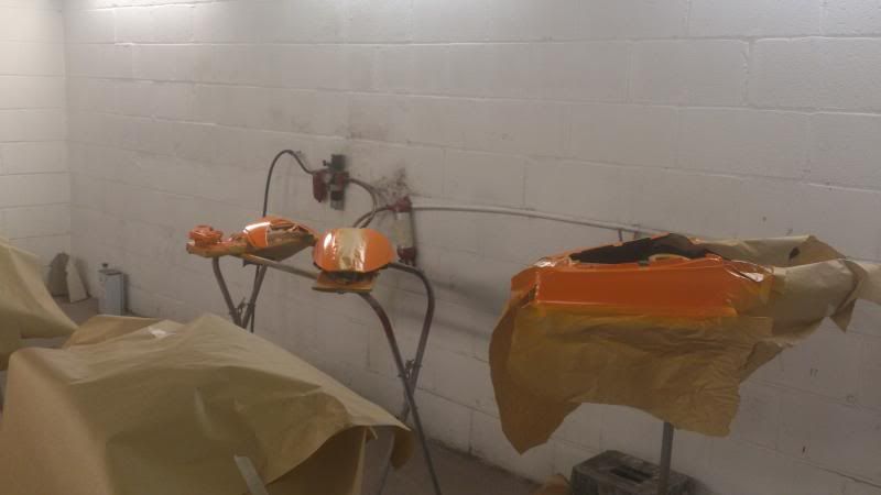

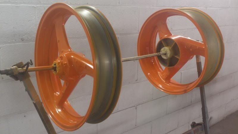

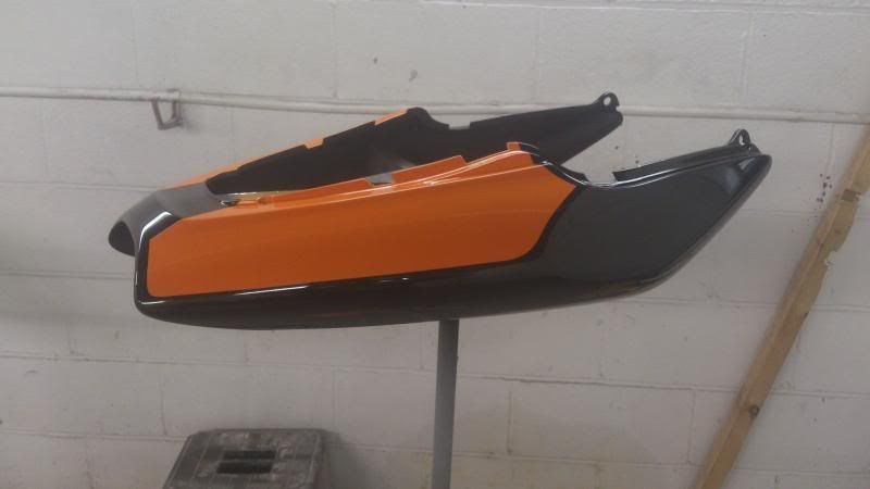

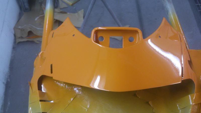

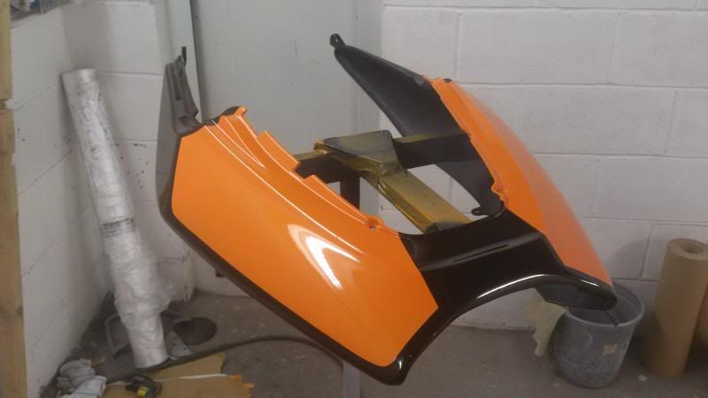

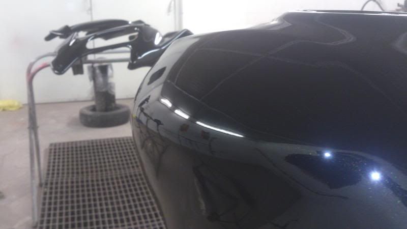

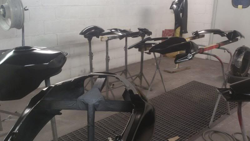

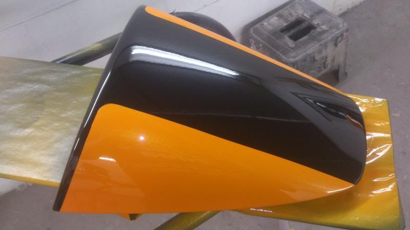

Ever woke with such a bad hangover that the thought of 'i'll never drink again' pops into the head.... well that's how I feel about painting right now. 4 different base coats, 2 mid coats plus top coat.. equivalent of a bout 12 coats of paint... 5 hours in a warm booth... knackered really does not cut it.
Anyways.... done. Roll on tomorrow and daylight so I can see if i have achieved anywhere near the effect I was after... Overall... it's not brill.. masking up for the orange corners etc was tricky... bare in mind it was a first time doing something like this. Have a couple spots where the lines are not to clever, but... like I said previously I wasn't painting a show bike and it's nothing that I can't put right in the future if I can ever be bothered.
One change of plan... didn't put any orange on the belly pan.. Really wasn't expecting the job to take so long so skipped the pan to save time which it turned out was a good thing because i ran out of orange basecoat just doing what i did... if i had of done the pan I wouldn't of been able to finish the job. Will add orange to the pan but will worry about it another time. Probably won't have any decent photo's of the panels on the bike for a while yet, painting forks tomorrow plus dropping swing arm off to polish along with rear sets and then have service and clutch to do before rebuilding. So a selection of progress pics to on with.

The black and orange works well together :thumbup:

Bloody hell its looks great already. I had big decisions! how many can to use on the forks etc :lol: I went for 7 coats of "Rustoleum hard hat Black" mind you i am happy with them. The pan was red anyway and i bought some good tape, masked it up and put it in the airing cupboard with the paint for 2 days. then sprayed 3 primers and 4 top coats for the white. Overall very happy, there a run and very slight fade on the bit underneath but it isn't bad and i do like the mix of colours. I fancy a white bit through the tank and along the front mudguard but just wanna ride it now with all the mods on through the summer.
Looking forward to seeing yours back together, I can't tell its gonna look shithot.

Keep up the good work it's looking GREAT 8)
I like the way you've done the tail section and seat hump cover thing :thumbup:
