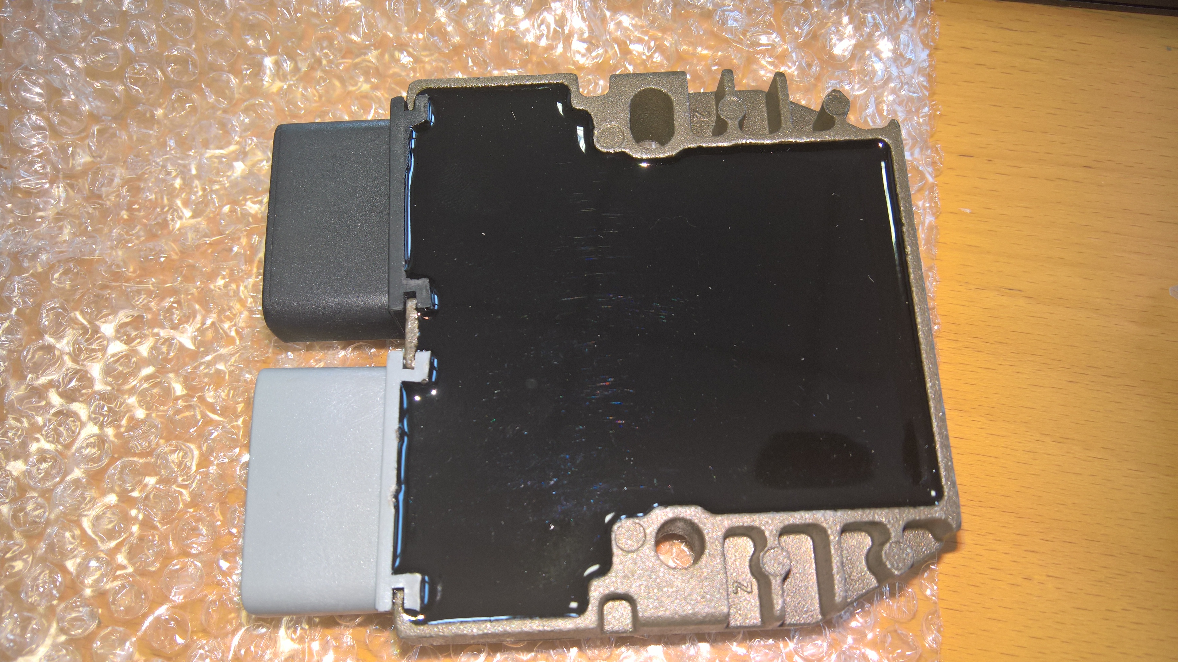

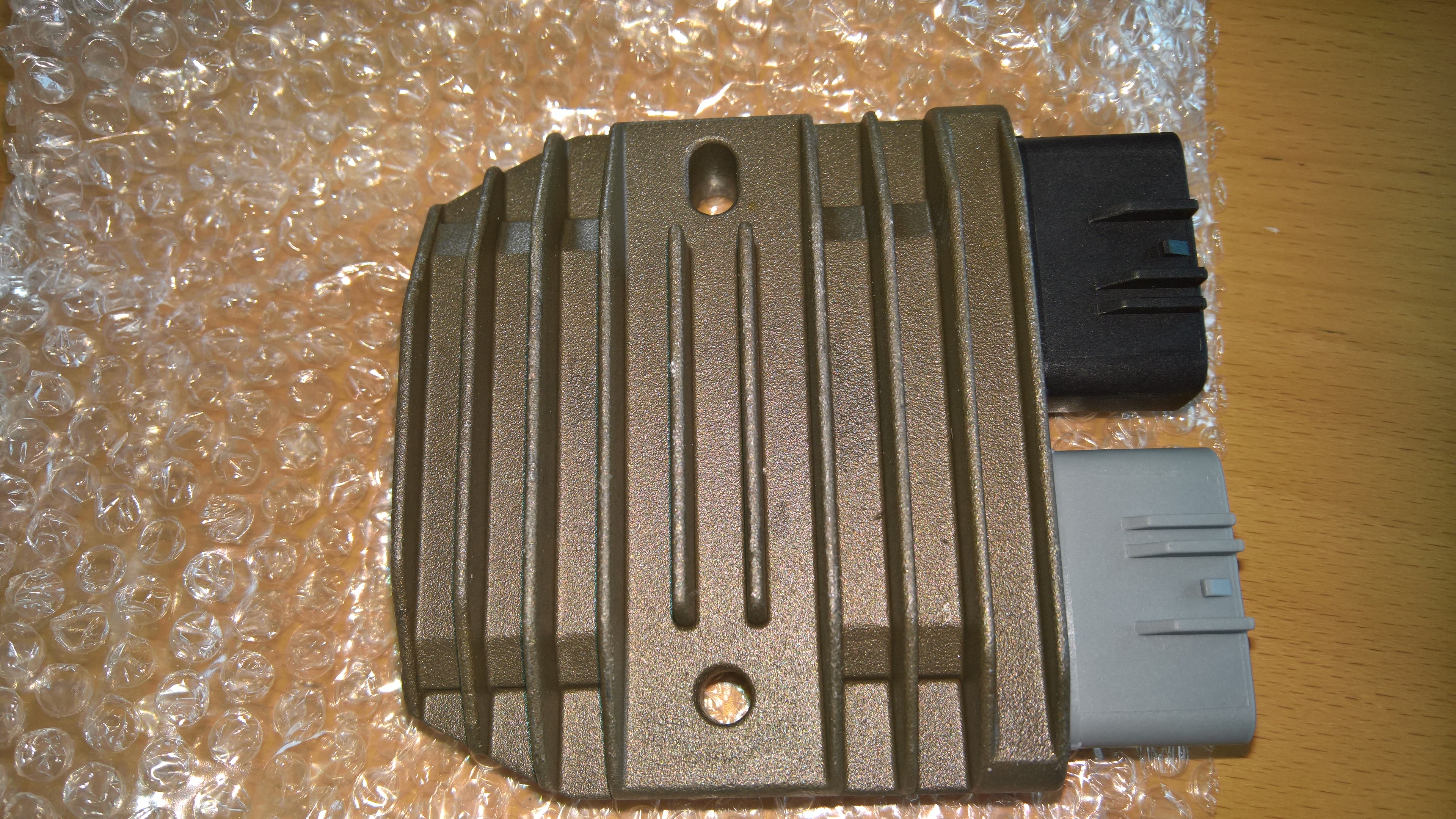

just arrived
Re: Which Reg/rectifier
fulviogsx wrote:just arrived
Ah!!!!! Wrong one!!!!! :lol:

Hi guys
Big problem
RR changed.
New RR works at 15,5 V
And it hoverheats a lot
I think its not normal

Coils are ok.may be the RR is chinese crap?

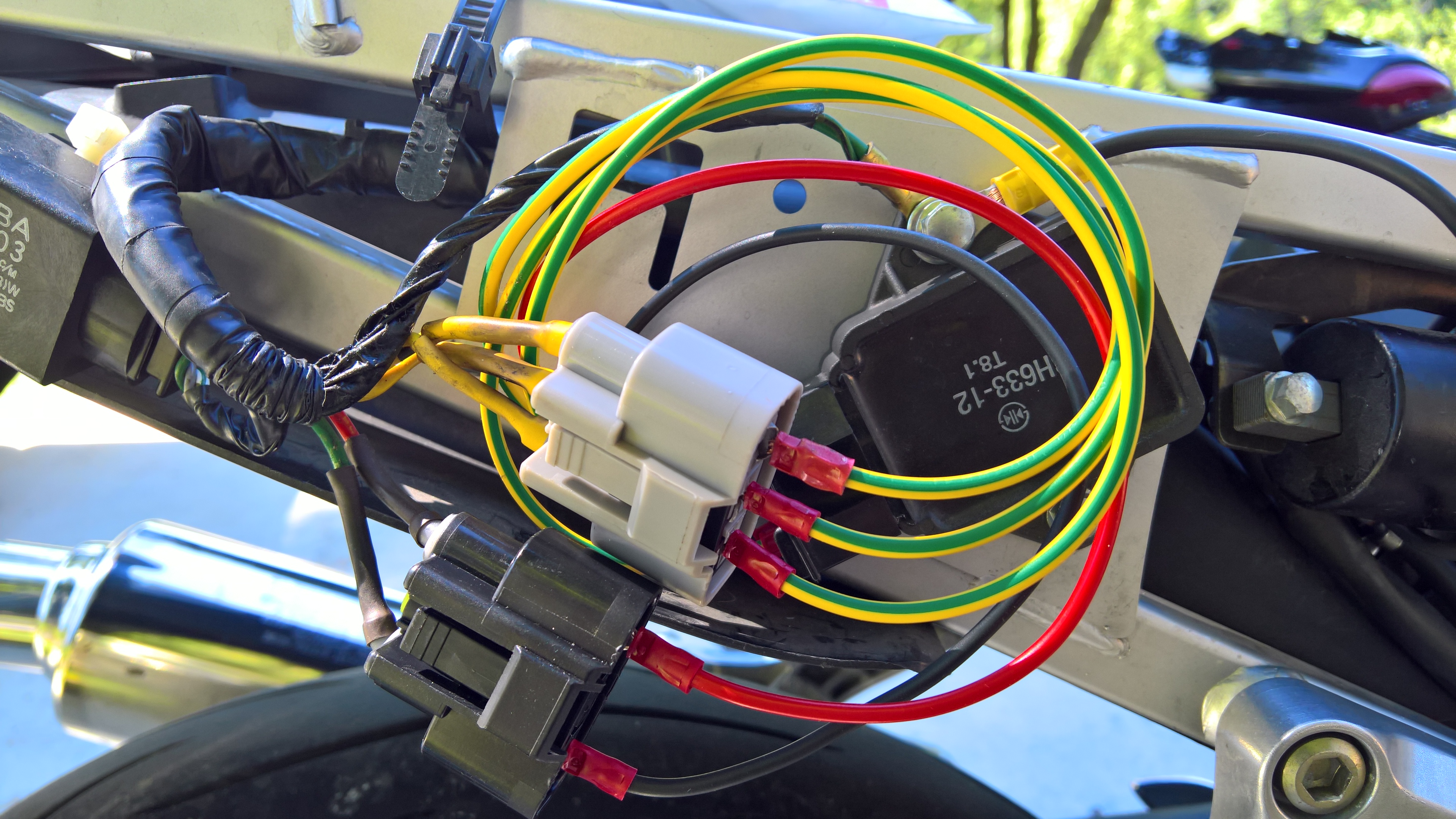

Anybody of you has a picture of how are located the wires in the original RR?.i want to reinstall it (with flying wires male/female) to make a check
Post by fulviogsx »
I re fitted the original one.14,2 V
sh1t!
